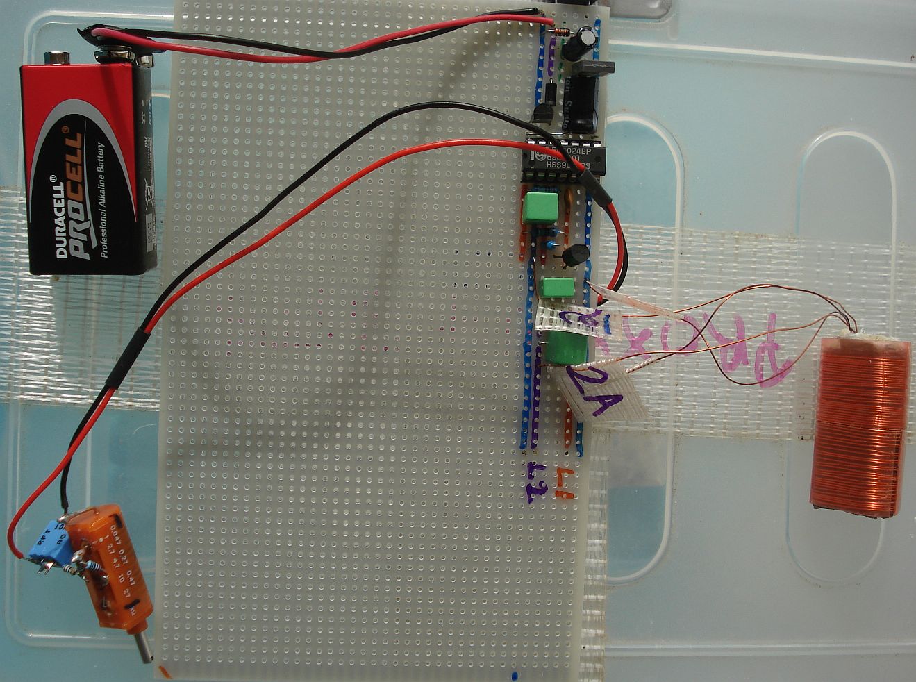

                      • I've been on an intensive working stint the last 2 1/2 months and have time again to frolic in building stuff and posting, yay.
                        I built the NUPI PP yesterday as to Nupi's excellently depicted "recipe" and it works , but .
                        I am amazed and impressed at the pinpointing distance but have an audibly annoying constant tone at around 4.8kHz.
                        How do I get rid of that?
                        Also, when my hand approaches the multiturn pot for adjustment the beeping frequency already changes!?????
                        This also happens when I touch the battery. What can I do about this?
                        Finally, when a metal object gets closer than 1 1/2 inches to the ferrite bundle (after beeping rapidly) the annoying whine at 4.8kHz AND the beeping is gone. Silence.
                        Taking the metal object away again, it returns to "normal" again. What does this mean or is some thing wrong?
                        Hoping for enlightening insights ... Have a nice day or night ... Polymer

                          Hi, Polymer.
                          It looks like an "earth" problem.
                          I try small circuits as Nupi pp out on a breadboard or solder it as a
                          dead bug styl. If everything works well, I solder it on a board.
                          This is for me the quickest and easiest way to experiment with circuits.
                          Also useful to detect errors.
                          Regards nupi.

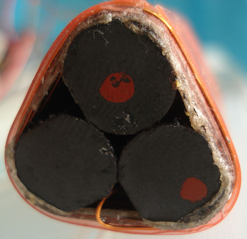

                          • Thanks for your reply nupi.
                            I don't get what you mean with "earth" problem.
                            Anyway, here is a photo of my setup on a strip-board and the coil.
                            Perhaps you can tell me more after seeing it.
                            With kind regards, Polymer

                            • Hi Polymer,
                              sorry for the "earth", I mean the "ground".
                              It may be that you have a bad ground contakt.
                              It is hard for me to check the circuit from the picture.
                              You have to put closer together the windings of the coil.
                              Have you checked the voltages according to the schematic?
                              regards, nupi
                              • Nupi, thank you - The ground/earth problem is solved.
                                I made a new stripboard layout with different grounding geometry and
                                the problem of "sensitive to touch" is now gone.
                                Still have the horrible 4.8kHz whine in the speaker though ...
                                regards Polymer
