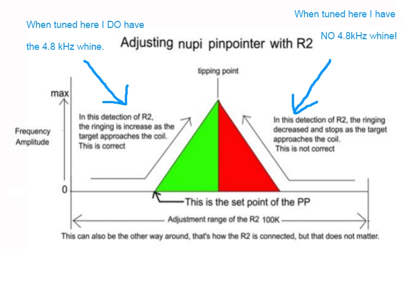

    • Thank you for your reply Nupi,
      I have tried three different 4024 chips in the socket. Same results!
      I measured the resistance of my trimpot just before beeping starts to see if the chips are different, just to see.
      The tolerances amazed me, maximum at round 15% from bottom. Here they are:
      MC14024BCP @69.1 kOhm
      HCF4024BE @71.9 kOhm
      HEF4024BP @62.5 kOhm
      Another thing I observed is that the 4.8kHz whine is only on the green side of the tuning triangle.
      Please see the picture.

      • I have some tests done with the settings of the PP to mimic the problem.
        It was harder than I thought. But just for the moment I wanted to edit the PP with a hammer, happened.
        The horrible ??kHz whine in the speaker was there.
        It is a wrong setpoint.The wrong setting is difficult to achieve, but you and me succeeded.
        You have tuned exactly on the "tipping point". (4k8_whine.jpg)
        Possible Solution: R1 and R2 pull out. Put a normal potentiometer instead. ( 100k.....220k)
        and set the PP at the right point. Then you can always put a 1k potentiometer between for fine tuning.
        A tip: you can from the point, L2, C1, R1 to the IC point 2-3-4-5-6-7-9-11 or 12 conect with in between a 1n capacitor.
        This gives different detection tones and stability !!!
        Worth to try it out.
        Regards, nupi.
        • HEEEY NUPI !!!! ..... It works now
          I actually should be packing for travelling now, but I just couldn't wait to try this and I feel much better now!
          My hammer has been saved a beating
          The good adjustment point is at 106 kOhm - just out of reach of the 100k and 1k fine poti I had
          No more whining! When turning the poti it seems as if I have two triangles as in the picture aka four possibilities of "tuning" points!?

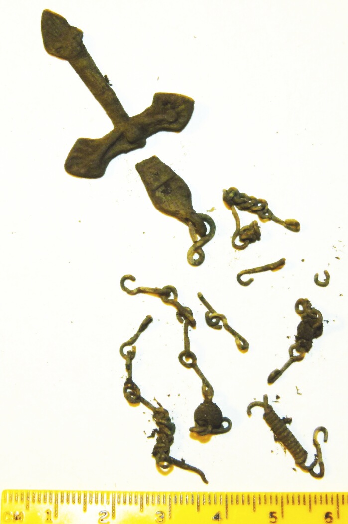

            • A few days ago I found a thin chain with the DeepHunter and 45cm coil,
              but only because of the broken cross.
              First I only detected the "big" part of it, next the smaller piece and
              later I had a very hard time to detect the very thin chain parts with
              the modded Garrett Propointer, adjusted to absolute critical sensitivity.
              For testing if the pinpointer really is able to detect such stuff,
              bending some thin and very short wire-pieces, hooking them
              together and mix this stuff with earth will work pretty good.
