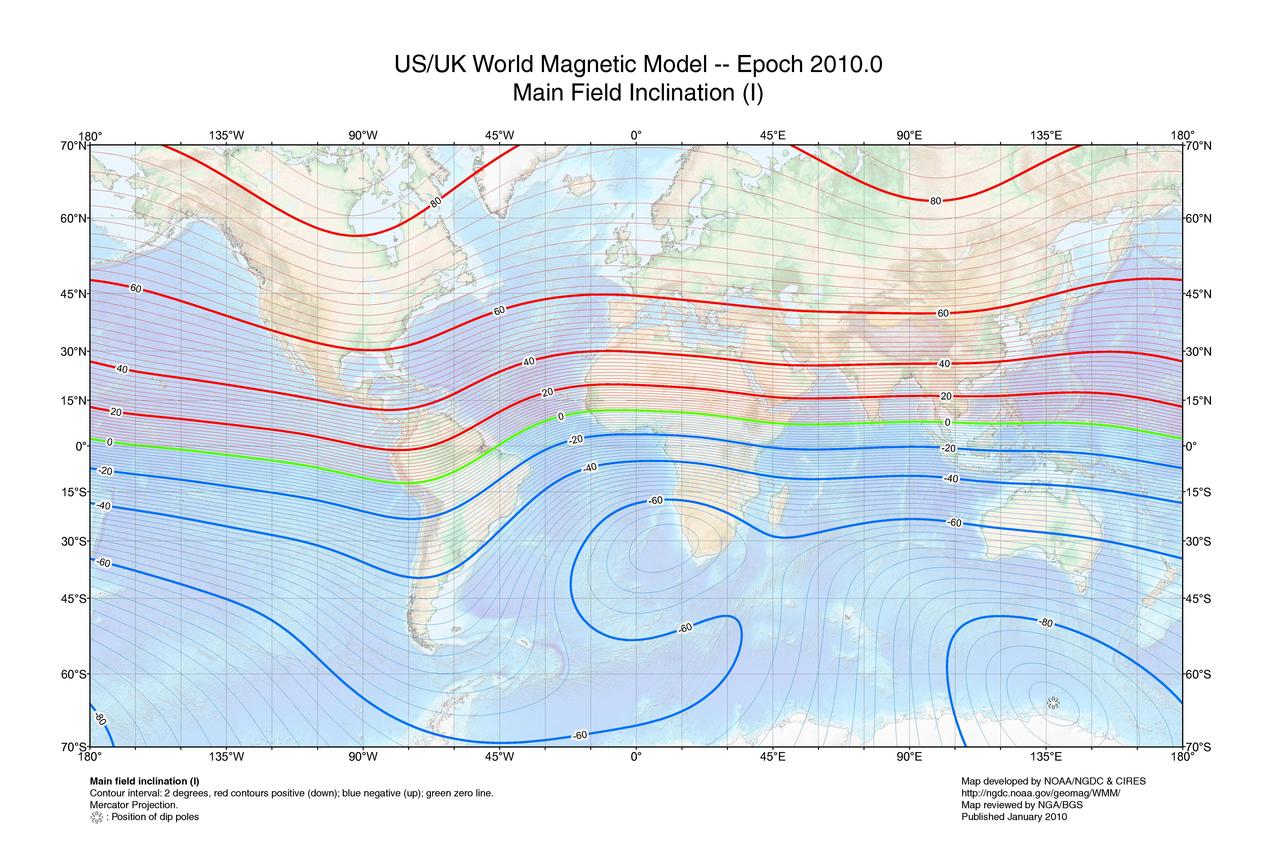

      Nupi, I found that sensitivity of the pinpointer is also dependent of the DIRECTION the pinpointer is facing.
      I first thought it was something in my house, but it is also at the beach.
      When facing SOUTH and the SKY at around 45° it beeps the fastest.
      When facing NORTH and the SKY at aroung 45° it beeps the slowest.
      Could it be that the ferrite core is biased through the earths magnetic field?
      Have you experienced this with the Nupi Pinpointer?
      Just adjust to the sensitive point when its facing north and test it facing south.

          Hi Polymer.
          "Could it be that the ferrite core is biased through the earths magnetic field?
          Have you experienced this with the Nupi Pinpointer?"
          Yes I have.
          You're right, that's because the earth magnetich field lines.
          You're a good observer Polymer.
          This phenomenon can also be had with the older TVs.
          I thought that a TV, for instance Europe, not just in Mexico could use for their difference in earths magnetic field.
          You got color dispersion on the the screen image. (The earths magnetic field are not the same everywhere on the earth).
          I'm sure there are more people on Geotech that can tell you more about this phenomenon.
          The influence of the earths magnetic field, on a IB - metal detector in connection
          with mineralized ground is also of great importance for the detection depth.
          But you should see this as a gift from Nupi.
          You have not only a good PP but a compass to.
          regards nupi.

                Hello Nupi,
                Yessssss ... You get one compass AND inclination meter with every Nupi PP absolutely free
                Thank you for your feedback. I remember the tv colors being funny for a while when we moved continents.
                That was an old style CRT one. An interesting topic that has me excited somehow. Here's a nice map:

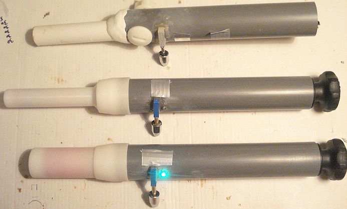

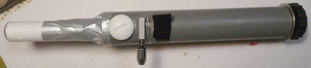

                I have built a quick & dirty Nupi PP housing for real field testing, here pic:
                I used it on a rocky beach with clay and some sand leftovers to go into holes and cracks.
                I did have to adjust often dependent upon ground matrix and direction pointed. It was in
                use for around 7 hours. Yes, my muscles were hurting after this day ...
                The luxury of being able to detect deep with the pinpointer far outweighs the extra work of re-adjusting for me.
                It became a reflex after a few hours. In the terrain I was in, even a 6x4 inch coil seems HUGE and hard to use.
                So I am really happy with it and am now constructing proper housings for the coil and electronics.

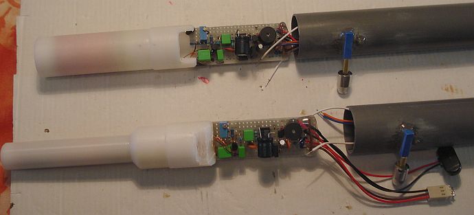

                    I have made a new experience making two new circuits for two final PP's.
                    The circuits work fine but there is something which really had me puzzled
                    and I changed all components and put in decoupling caps to see what it was.
                    It did not help. May it be the geometry of my new PCB's ??? The components
                    are the same as in the ones that sound great from the beginning.
                    Problem: when beeping it sounded not as good as the other circuits I built.
                    When touching the insulated + wire to the beeper-speaker the sound was
                    nice and harmonic again. When touching the insulated minus wire to the
                    beeper-speaker the sound gets really horrible and scratchy.
                    The solution I found was simple, but I do not understand it
                    It is just a small capacitor (1n8 ) between the +- beeper-speaker connection.
                    I will post photos, yes. The housings are ready and I am waiting for the 1k multiturn potis and 9v
                    battery connectors to arrive to complete them.
                    Have a great week and looking forward to hearing from you again,
                    Best Regards, Polymer

                          Thank You for your reply, I did look at the videos a while back.
                          My vibration motors do the same as in the film.
                          It is not enough vibration to be really felt for me when slow beeping.
                          It doesn't matter though, I am very happy with sound and light.
                          I have now completed two Nupi pinpointers, one with three ferrites and a thin one.
                          Here are some pictures. I have not put much effort into "professional look", I made
                          them solid and switchable sound/light or both. The probe tips are made of polyamide.
                          The pinpointer at the top of the pic is my experimental one for field testing to see
                          if it is good for my needs. Hell yes it is! That's why I now made two proper ones.
                          Yes, the geometry of the electronics in the NUPI PP are important and surprising!
                          What a lot of fun, frustration and learning with this project
                          Thank You NUPI!
                          Best Wishes, Polymer
