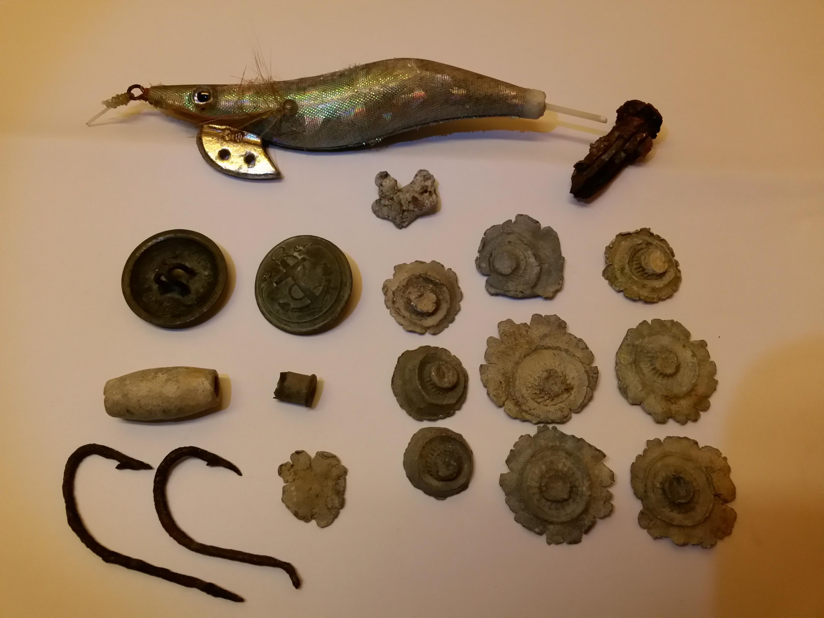

                  isle of pines, new caledonia. i dont have small findings. it was very nice.
                    [ATTACH]33011[/ATTACH]
                    Nice to see your type of finds.
                    What are are those nine flat-ish lead looking things ???
                    • lead bullet... not sure
                      • Hi ionut_mtb
                        they look like lead projectiles,
                        I was on Isle of pines twice last Sept / Nov last year 2014
                        beautiful place, would loved to have had a MD with me.
                        • i'm working on cruise ship(carnival legend). i i've been almost everywhere, but isle of pines... amazing!
                          • Hi ionut_mtb
                            Great job you have, very hard work if you are crew, I was there on Pacific Jewel and Pearl, NEXT time I'll pack at least the pinpointer, and have a bit of a look on the beaches which are amazing to swim at.
                            • yes is very hard, i have 5 months contract far from family and friends. i will try to make nupi for diving, i have few ideas and i will share after i will make. one for diving and one normal, for helping the big metal detector. i made surf pi pro, is very nice, stil have some issues wich i will put on the right area of the forum, but i'm glad is working. (resonable) i want to buy a comercial MD so i can register in my country. home made MD cannot... i need invoice for register. i was thinking for teknetics eurotek pro DD11inch since i'm beginer in this hobby.
