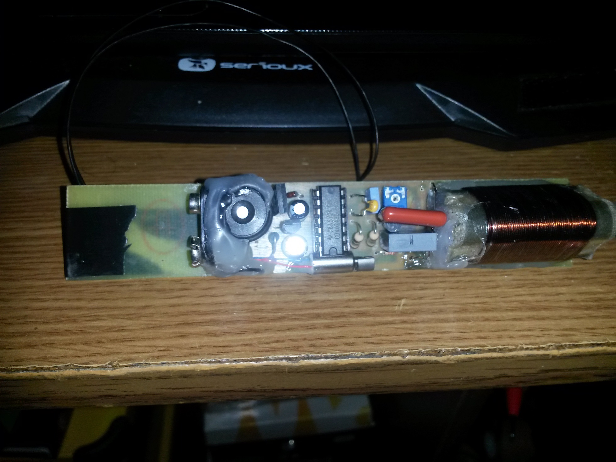

                      • hello 6666, hello guys.
                        yes i made the pinpointer, i found a picture in my comp, attached, Click image for larger version
                        I also insert this inside a pvc tube and one potentiometer (500ohm- for sensitivity) with knob outside where battery is. I had same problem with temperature, unstability when touching the cold ground/mud, needed adjustment. Two outside pot's is good solution. After i brought deus and did not make any other projects, it's easy to pinpoint, just dragging the coil over the target and see where the signal stop. and the target is in front of the coil.
                        I would like to try malish fm2, as does not need external adjustments. more stability but not so sensitive like nupi.
                        regards!
                        • Hi ionut_mtb,
                          I like the compact build of your nupi PP!
                          I received my hollow ferrites and will be playing around with those.
                          I have extensively used my Nupi PP in temperatures from 0°C to 25°C in the meantime.
                          A great help for me finding good stuff!
                          Everytime the sun comes out between clouds, I have to re-adjust & vice-versa.
                          I am using external 1k & 50k multiturn pots at the moment.
                          I do get great distances on a nickel & gold ring (14-16cm) on my test bench, but it is not very stable.
                          I'm looking into how to deal with or counter the extreme temperature drift I have and find the main causes (Coil, ferrite, capacitors, transistor).
                          @NUPI: can you offer some insights into this?
                          I tried to understand how this oscillator works. It seems like a Hartley but not exactly , so I am over my head here ... any explanations?
                          Thank You, have a great day!
