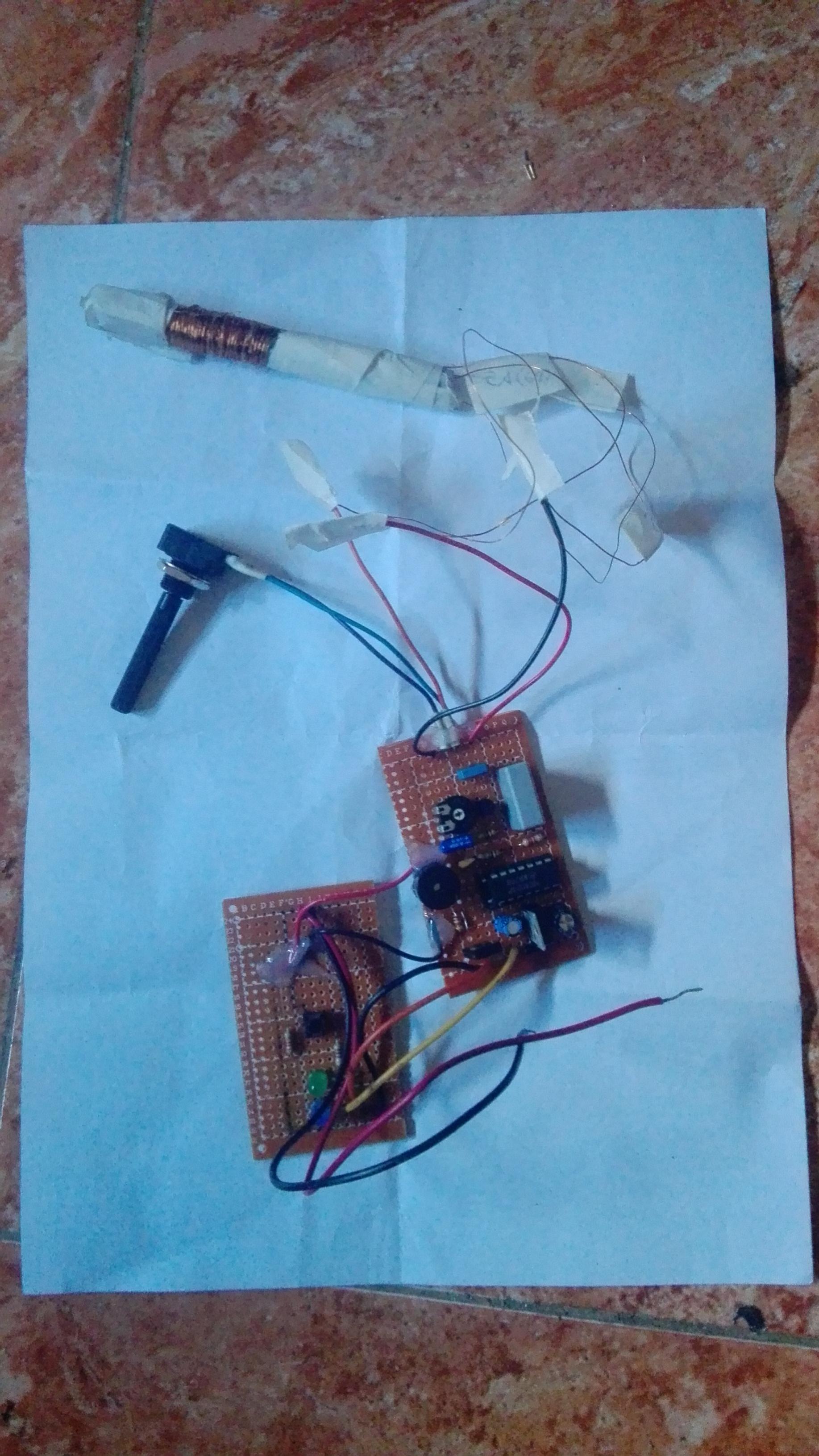

    I give up. Two years ago I tried to make pp and it did not work. Now I have repeated the circuit in a perforated plate connecting everything as shown in the diagram and it does not work either. The only difference is c1 is mkt, I can not find it in mkp. Even if c1 mkt pp should give some signal? My pp is totally silent.
    Just tried a 2.5% 1500pF Wima 100V capacitor for C1 which I found in my junk box. It works! It is red with a yellow filling, I don't know if it's MKP or MKP2 or ???

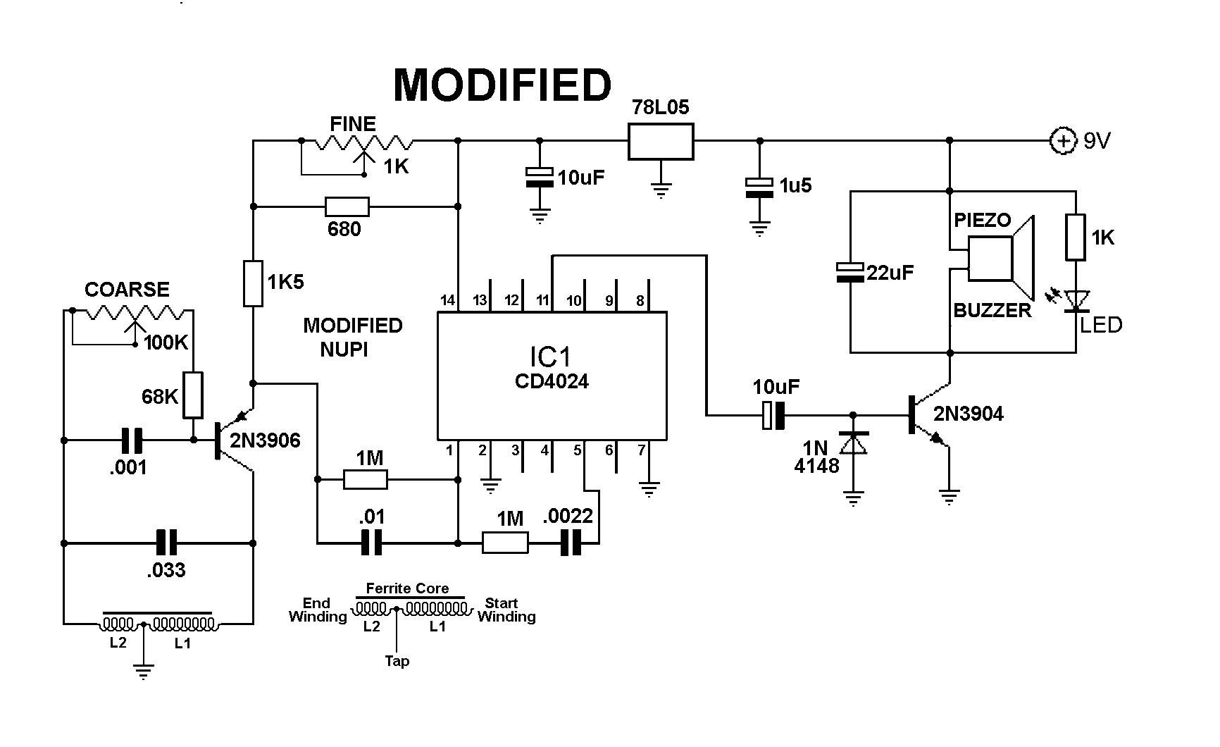

    • I just used Polyester Caps.
      And a Slightly Modified Circuit, Works Good.
      (My Ferrite Rod is just a 1.5 inch Long and 1/4 inch Diameter.)

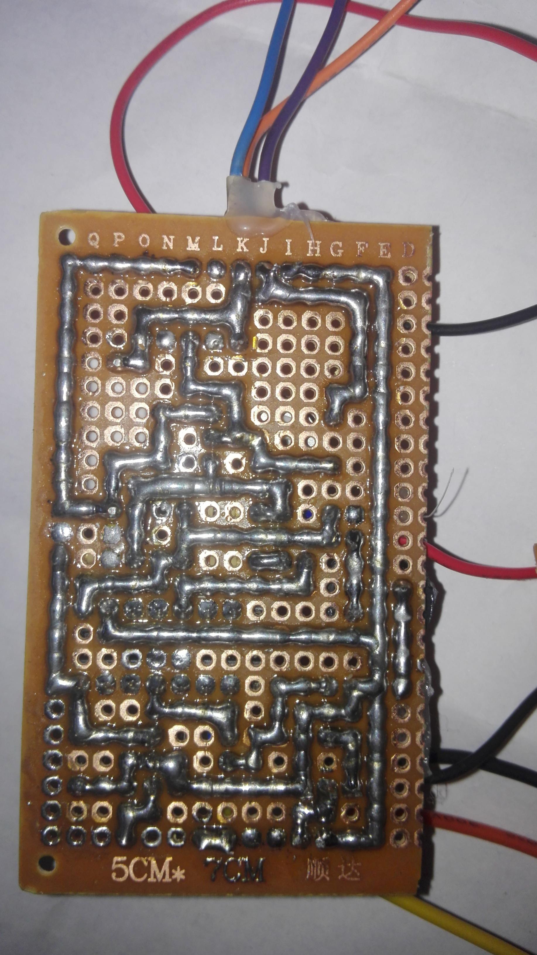

        Thank you.
        It is the second time and this time I have taken special care in everything. I have remarked normal nupi with bc560 and bd139 fixing me to place them correctly, without motor.
        I also checked the track with multimeter and everything ok.
        I will change the two potentiometers to 100k and I will buy the capacitor 1500pf mkp 1500v (22 mm). Then I will comment if it works.

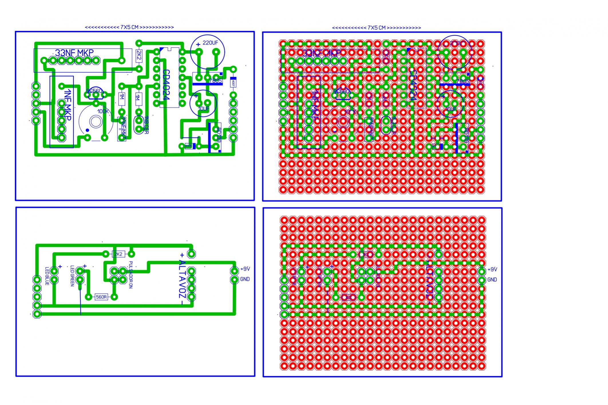

        • I want to show a photo I'm not home for two days. If I have in my phone a capture of the tracks created, I have mounted the circuit.

                      Nice re-design Chemelec! I assume your bias design is more robust (temperature wise) than the NUPI one.
                      If so, please post a schematic.
                      I can't test circuits quickly on a breadboard, because I live in a humid & salty environment causing lots of contact problems, so I have to solder everything.
                        Just saw your coil. Like Chemelec & others say: take your time winding the coil really well. I use double-sided sticky tape layers to make this easier.
                          Not Sure it is more Robust, But it works for me.
                          Mainly it gives a fairly fine Tuning Without the need for a Multi-turn Pot.
                          My Ferrite Rod is Embedded in a 1/2 inch Diameter ABS Rod, than Lathed with a Groove where the Coil is to be wound.
                          And I Wind all my coils on my Metal Lathe, at Quite High Speeds.
                          My Modified Schematic:
                          Depending on the Coil Winding, the 68K Resistor Might Need to be a Higher Value.

                            Thank You so much Chemelec. I will be trying this soon.
                            Your circuit may open the possibilitiy of using NTC/PTC for partial 'automatic' temperature compensation.
                            It's great you have a lathe. I hand-wind these things. Talk about ZEN meditation.

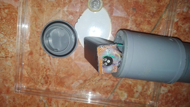

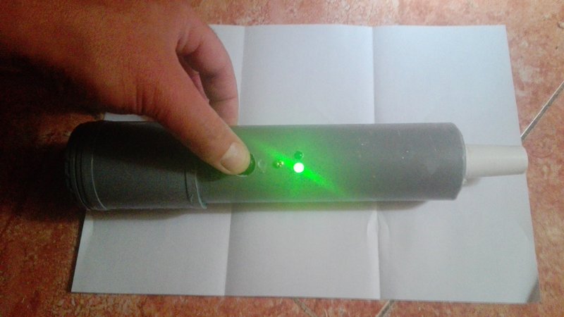

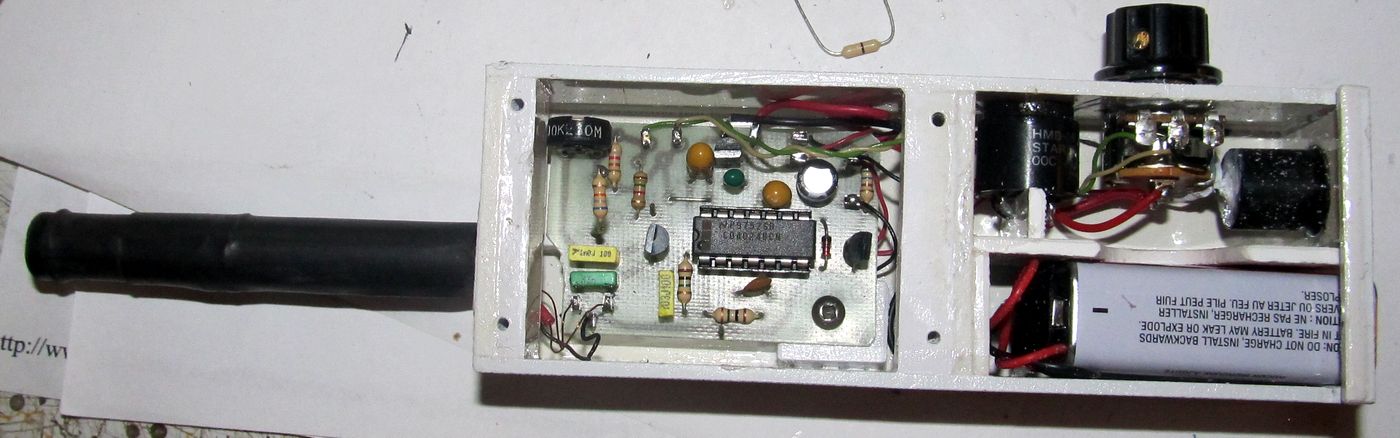

                              • I have managed to make it work. Replaced adjustable resistance of 1k for 100k and also I have changed cd4024 for the new one and now it works. The worse thing is the big size, in the future I am going to make other one small.
                                https://www.youtube.com/watch?v=OO_Dyu_5lew
                                Thank you
