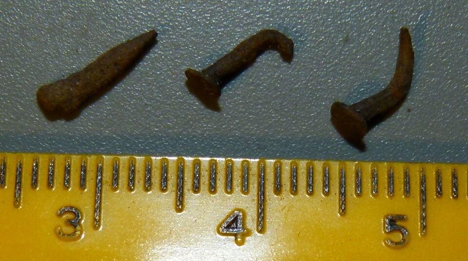

        • Some news from the real metal-detecting world!
          btw. a thin chain is huge compared to this here:
          which I found with the Makro Racer with 28cm coil plus modified Garrett Pro Pointer.
          Its a record - the smallest handmade nails I have ever found so far!
          Besides: Everything detected by vibration - size ca. 7mm.
          Without modified pinpointer - no chance!
          I had spread just a little bit of the soil super flat over my hand and
          it took me over 30 seconds to find out with the PP where the metallic thing is hidden.

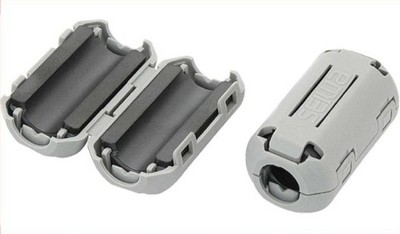

              Have you thought over the coil on the core of the filter? Such as the picture.
              Robilem pinpointer minimax2 with such a coil. The lines were very similar to the dedicated coil.

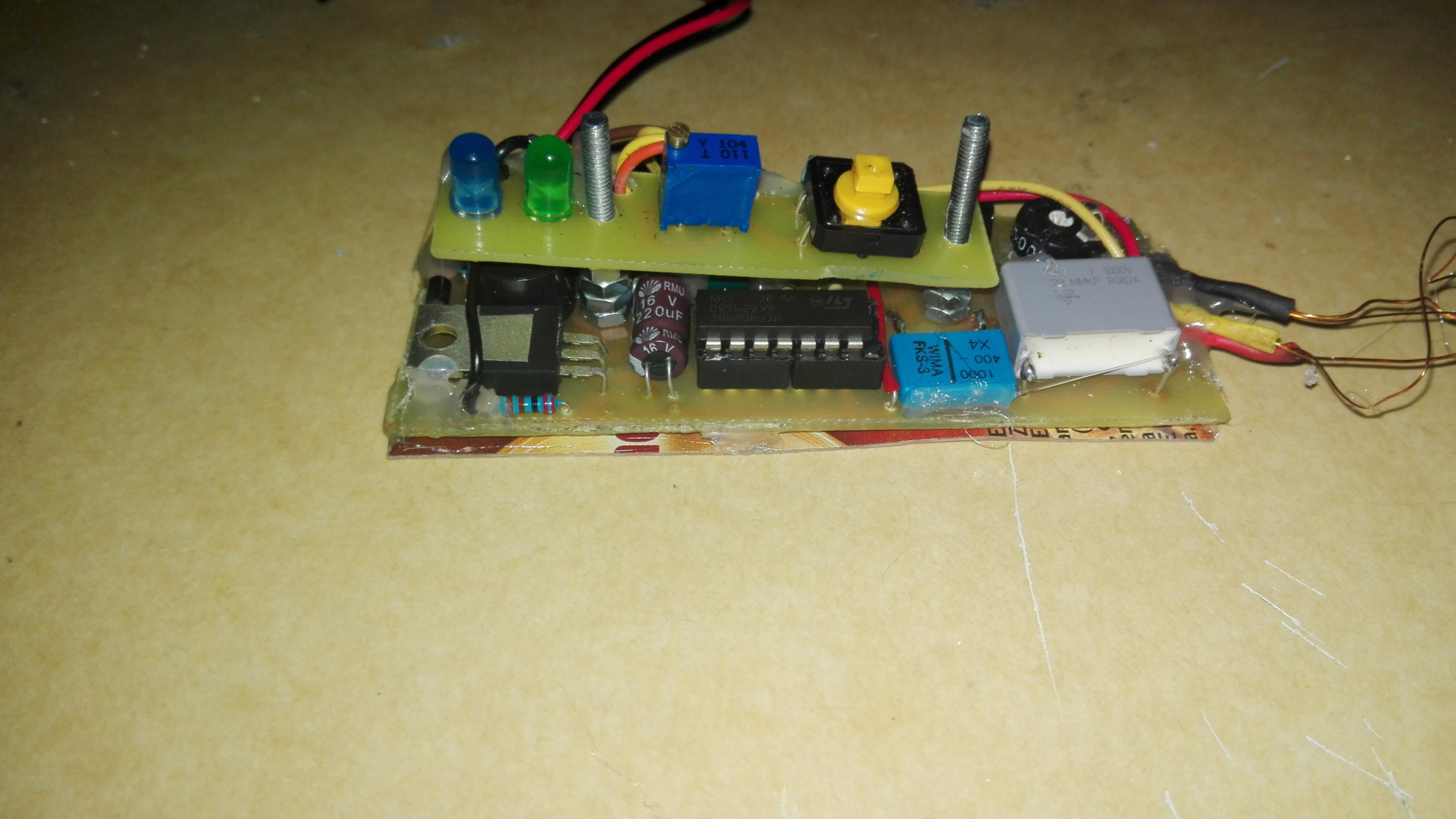

              • Originally posted by Virdi_248 View Post
                I have managed to make it work. Replaced adjustable resistance of 1k for 100k and also I have changed cd4024 for the new one and now it works. The worse thing is the big size, in the future I am going to make other one small.
                [ATTACH]39934[/ATTACH]
                [ATTACH]39935[/ATTACH]
                https://www.youtube.com/watch?v=OO_Dyu_5lew
                Thank you

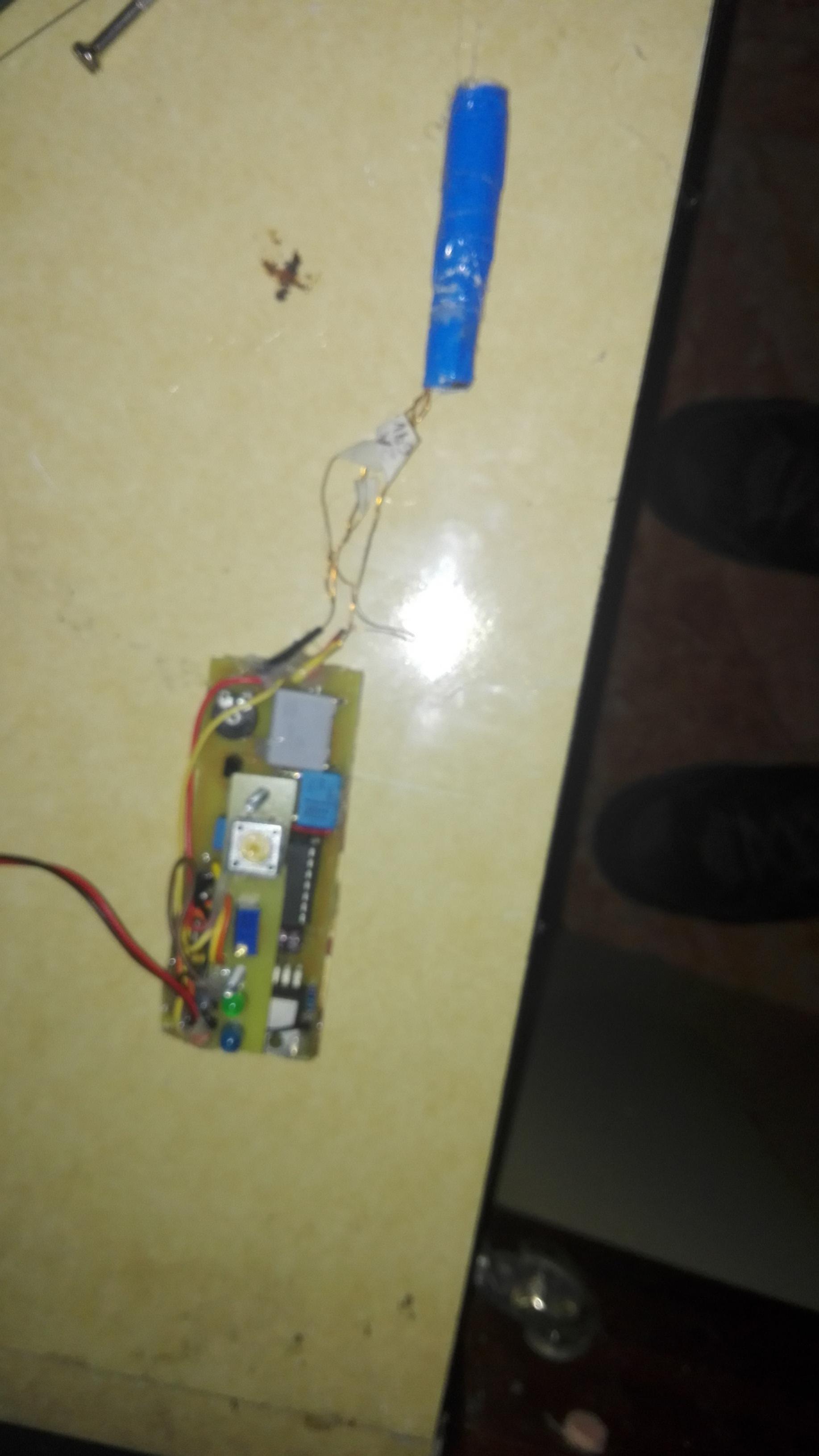

                I have fulfilled another small pinpointer mas with my pcb sprint layout. I have proved it in rich land in very bad salt for detectors.
                The result has been excellent, alone two times the pinpointer fits in four hours.
                With the permission of the creator of the thread I put my pcb, the information of my own bobbin and some photo and video. In the video the pinpointer not this one in his maxim sensibility. I sit it for translation of the language.
                Chip used
                HCF4024
                Thanks to all who helped me.

                • My nupi finally works I could not find a mistake for a long time. The contact board power supply was defective. The power supply voltage was very unstable. On the new power supply the nupi started working immediately. Coil on ferrite from the filter. Wire anyhow. Inductance L1 1.65mH and L2 did not even measure.
                  The coin is 1 Polish penny (15.3 mm brass).
                  If the coin is at the same coil - the nupi lose their voice. It looks like the signal was too big. So it has to be? Do you try to regulate?
                  https://youtu.be/FkTlnD6m8Oc

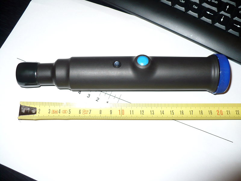

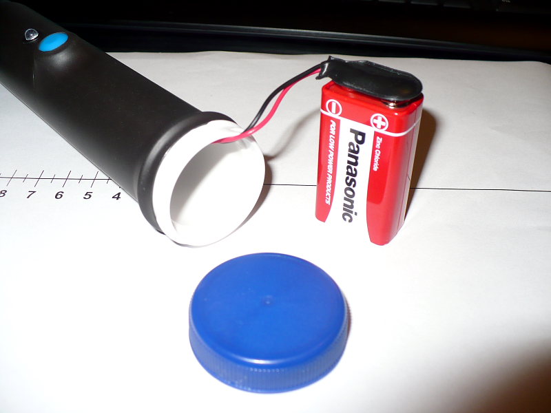

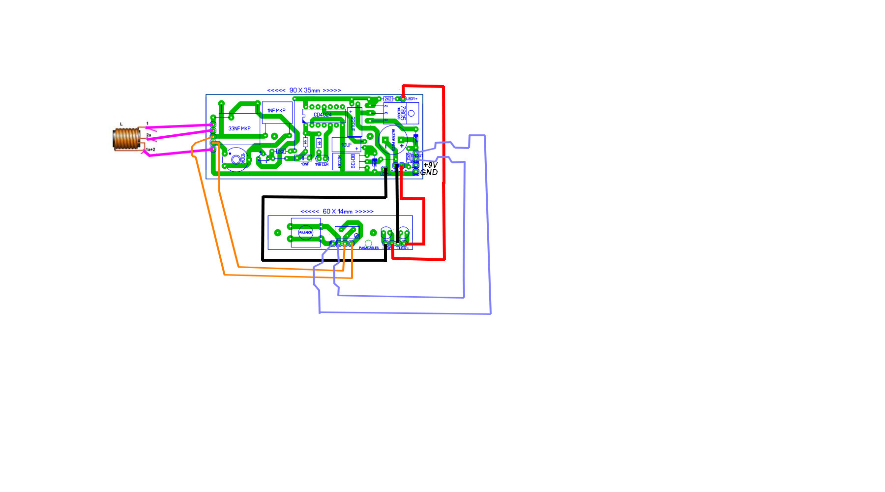

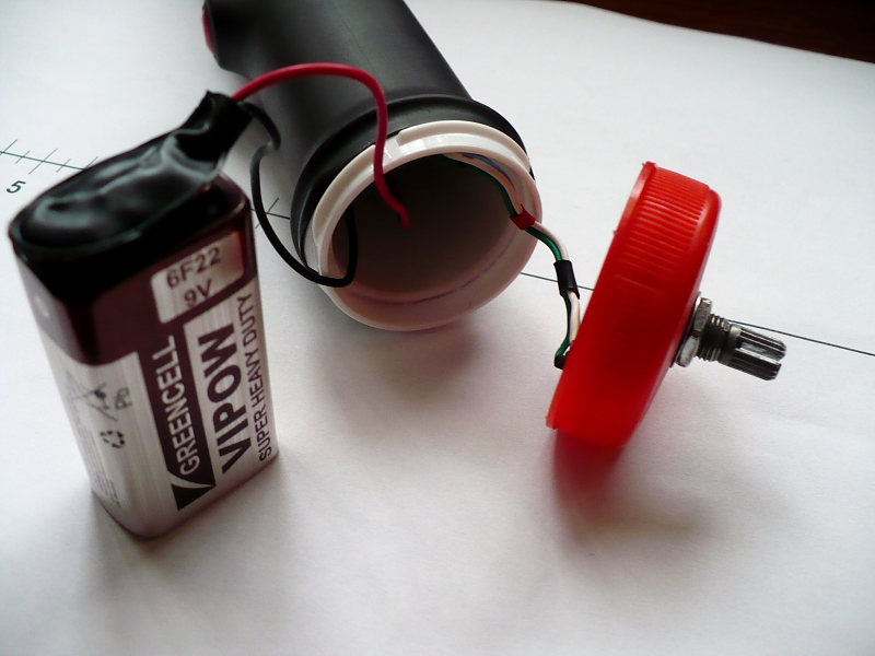

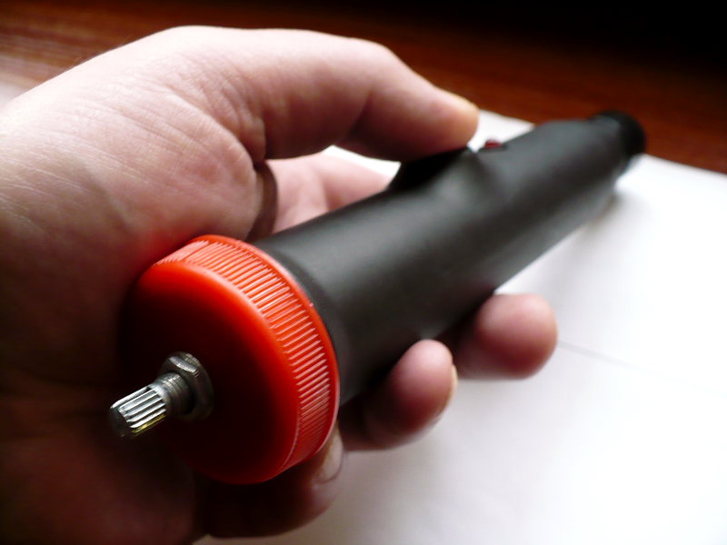

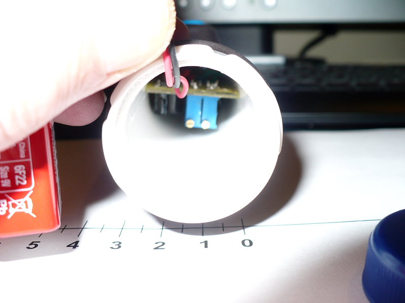

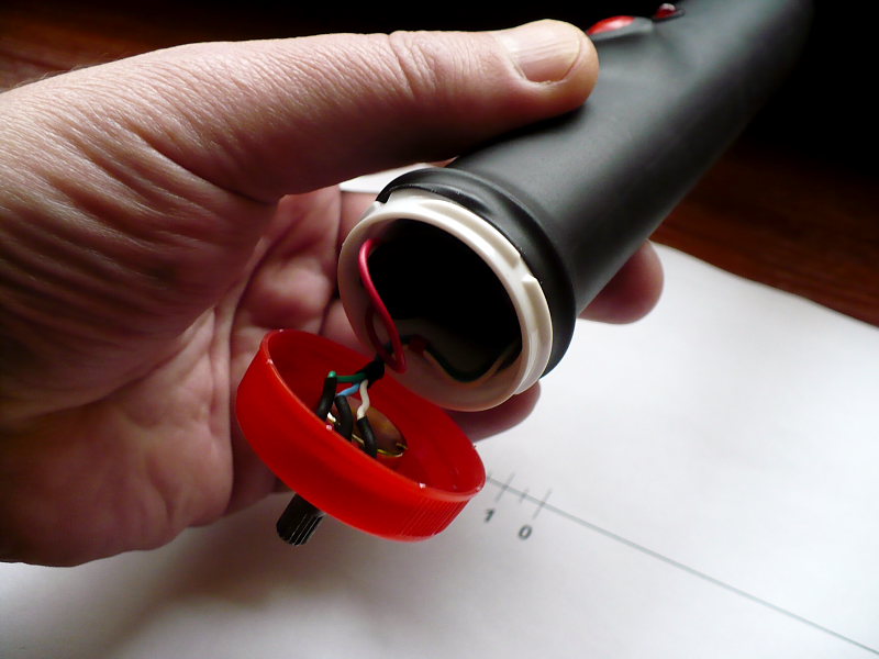

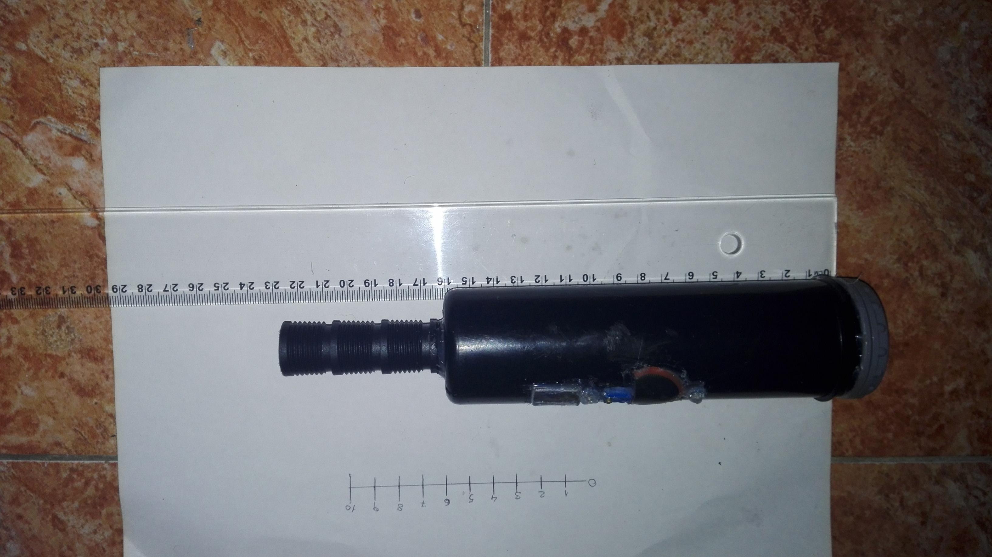

                      • hi
                        My NUPI project is over. The pinpointer works. Electronics is already packed into the housing (32x210mm). Now only field tests. At home, the pinpointer is very stable.
                        Finally, the coil is wound on ferrite 9x60mm. Sensitivity adjustment (R1 and R2) on pcb but with access after removing the battery.
                        Now it's time for Nupi mod by chemelec (# 597)

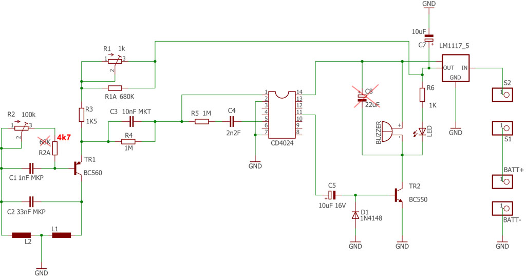

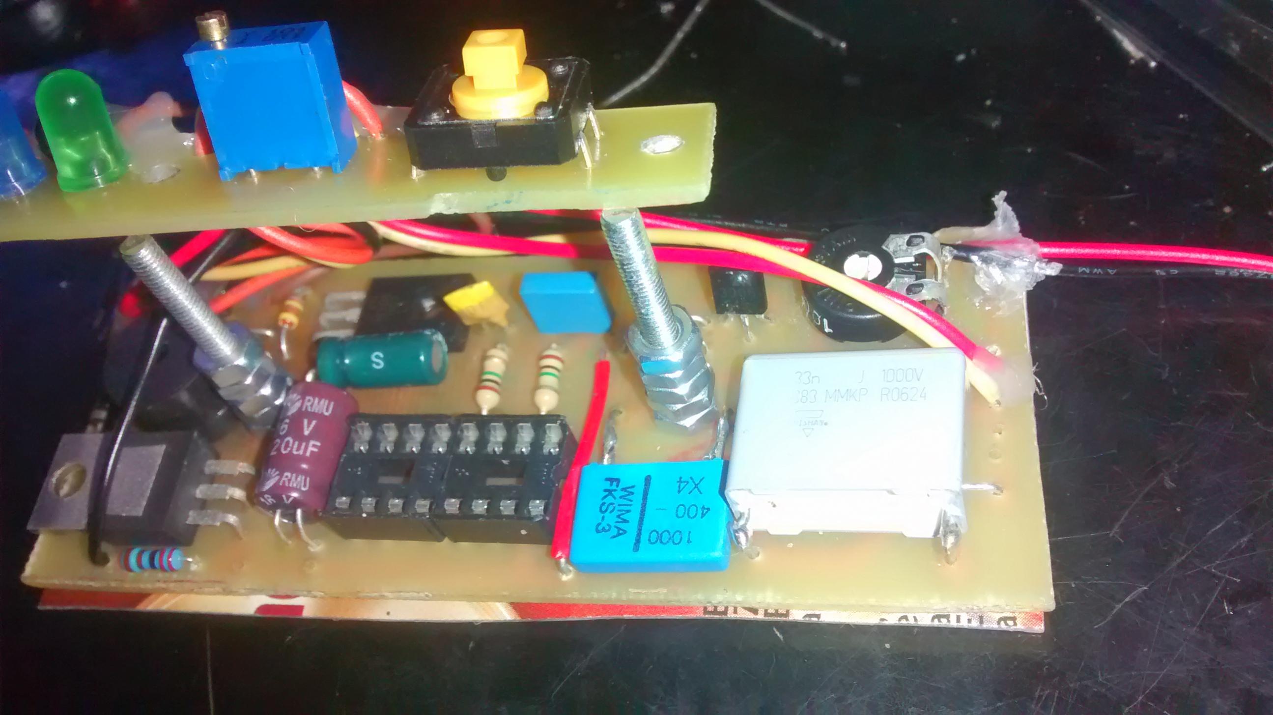

                              • Nupi mod by chemelec woks
                                I changed R2A 68k to 4k7 - my coil is 0.5mm wire and has lower resistances. C8 I threw out because the sound was strange -> https://youtu.be/DZ42f5ohKLA. Buzzer and led are powered by stabilizer LM1117 sot-223 and not directly from 9V. R2 is on pcb, R1 is available externally.
