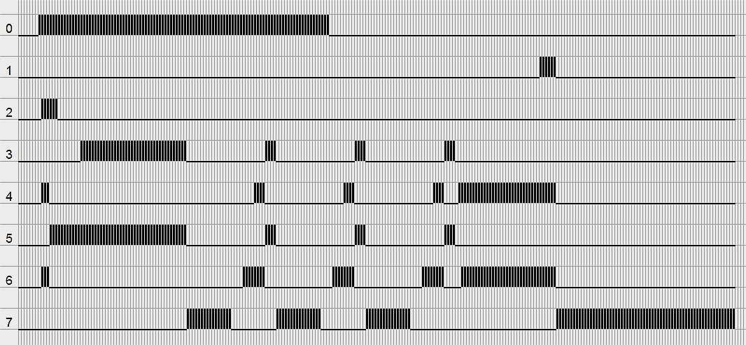

      Here's the 2100 standard timing (Thankyou Mario et al.) that's located at the first page of the PROM. The sequence is 255 segments wide and if the long pulse is 240us, each segment is 3.75us.
      I think trace 3 is the TX, 5 and 6 appear to be sync pulses, 0,1,2,7 samplers, and perhaps 4 is for the power supply, not sure switching right before sampling the long pulse doesn't seem to add up.
      What this all shows is that there are two potential ways to skin the cat(fish thanks George and Carl)
      The PROM has the capacity for dozens of timings, easily selectable toggling the upper address bits with a small micro, alternatively using a micro to alter the rate at which the data is clocked out of the PROM allows for very minor changes to be made to delays and pulse widths to target different sized targets. The former would be more powerful and allow �tunning� the machine to the dirt and atmospheric conditions.
      Hopefully the F1A4 is like the 2100
      Cheers

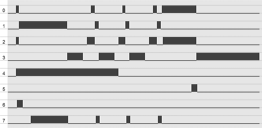

                  The 2100 has 3 hidden timings in its PROM.
                  It's interesting to compare the differences between them. What is plainly apparent is how little adjustment there needs to be to effect a change in operational characteristics, I assume.

                  This is the timing on the 3rd 256 byte page, named X07set3b,
                  I assume it is a test timing of some sort.
                  It is the one that differs most from all the rest. Note trace 0 is missing two of the short pulse medium frequency demod time spaces.
                  It would be good know how each of these small and large changes between timings affect the mathematical expressions that govern their function.
                  Possibly a sweep algorithm could be employed to cover the boundaries of any given piece of ground. I imagined this would've been produced already given the emmergence of SETA but I suspect Australian soil is so variable within such a short time frame that this is not feasible.
                  For countries not affected by such lateritic dissolution, it could be feasible though?
                  I have simulated some code stubs but the resolution so far is 100ns, which will be too wide I suspect to allow stepping without triggering a target response in the processing circuits.
                  I hope to dump the F1A4 timing/s as these will no doubt be different to any of the SD/GPs and post them here, since this is a discontinued product and the patents will be nearing or will have reached their end.

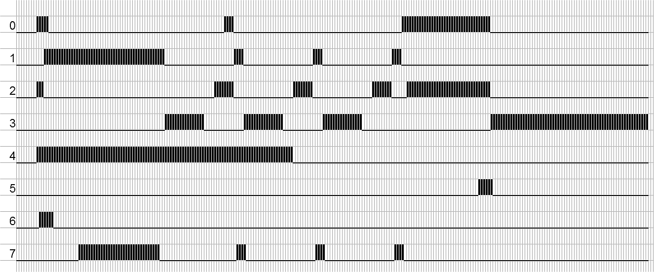

                      This is a warning example to anyone considering editing their SD2100/2200/F1A4 timings.
                      I must've dropped a couple of bits off the hex dump but after decoding, I still had what looked for all intents and purposes valid data sequences, but after rechecking to see why I only had 255 bits instead of 256 in each bit stream, I found that just one or two bit shifts and you could fry your transmitter.
                      This I believe is the correct base timing.
                      The one I posted the other day had the transmitter stream on data line 3 whereas on this one it is 7.
                      Fiddlers beware
                      Kev.

                        Hi Kev,
                        Nice picture, mind if I ask what program you used to generate that?
                        Cheers Mick
                        • #42
                          Hi Mick, pretty crude really, a spreadsheet screenshot. Crook in bed so got heaps of time. Hopefully I'll get my F1 tomorrow, l'Il have to make sure I don't make a too speedy a recovery, or me misses will have me back on painting the house.
                          Cheers
                          Kev

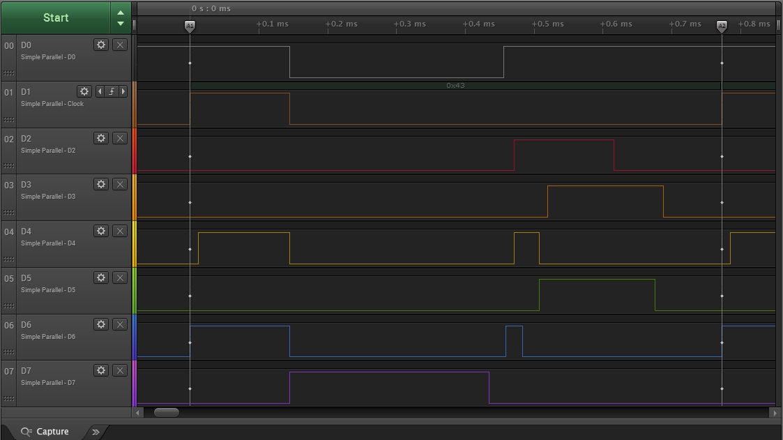

                              This is one of the "hidden" timings on the F1. It has a single pulse (D7) and the potential to go very deep on real nuggetty stuff.
                              It requires a clock adjustment to run properly on the base unit.
                              I'm still working on a solution to that but have the hardware pretty well sorted and many stubs running on the development board which just need to be streamed together.
                              I'm using two 16bit PICs a master and slave, both running around 100MHz, this reduces any latency to naught and ensures glitch-less integration.
                              The slave produces a PWM system logic clock that is injected where the LC oscillator was. The 4040 logic clock divide by 8 causes an interrupt on the slave which outputs the timing sequence to a 573. The 4040 / 8 clock also goes to the 573 and latches the previous sequence out to the demodulators.
                              The master PIC has an 8x2 LCD attached and menu arrangement for gain, frequency and timing selection, it also controls an LTC6903 DDS chip which produces the master clock for the slave, so minor adjustment of the 6903 master clock produces a corresponding frequency change in the slaves PWM logic clock.
                              A 2 wire interface between master and slave allows timings stored in the slave to be changed. Sound is muted during timing and frequency changes. I may add a volume and tone adjustment later.
                              The F1A4 may be a sleeping tiger, I have seen an excellent potential during bench testing. I'm certain that with the right combination of timing, frequency and coil, the F1 will find gold that all previous Minelabs have missed. Jack Lange's video comparing his modified F1 to the 3500 is impressive, and underscores this units potential.
