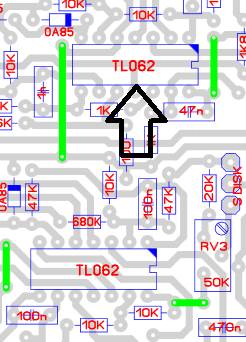

          • What is replacement for TL062??
            can change with TL064??
            • Originally posted by seadoggy View Post
              TL072, tl082, anf lf353 will work.

                • A TL064 is a quad Opamp, the TL062 is a dual so you cannot directly replace one with the other.
                  A TL072 works better but draws more current and is a direct replacement. A TL082 is a noisy TL072
                  so could be used too.
                  TI suggests OP282 and OPA2137 as replacements

                    On scheme is 14 pin TL062,but when is search on internet to buy that IC i get 8 pin TL062!!
                      tl064 gave 14pin
                        tl064 gave 14pin
                        TL062
                        • Yes a TL062 is an 8 pin device
                          A TL064 is 14 Pin so it must be TL064...
