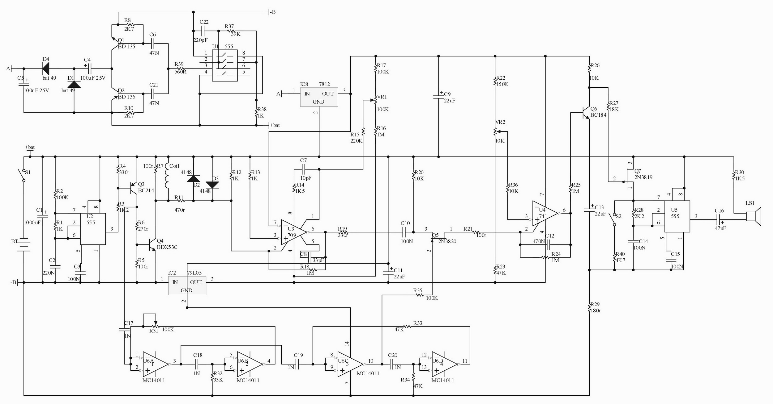

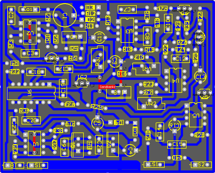

Yes bat yours is old version with tako 87bx135 (that is imposible to find). On this forum is modification without them (shem, plasment, pcb and picture), you can go and see ...

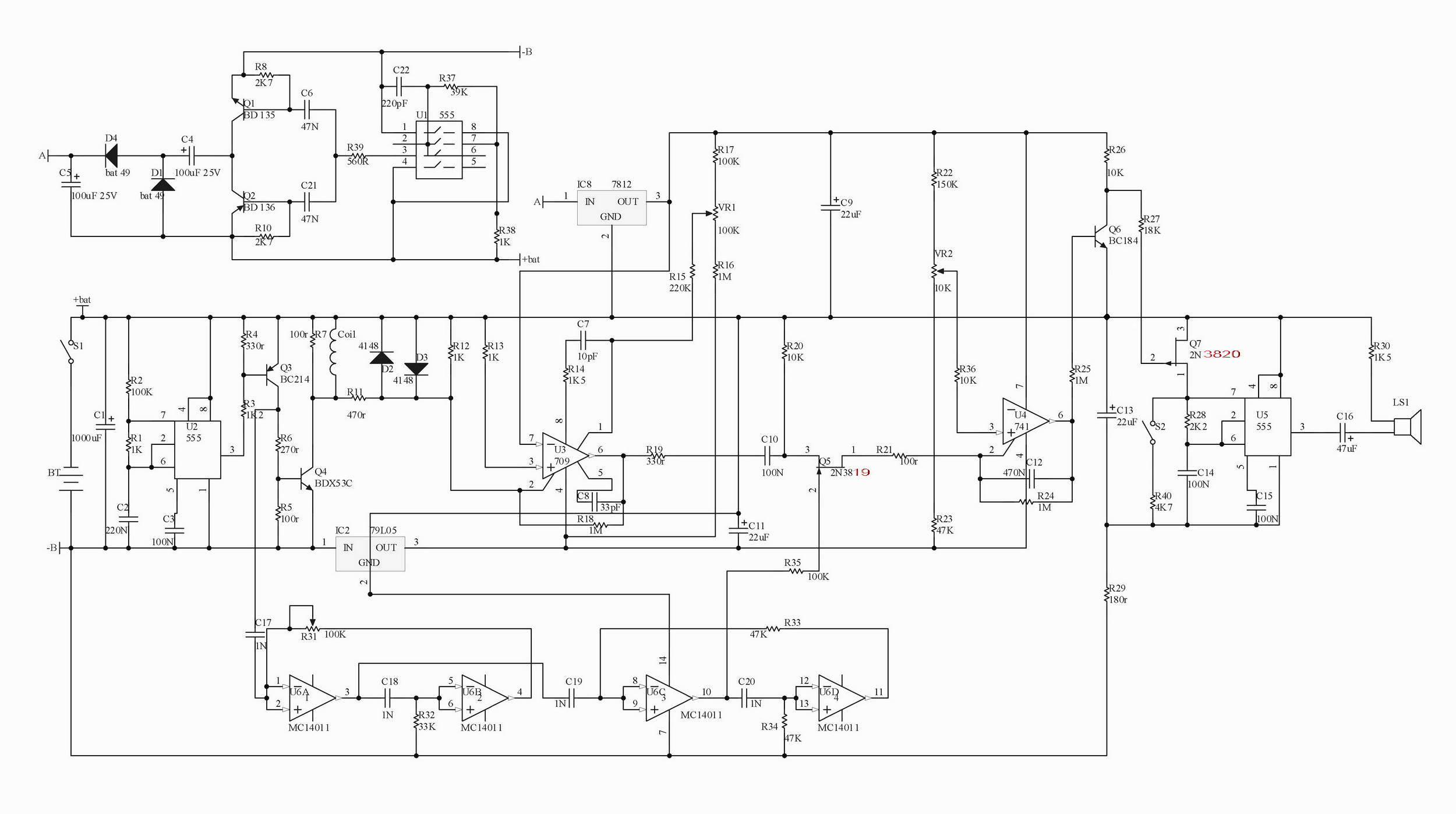

Look up! Post #34 by Qiaozhi!
Where do you see toko transformer?
It is the "new" version that Qiaozhi posted already.
I made it. Working pretty good.

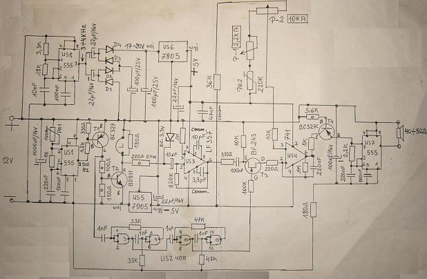

Here are pictures from the forum a "skriveno blago". But I have a question for those who have tried Sandbanks: what is the smallest nugget of gold (for example 1 g -3 g...) capable to detect (in soil) and at which depth?
2 switch with high sensitivity mode without clock, as soon as it senses metal immediately report such to the subject builted be just below the probe regardless of the distance Item ,tremendous sensitivity and very small objects.
That's also not the correct design. Homefire shows an old project of Mark Stuart published in 1989. There is a more new design by Mark Stuart, published after 5 years: http://www.geotech1.com/cgi-bin/page...art2/index.dat
