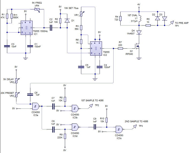

    circuit diagrams below,
    i'm not a whizz laying out diagrams, so there all on separate sheets.......
Name:	TD3X 555's + MOSFET + CD4093.jpg

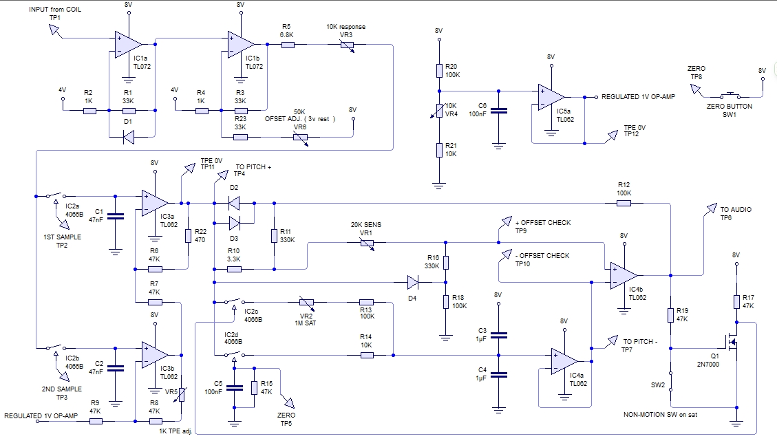

Name:	PRE AMPS + DETECTION 2.jpg

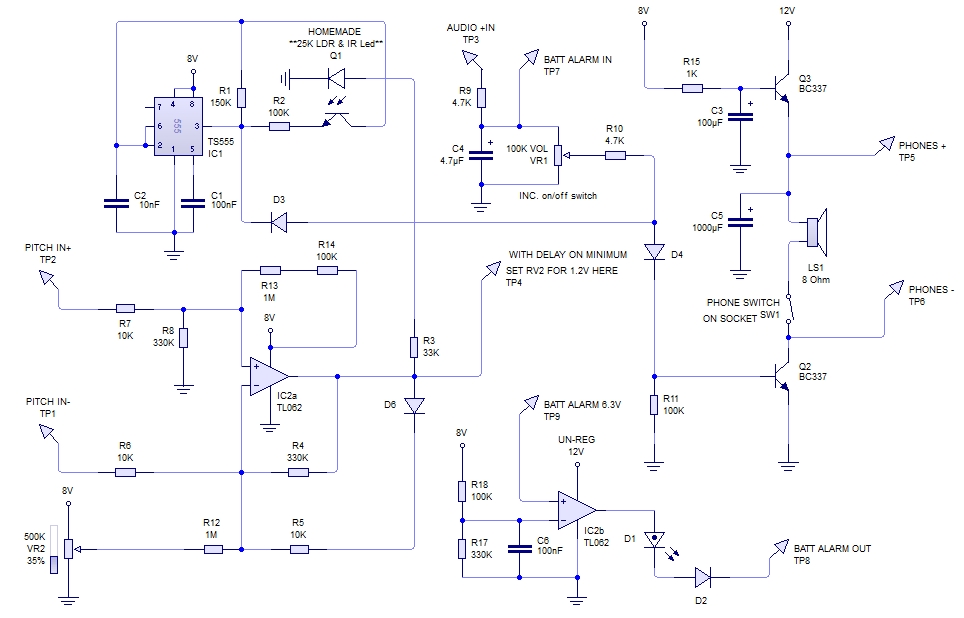

Name:	TD3X audio.jpg

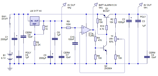

Name:	TD3X power 8v 4v.jpg

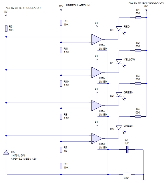

Name:	BATTERY CHECK.jpg
    brief basic explanation:
    1st sheet.
    used 2x555's for the pulse to keep pulse rate and on time separate.
    used TS555's for lower power usage.
    freq is about 1500hz.
    with 70us on time, good compromise.
    used a 1N4937G diode between the coil and mosfet to isolate the capacitance
    of the IRF840.
    the timing is pretty standard (aka surf pi )
    2nd sheet.
    2 stage pre-amp, been mentioned allot over the last couple of years,
    non-inv setup appears to be faster than the inverting setup,
    oh,
    and a diode across the first stage to speed it up a little more.
    used TL072's I like e'm and they seem to fast enough for the job.
    rest of the op-amps are TL062's,
    low power usage,
    and,
    unlike the TL072's can go to 0.65v from the rails.
    earth field cancelling is something I saw on a post way back from sacho ( Bulgaria )
    elegant solution I thought.
    didn't go for the sampling intergrator method,
    actually quite noisy I found ..........
    the detection part of it is what's just that little bit different.
    basically,
    the input voltage level is held on the balanced 1uf caps,
    buffered to the final op-amp used as just an on / off comparator,
    whilst the + input has about 10mv removed to keep the comparator off.
    the hysteresis is corrected / controlled by the diodes to be as near constant
    over the input voltage range.
    think that cleared up that section........
    I think.....
    oh nearly forgot, when the final comparator is on (bleep), the reference caps get isolated
    via the 2n7000 and the 4066 so there's no "creep".
    oh yes,
    and there's a zero function when in non-motion mode.
    3rd sheet
    audio.
    a 2 stage differential amplifier controls the audio pitch from the last 555 via a homemade
    opto resistor isolator.
    when set correctly as soon as the detector starts to beep the pitch rises with target intensity.
    the volume is constant.
    tones at rest is about 450hz, rising to about 1000hz peak.
    did this so the "double wobble" of rings,
    yeah,
    and nails can be much more easily heard.
    erm,
    there's a battery alarm via a flashing led,
    simple elegant solution there I think.......
    I used flashing blue, it was the only colour I had......
    who care's it's inside the box,
    just there to provide a pulsing tone.....
    audio output has "soft start" cap arrangement (4.7k and the 4.7uf)
    more pleasant on the ears.....
    and the top bc337 copies the 8v line (-0.7v) and draws it's currant
    from the battery line so as not to load up the 8v line when it beeps.
    battery check is via a pretty standard setup with an LM339
    via test button,
    doesn't use anything unless you press the button,
    dam you power hungry led's !!!
    4th sheet.
    finally the power supply.......
    its just a regulator, enough said there then.....
    4v and 8v,
    4v for the coil,
    8v for everything else.
    this setup with run quite happily down to 8.1v.
    so nearly 1v per cell,
    suck them buggers dry.......
    the detector only uses about 42ma when not bleeping,
    with coil detached the circuitry only takes 7ma,
    another key criteria of design.
    the coil running on only 4v was a discovery I made a while back,
    the depth capability seems to be governed by coil on time more than
    the voltage the coil is driven by.
    in my experiments 70us on time is a good compromise between power
    usage and depth,
    and all 12v did for me was increase the power usage.

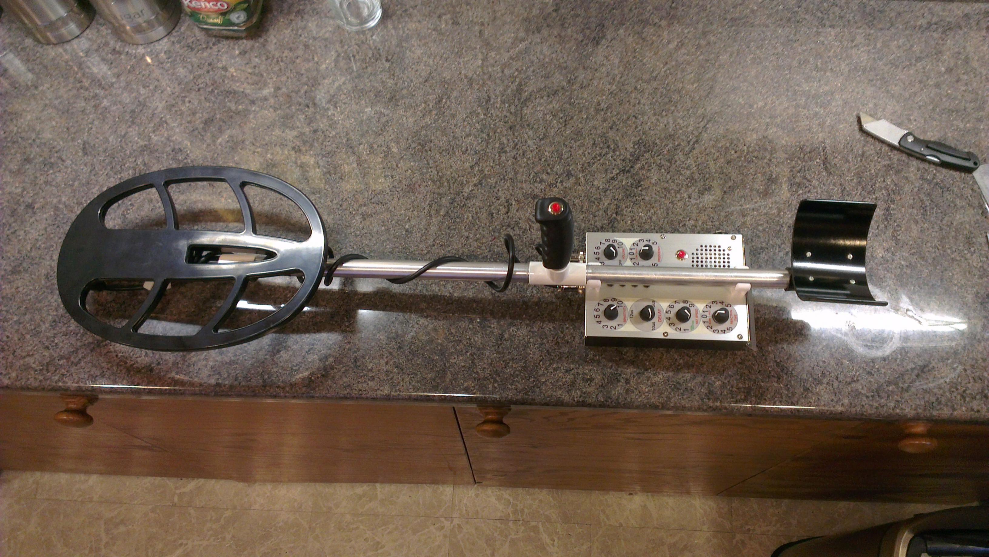

    i'll round up with some pics of my finished detector,
    if anyone's still reading......

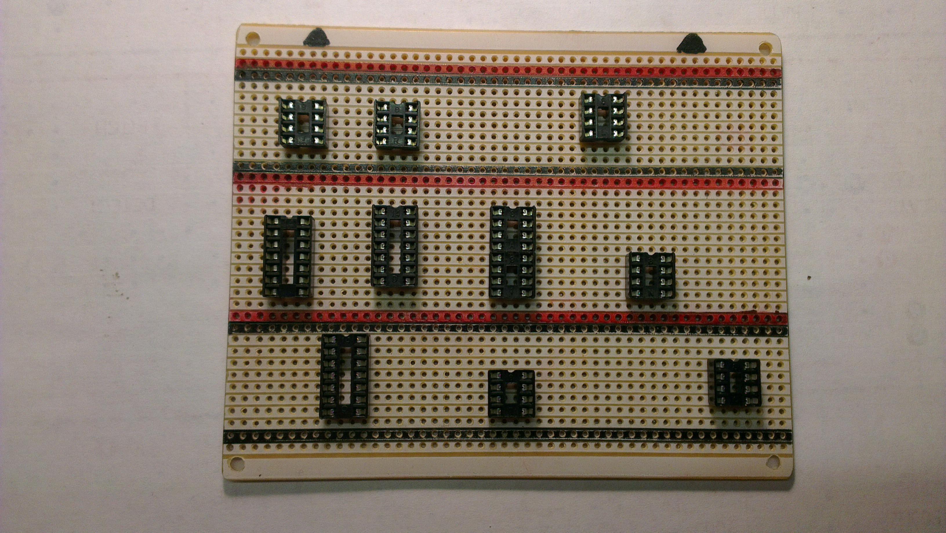

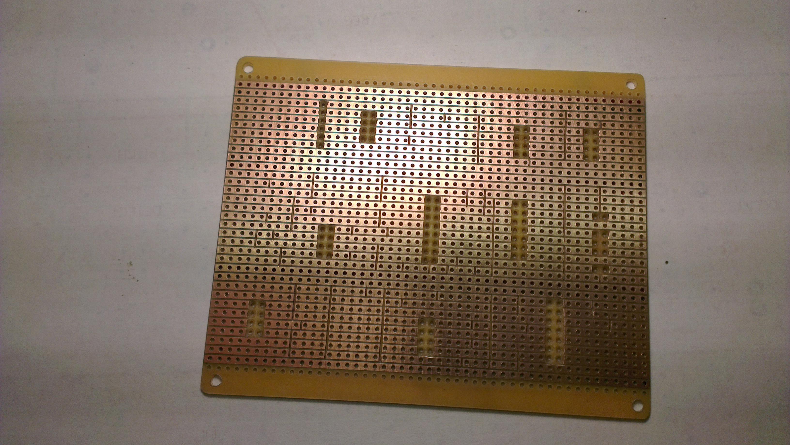

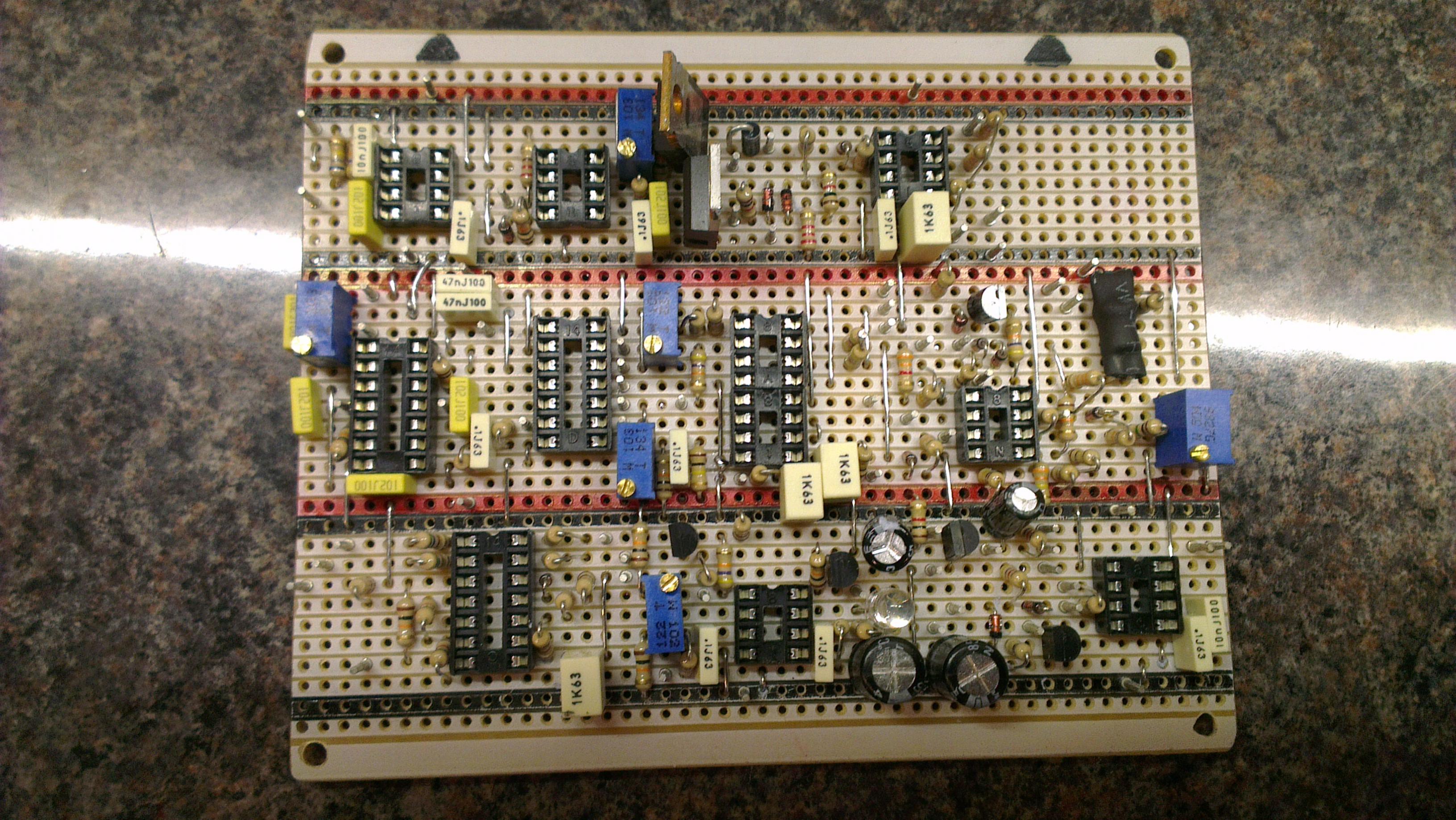

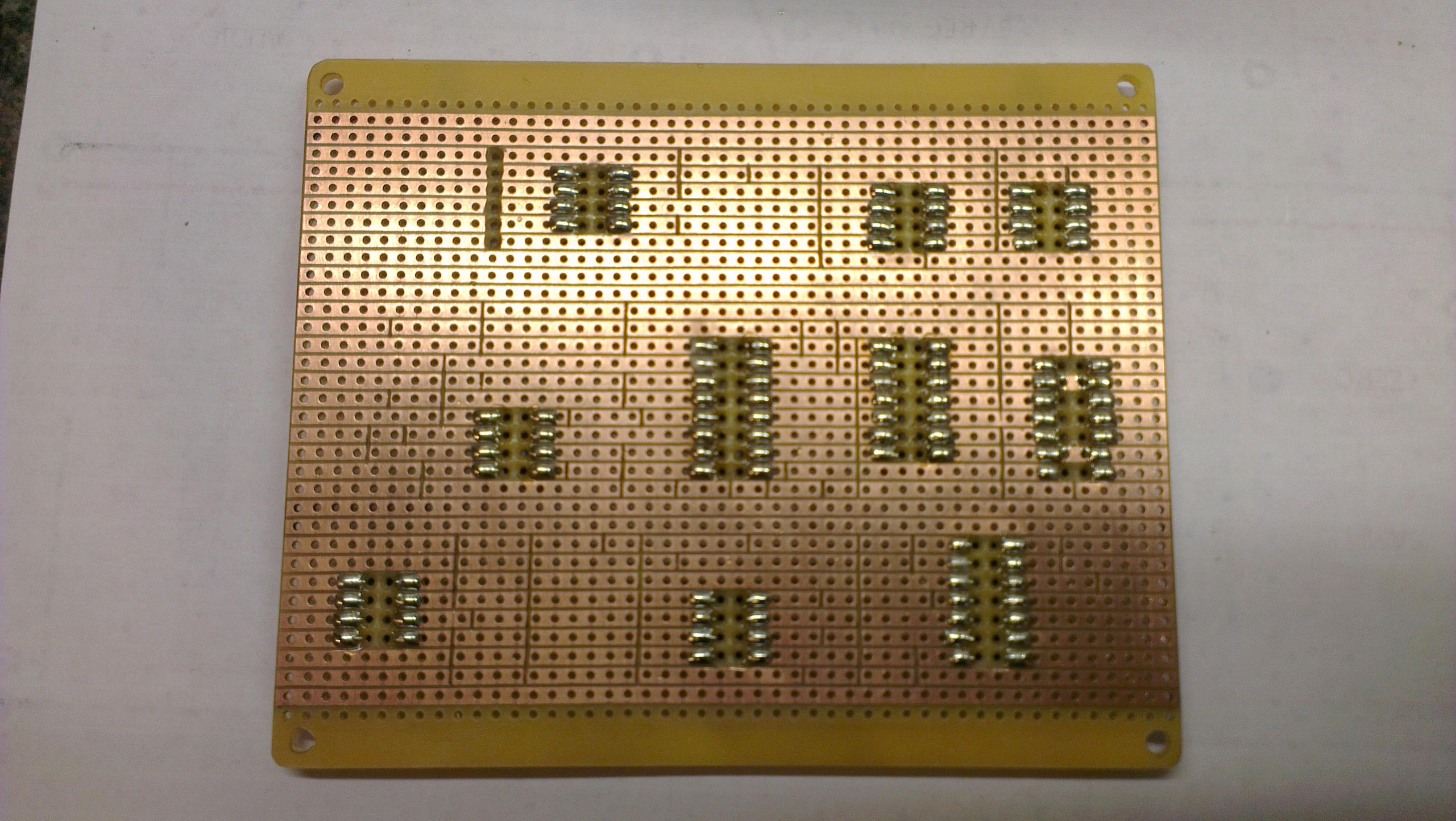

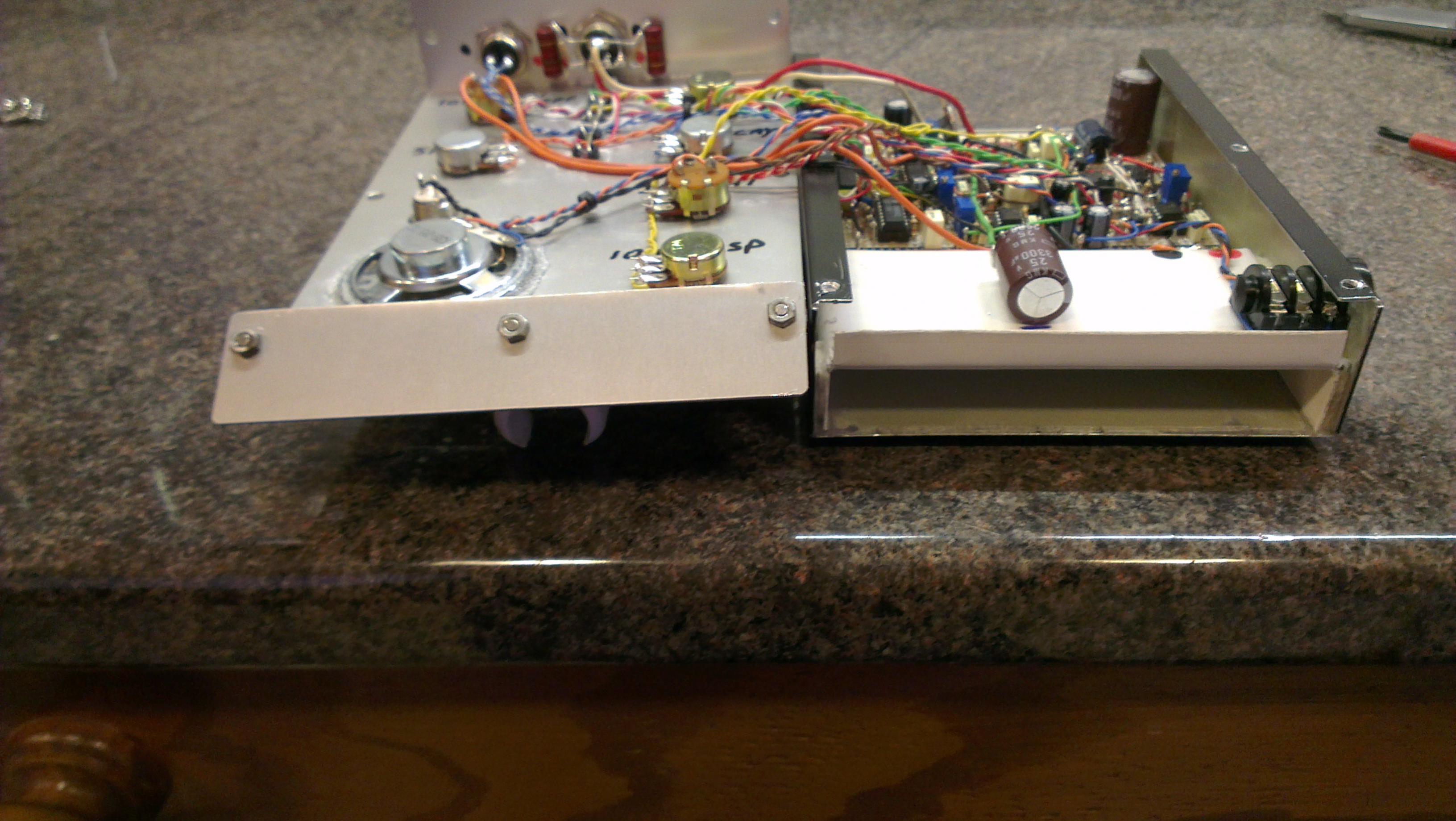

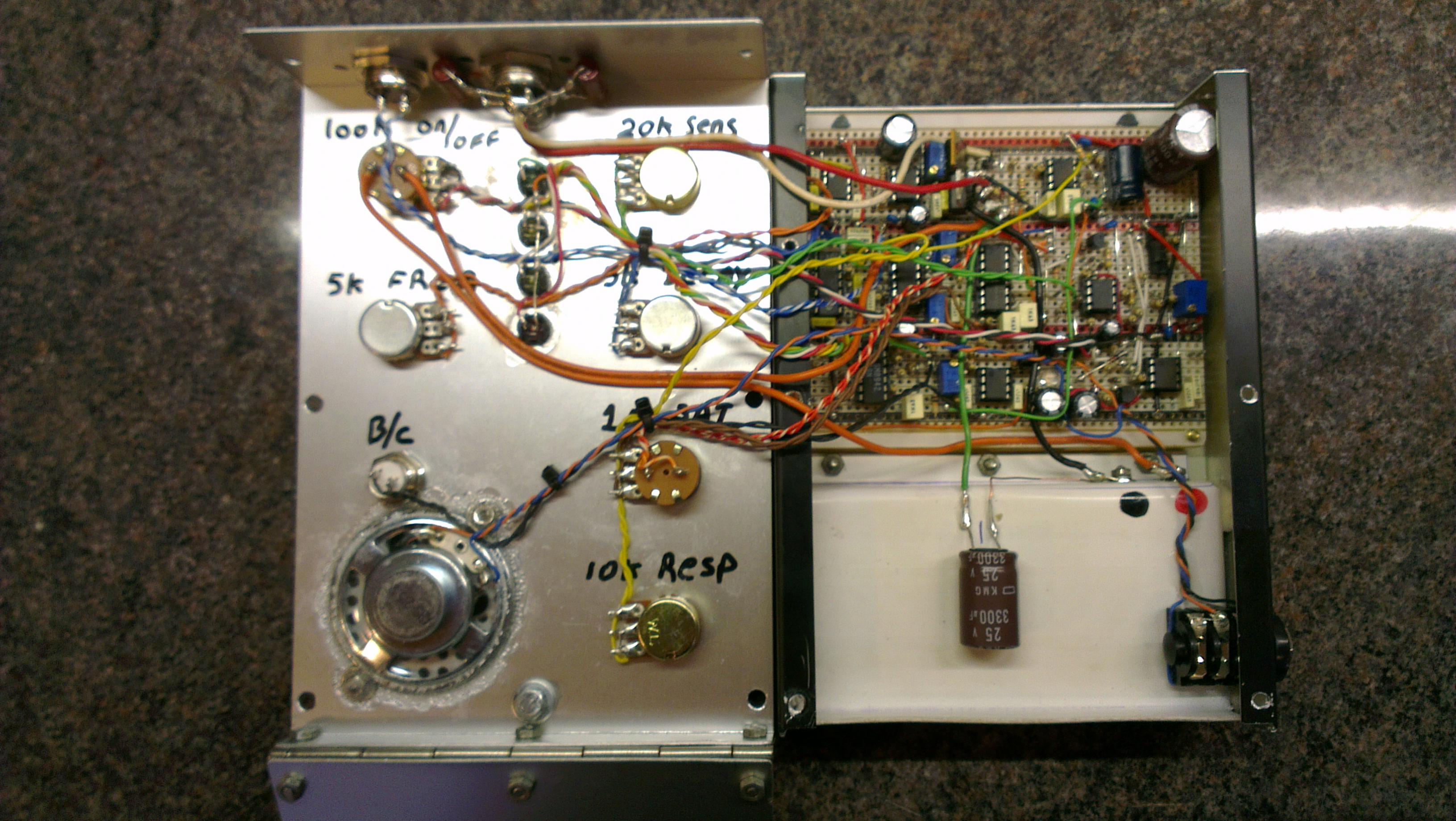

Name:	CUT BOARD.jpg
Name:	IN CASING.jpg

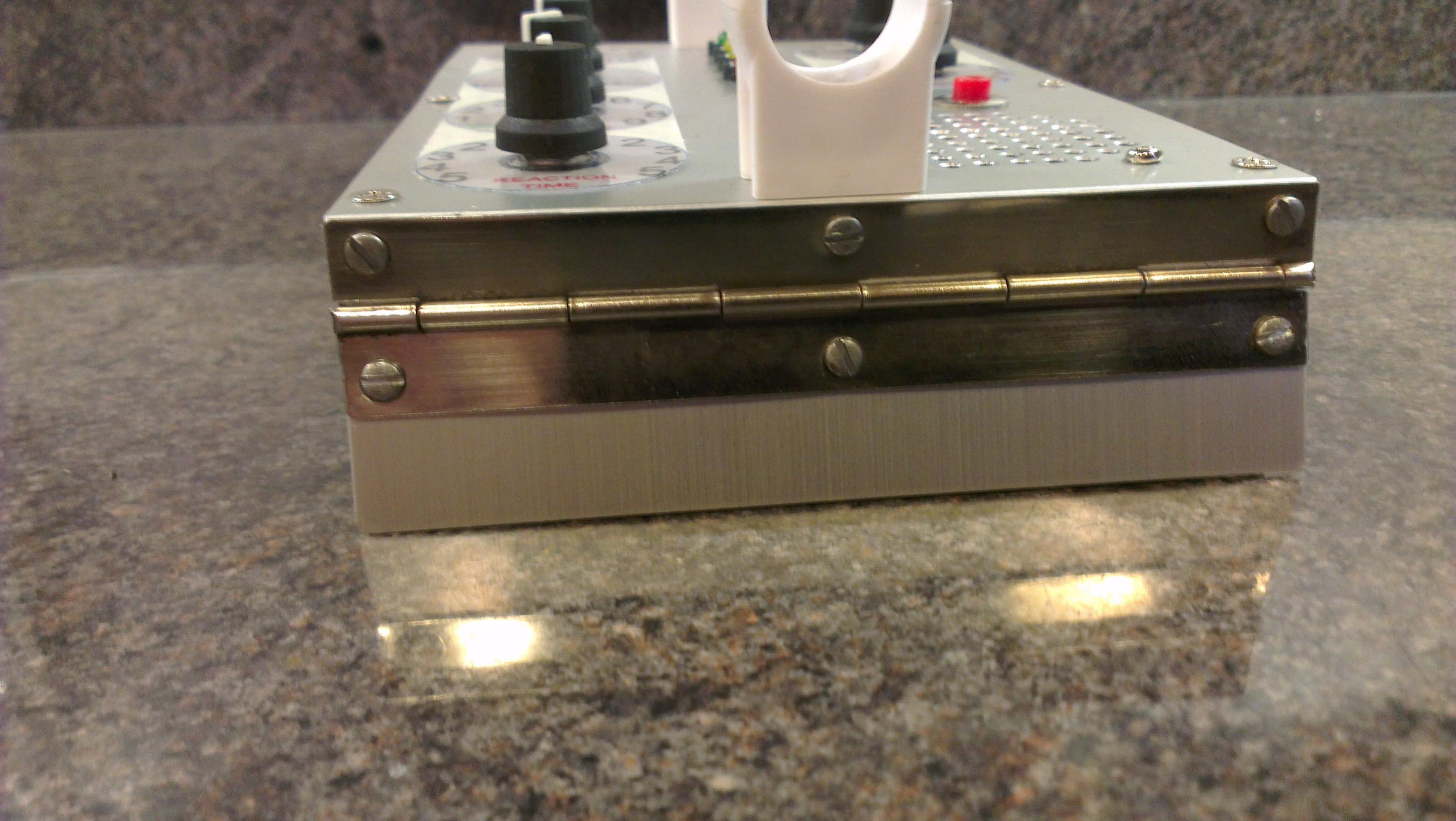

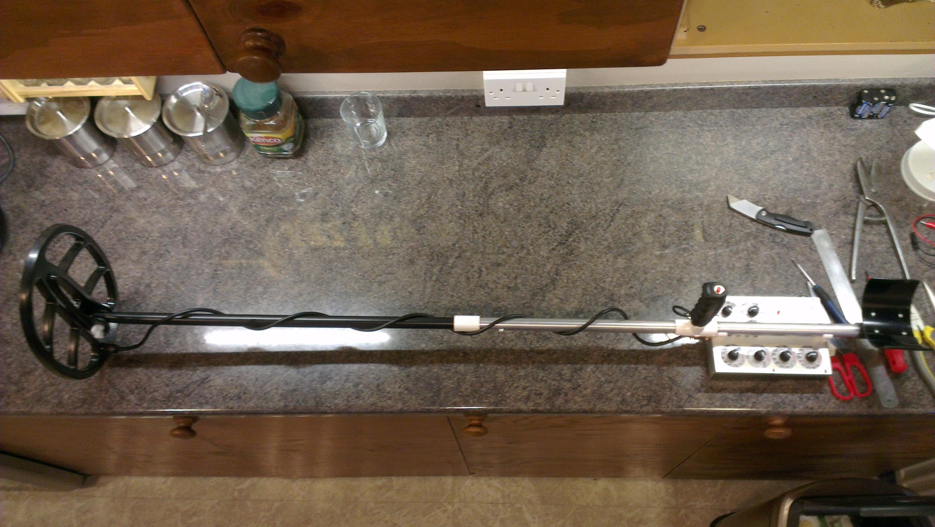

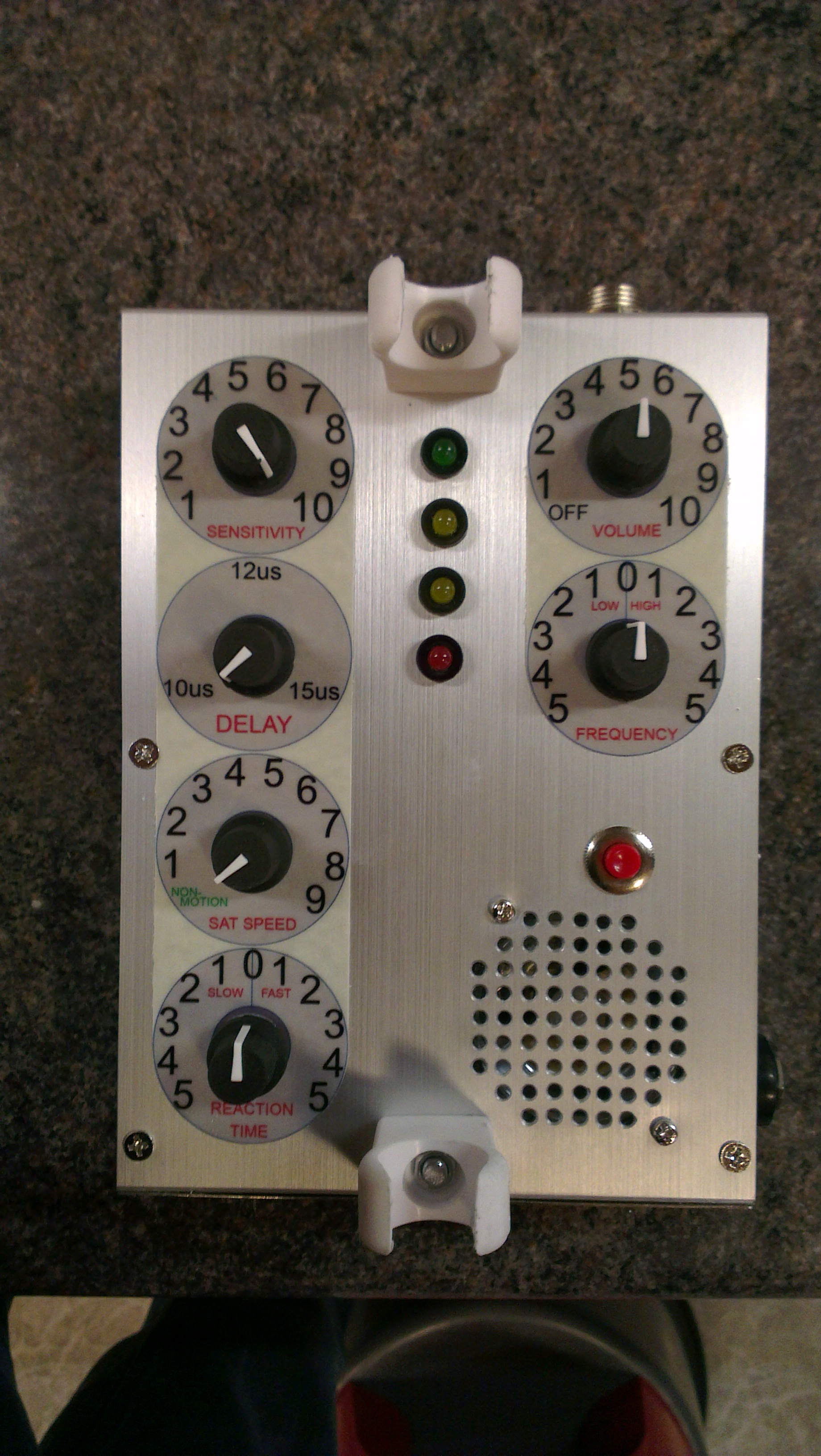

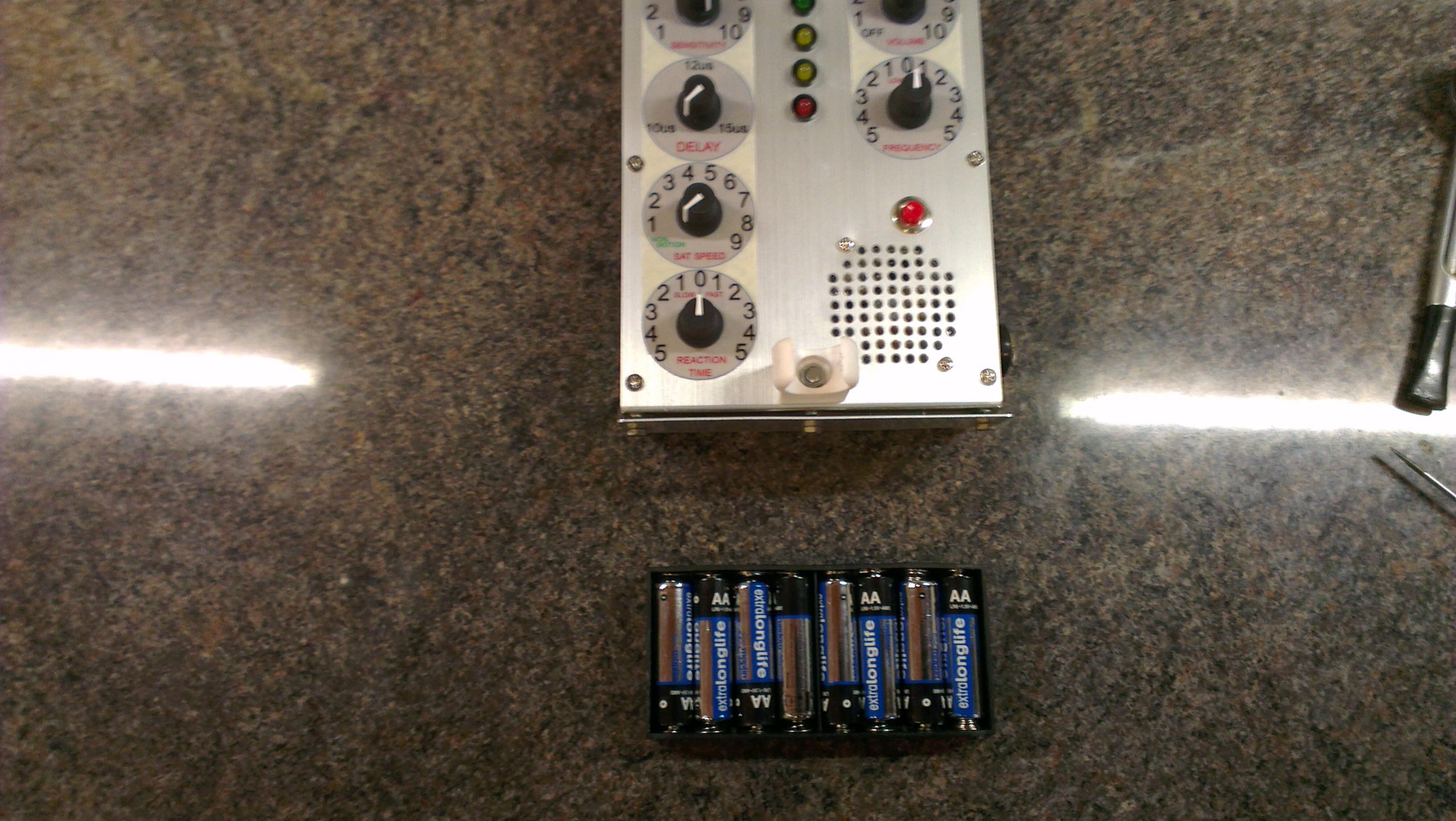

Name:	FRONT PANEL.jpg
Name:	FULL LENGTH.jpg
Name:	SLIDE IN BATTERYS.jpg
Name:	DOOR CLOSED.jpg
      very nice, i love the whites style enclosure, your work is very neat and tidy, its better than my mpp and i had a ready made board.
      i should have done what you have, i made a rod for my own back using a fisher box, anyway enough of my blunders.
      if you decide to get some boards done count me in, i would like to have a build of that.
      aly.
        how doo Sinclair user,
        its been a slow slow process from start to finish,
        been quite fiddly, brain taxing,
        many near mistakes nearly made.
        just tried my best for a professional as possible finish.
        even with various programs to hand vero board building
        is quite taxing on the ole noggin.
        and to think I used to "convert" from circuit diagram to
        board in my head as I went !!
        pcb is deff the way to go.......
        shhhhh...... (yes, love my M6, and thought that's the style !! )
        boxes were £6.50 each off RS.
        2 part coil shell is from micron (Bulgaria, I think.)

                  Great job Dooley, well done.
                    That front panel is excellent, as is the batt. housing. Good one!
                      Very unique. Wish I had a mind like that. Beautiful build.
                        i love the sound, very nice done
                          thank you all for a great response.
                          the front panel decals were done on "pencil project"
                          (cheers to George for a post suggesting the program"
                          they were printed on 25% cotton paper,
                          tougher and more absorbent ,
                          then 3 heavy coats of car spray on clear lacquer.
                          sprayed whilst resting on grease proof paper,
                          just so I could peal the buggers off when dry.
                          the battery housing was a sort of copy from white's.
                          turned 90 deg,
                          didn't have the space to do it length ways.
                          I used plastic square air ducting,
                          planned and cut the shape,
                          warmed with heat gun and bent in to shape.
                          quite allot of plastics are excellent for re'moulding
                          in to other shapes,
                          and if you go wrong, just warm up and shape again.
