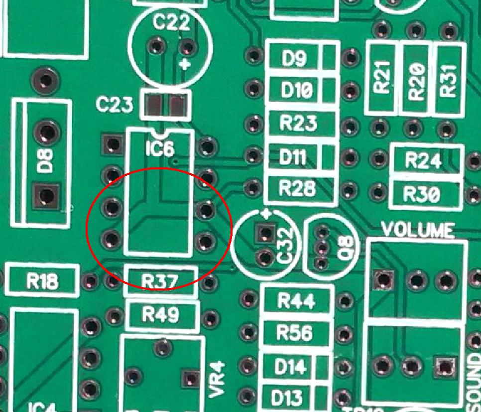

          [ATTACH]34706[/ATTACH]
          Which is incorrect? Pcb or sch. IC6 6.pin GND connected.Click image for larger version
Name:	Pcb error.JPG

            • Yes the board had some issues (so this is an error).
              If there's an interest I would build another batch, offering error free boards for those who already have this board.
              However something must be done with the sound, it's very scratchy or at least mine was.

                      • Hmm unfortunately no, 1st and only batch of boards and contain few errors here and there
                        (this one noted here, few trimmers will need just 2 pins due to wrong connection of the 3rd pin, also check the 555 oscillator for proper pulse width/frequency, I remember I had to make on the fly changes to make it work proper).
