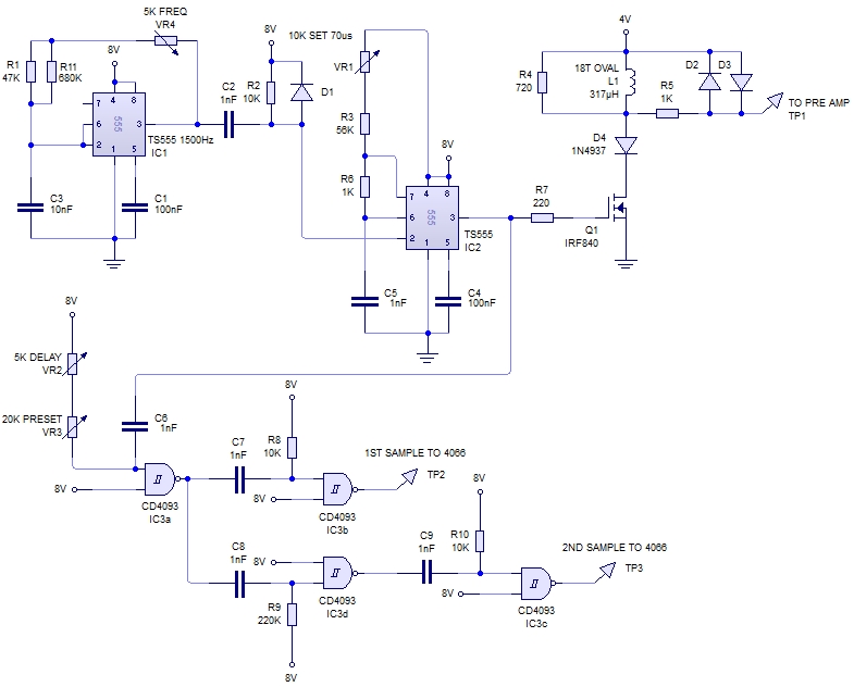

    last night ivconic was in touch and queried the power supply,
    the battery pack is marked up as 8.1v going in to the regulator.
    I should have changed that back to the nominal 12v's from the 8 AA's.
    the 8.1v's is how low the regulator would go during simulations before dropping out,
    and has been tested up to 15v input voltage.
    theoretical top limit would be the maximum of the LM317T and the TL062,
    so about 36v then.......
    not that you'd want to lug about all them battery's.......
      just a quick update,
      can't believe I overlooked this,
      only when ivconic pointed it out to me I realized !!!
      on the 1st 555, pin 8 is not connected to +8v like pin 4 is,
      error happened when I moved over the 555 to the right to gain some space,
      and "the program" deleted the link between pins 4 and 8,
      sorry about that.
      have checked and re checked the diagrams and all else appears fine.
      silly mistakes eh, and I missed it.

                  ok,
                  below is the corrected schematic of the timing,
                  all sheets have been checked and re-checked for errors,
                  and all are fine,
                  what you see is what's in my final built 100% working unit.
Name:	TD3X 555's + MOSFET + CD4093.jpg
                  the difference between the 2 schematics was an overlooked missing link
                  between pins 4 and 8 on the first 555.
                  if anyone has any questions about what does what,
                  or any particular part of the schematics please feel free to ask.

                      hello 6666.
                      ah yes,
                      the 4093 chip is powered from the +8v rail and the earth rail.
                      this doesn't show on the schematic due to the program I used to draw it,
                      (circuit wizard)
                      some of the chips have "hidden power"
                      usually +5v.
                      can be changed on the program to any voltage,
                      but still doesn't show on the schematic.
                      yes,
                      VR5 on the lower earth field cancel TL062 ( IC3B)
                      is a 1k multi turn preset .
                      the upper TL062 ( IC3A )
                      has a 470 ohm added to its 47k ,
                      so that VR5 can go " above and below " to zero out earth field balance.

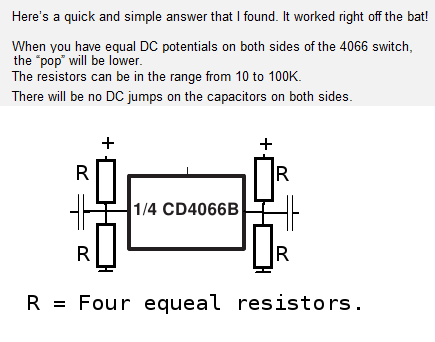

                      since making this project I have had chance to fully evaluate its operation
                      on beaches whilst away on holls.
                      when in the "non motion" mode every now and then it "latches" on to a full bleep ,
                      and zero has to be pressed.
                      since found out this is a problem with the 4066 chip.........
                      when they open a tiny "surge" or "click" is passed on to the storage capacitors,
                      this is documented on many audio websites about the problem.
                      poss a different method should have been used there,
                      not sure what though.
                      motion mode is very reliable ,
                      fast or slow,
                      non motion I now only use for pinpointing.

                              wasn't 100% successful as I replied to 6666 earlier,
                              unfortunately,
                              4066's tend to have a little voltage surge when they open,
                              this sometimes alters the voltage on the sample and hold capacitors so unfortunately
                              the final detection stage remains "on" after the target has passed.
                              however,
                              lowering sensitivity doesn't solve that problem,
                              but,
                              the threshold remains above the extra voltage added to the sample and hold
                              capacitors by the 4066.
                              would be nice if there was a drop in replacement for a 4066 that didn't have a "click".
                              wondering if the old 4016's would have been a better choice,
                              they may do the same,
                              not sure.
                                Here is something I came across Click image for larger version
ID:	343501 that might be workable?
