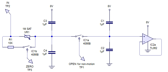

    audio websites have any previously discussed adding lots of capacitance
    to whichever side is your output side,
    not sure how to implement the solution you have shown in a dc coupled stage,
    but worthy of consideration.

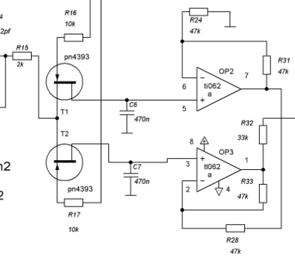

      earth field cancelling is something I saw on a post way back from sacho ( Bulgaria )
      elegant solution I thought.
      Hi Dooley do you still have the text of that post ? as I would be interested to read what is said in it , thanks.

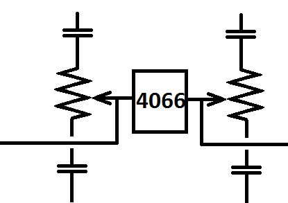

        Maybe some thing like this? Click image for larger version
ID:	343502 when you find the values, hard wire it..
          Maxim has a page describing attributes and behaviour of switches (like 4066). Many interesting points, including "charge injection" and "make before break".
          http://www.maximintegrated.com/en/ap...ex.mvp/id/5299
            hello 6666,
            didn't have any text of explanation regarding the earth field cancel arrangement
            that appeared on a diagram that was posted on here with "Sascho Bulgaria" written on it,
            it was just self apparent what it was there for,
            and what it did,
            so used it.
            section below........
Name:	EARTH CANCEL sascho bulgaria.jpg
            hello Thomas,
            been pondering how to use your suggestions.
            done a rough mock up below......
Name:	POSS ALT 4066 pic.jpg
            only poss way I could think of to suppress the 4066 whilst still leaving
            the end on end storage and hold capacitors alone when the switch is open.
            although, this may not work.........
            not sure theres an easy solution to modify my original arrangement to stop it
            happening and still allow it to operate as intended.
              cheers greylourie,
              checked out that link,
              and had a quick browse through it.
              will read in closer detail later.
              hum,
              so rather than mess about trying to cure an inherent "fault" with a 30 y/o
              chip,
              poss worth considering a replacement,
              and by the sound of it pin for pin compatible replacements are available.

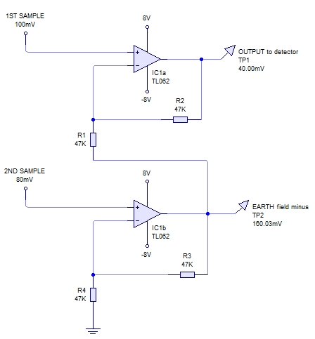

                had a request for an explanation as to how the earth field cancel works
                via private message,
                but cant post pictures on private messages,
                so replying here......
                hello 6666,
                its quite simple really,
                both samples get amplified x2 ,
                then the earth field signal is taken off the 1st sample,
                resulting in the difference x2.
                quick example below........
                so,
                the 100mv 1st sample gets amplified x2,
                so would be 200mv, if the lower 47k was connected to earth.
                the 2nd sample is 80mv,
                gets amplified by x2 resulting in 160mv.
                then, this 160mv is taken from the 200mv,
                resulting in 40mv difference ,
                which removes the earth field and amplifies the target
                signal by x2.
                I have shown the op-amps in this example running on + and - supplies,
                so my 1 volt reference voltage is not needed,
                it was only needed in my design due to running the op-amps
                on +8v and 0v.
                the TL062's are only capable of sensing to down to about 0.62v without inversion.
                (output drive also about the same, 0.65v from each rail.)
                hence, on my design with 0v and +8v supplies I had to use a 1 volt reference voltage
                on the 2nd sample op-amp to keep it above this region.
                if + and - opamp supplies are used then this reference is not required and the 2nd
                sample op-amp can be referenced to 0v.
                point to mention,
                the TL072 can only sense down to about 1.66v before inversion,
                (drive is about 1.69v from each rail)
                just thought id mention this before someone tries to use a TL072 here..........
                (and some people thought all the TL 062,072,082 were all about the beast..........)
                next point to mention with this system,
                the input voltages need to be less than 1/2 of the supply voltage,
                or the 2nd sample opamp will just be railed out all the time.
                hence why I tweaked my preamp offset down to settle at about 2-3v.
                if this system is used on a Pi with + and - supplies to its opamps,
                and the signal voltage falls to 0v,
                then this system works fine.
                however,
                this system only provides x2 gain,
                where as a sampling integrator like used on the surf Pi variations
                can provide x220 to x470 gain.
                hopes this explanation helps.
                  Hi Dooley thanks,
                  the quick example attachment is invalid.
                    ah,
                    oh dear,
                    yup,
                    your not wrong, it's also changed name.............
                    try this,
Name:	EARTH FIELD CANCEL 1.jpg
