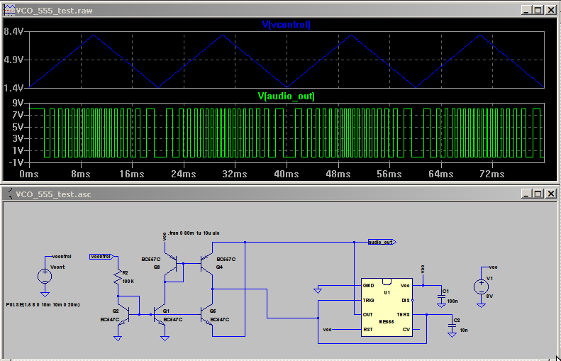

      An alternative to the LED + LDR is the following VCO (voltage controlled oscillator).
      The control voltage sets the charging and discharging current of the capacitor C2 (through current mirrors Q1 - Q5), determining the oscillator's frequency and causing a 50% duty cycle for all frequencies.

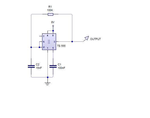

        below is a picture of the simple way to configure a 555 for 50/50 output.
Name:	STANDARD 555 50-50 output.jpg
        so pretty standard 6/2 link,
        and resistor from 6/2 to pin 3,
        and produces very close to 50/50 duty.

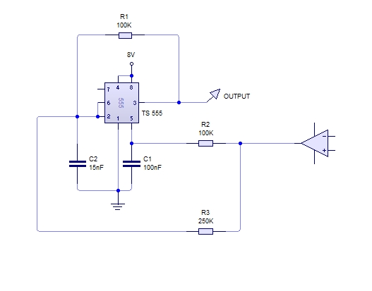

        so,
        altering the voltage on pin 5 as we all know will alter the frequency / pitch output,
        but,
        duty cycle all goes to hell,
        as the pitch goes up, the duty goes down and effectively makes the audio sound quieter.
        as the pitch goes down, the duty goes up, it doesn't get louder, but just costs a lot of power wasted in the speaker,
        things get hot etc etc.......
        if only there was a way to play with the voltage on pin 5 AND keep the duty constant...........
        the 555 IS a marvellous little chip........
Name:	MODIFIED 555 AUDIO.jpg
        and,
        is all it took was a single resistor !!!
        the 250k resistor is the key to it all.
        just why a resistor that is 2.5X the value of the 555 feedback resistor works is anybody's guess,
        poss some bright spark can explain.
        few points to make,
        ive used a TS555,
        their internal resistor network comprises of 3 x 100k resistors,
        as apposed to an NE555 which uses a network of 3 x 5k resistors,
        so with the diagram ive posted don't use it on an NE555 as it prob wont work !!
        anyways back to the chase,
        ivconic,
        simply alter the audio TS555 section to be like the 2nd diagram ive posted,
        so pin 5 capacitor remains the same 100nf,
        alter the 6/2 capacitor to 15nf,
        the 150k feedback resistor needs altering to a 100k,
        remove the homemade LDR/IRled, chuck it in the bin, AND THE 33K.
        connect a 100k to the op-amp output that varies the pitch (the op-amp that used to feed the 33k to the IR led)
        then,
        most importantly,
        swop over the feed to the pitch op-amp before the 10k's
        this is essential as the 555 raises its pitch as the voltage on pin 5 is lowered.

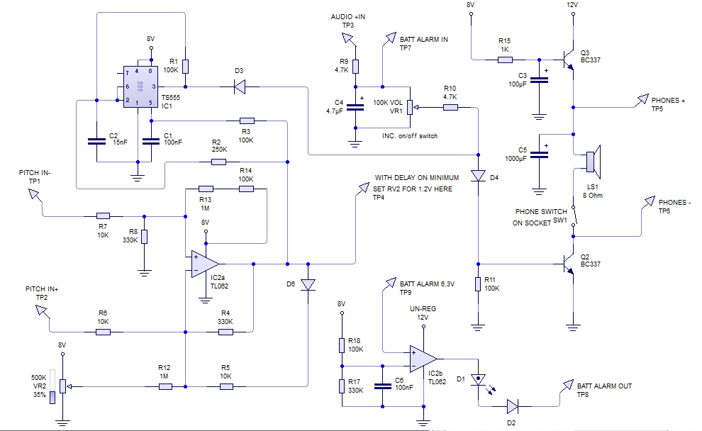

        altered TD3X audio section below :
Name:	TD3X audio MODIFIED no LDR.jpg
        100% tried the audio section and it works well.
        pitch rests at 380hz and raises to a maximum of 720hz which should be equal to the LDR version.
        duty cycle is more or less a constant 42%
        so no wasted power,
        no alteration of volume during pitch change,
        and still pretty close to 50/50.
        enjoy !!!

          • #80
            This is how to set the frequency of my 555 VCO:
            Every time you double the control voltage, you double the frequency.
            Originally posted by DOOLEY View Post
            hello teleno,
            you beat me to a solution by 13 minutes !!!
            lol.
            yup,
            an elegant solution you have there,
            I tried something similar a while back,
            couldn't get my version to stay 50/50.
            I fed with one transistor and discharged with another,
            I rekon my early attempt that was charging the capacitor to 8v - the 0.7v npn drop,
            and discharging to 0.7v,
            didn't work due to the 555 on an 8v supply runs the capacitor between 5.33v and 2.67v,
            and my early attempt wasn't "central"
            You probably overlook that the transistors have to be configured as current sources/sinks of the same value.

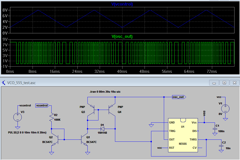

            • #81
              This might work with CMOS 555 and with some emitter degeneration.
              LTspice 555 is idealised and therefore the output goes from 0 to Vcc, but not so in RL. CMOS version is much closer to ideal, but you'll need some emitter degeneration anyway. You may seek a non-ideal model of 555 and try this with it, but don't be too disappointed.
              • #82
                A high value of R2 makes sure the load on the 555's output is small. A resistor at the emitter of Q4 or Q6 (the one sourcing/sinking more current) equalizes the charge and discharge currents.

                  • #84
                    This version of the 555 VCO overcomes the problemes noted by Davor (thanks for pointing them out).
                    1. The actual low and high output voltage levels of the particular 555 implementation (CMOS or bipolar) no longer have an influence.
                    2. Only Q3 and Q4 need to be matched.
                    Oscillation frequency:
                    • #85
                      While this is much better than the circuit before, there is still a problem with matching transistors. Perhaps this is a candidate for CD4007 MOSFET array. Or moving to a completely different kind of VCO.
                      • #86
                        There are nice matched PNP pairs for 40ct. at mouser.com (BCM847BV)
                        Tehre's also MMPQ6700 with two PNP and two NPN in one single package for $1.50.
                        A one-chip solution is the LM566 (obsolete) or LM567 (VCO part) or even the VCO in CD4046

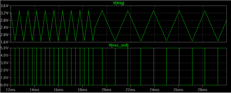

                            Note that the VCO produces a pure triangular wave on pin 2 (TRIG) which has a nicer sound than a square wave.
                            You can compare the sounds of sine, square and triangle waves here.
                            • #89
                              hello all,
                              many thanks teleno for offering alternative solution.
                              i'm not really in to formulas and equations................
                              the solution I proposed looks simpler .
                              on my simple approach ,
                              the 250k feeding the 6/2 link raises, or lowers the voltage to the timing capacitor inline with
                              the pitch altering voltage so that the duty cycle stays more or less fixed.
                              ok,
                              it's not 50/50 duty anymore,
                              but 42% is pretty close and sounds quite nice.
