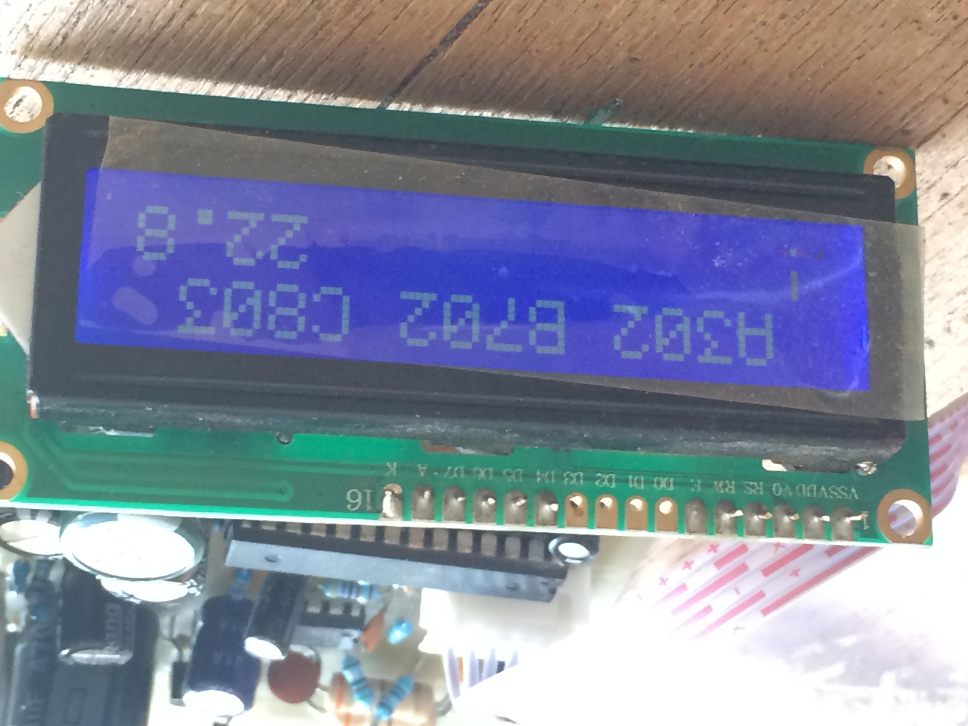

                        Hi marin2,
                        My apologize because I didn,t believe you about this numbers, now I get them by myself. Problem and solution are simply!
                        Your mega328p has arduino bootloader ! Just change H fuse from D1 to D9, erase chip, than go again L fuse- E7, H fuse D1, E fuse FC, and burn hex file.
                        That is all!
                        Regard

                          • Hi marin2
                            Your problem is from ici . lm318 -ua741-Does not work with the device They give weak numbers Or large numbers
                            Look for the original one lf357
                            • Originally posted by karim1980 View Post
                              Hi marin2
                              Yes karim1980, that is wright-only lf357 give proper numbers; but 37, 37, 45, gives ONLY LOADED ARDUINO BOOTLOADER! Yesterday i forgot to erase bootloader and guess what? Those numbers appears.
                              regard
