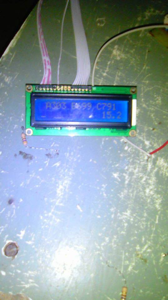

    [ATTACH]40313[/ATTACH]
    A-302 B-702 ok, I can easy reach them (as I sad), but C-800?! HOW??? PLEASE discover my HOW. What Is that number average of? TX circuit, RX ingress, RX amplification, coil parameters coil cable or some secret ingredient?

      • I have changed the resistance to 100 ohms so the chifres good. c is not a good idea..because I have seen that the type of wire plays an important role for numbers. For example, the 20 cm .350uh coil with 0.5 wire, the numbers are good but when I change the wire type 0.7.I think it means less inductive reaction and with a large amplitude at the input of Op_amp And the numbers lesser. Same thing when I use the 30 cm reel with the 0.6 wire of the good Chifres, I play with the number of wires to adjust the numbers further, but when I change wires with 0.7 or 1 mm, the Figures appear insufficient and the automatic delay also increases more than 24, even if the induction is low. In my opinion, I think. Due to the type of wire and the winding and the space between the wires
