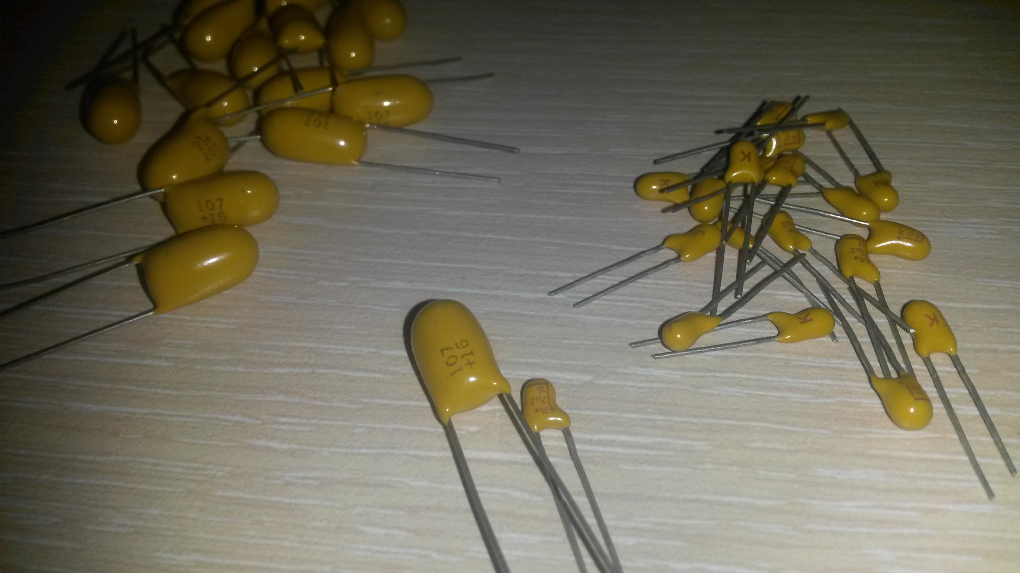

    C4, C5, C7, C8, C9, C14, C18, C20, C21, C23, C26 - Those should be ceramic caps
    C11 2,2µF - Tantalum
    C6, C12 100µF - Tantalum

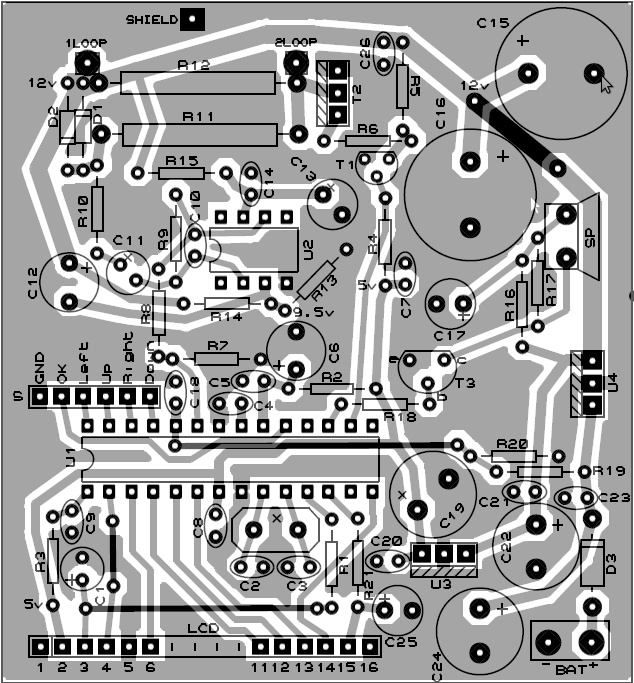

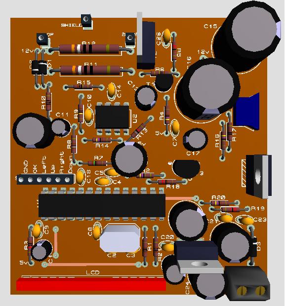

    According the 3D image of the PCB, and the silkscreen, C11, C6 and C12 are shown as electrolytics.
    • In the iranian document from the designer it's mentioned these caps are تانتالیوم which translates to Tantalum
      FelezJoo_PI_v3_00.rar
        OK - in that case the 3D image of the PCB, and the silkscreen are incorrect. Perhaps the PCB layout program that was used cannot handle tantalum capacitors, and hence they were shown as electrolytics.

                      • Originally posted by koohyar View Post
                        I put to you some of the parts list, which was sent as pdf
                        And is about the type and amount of capacitors.
                        Much of the confusion here has been caused by the information being written in Persian.
                        Also, the supplied 3D PCB image (and the PCB silkscreen) both show C11 and C6 as electrolytics.

                        The supplied images show C6 and C11 as electrolytic capacitors. May I suggest that you update the information to be consistent with the parts list and the description.
