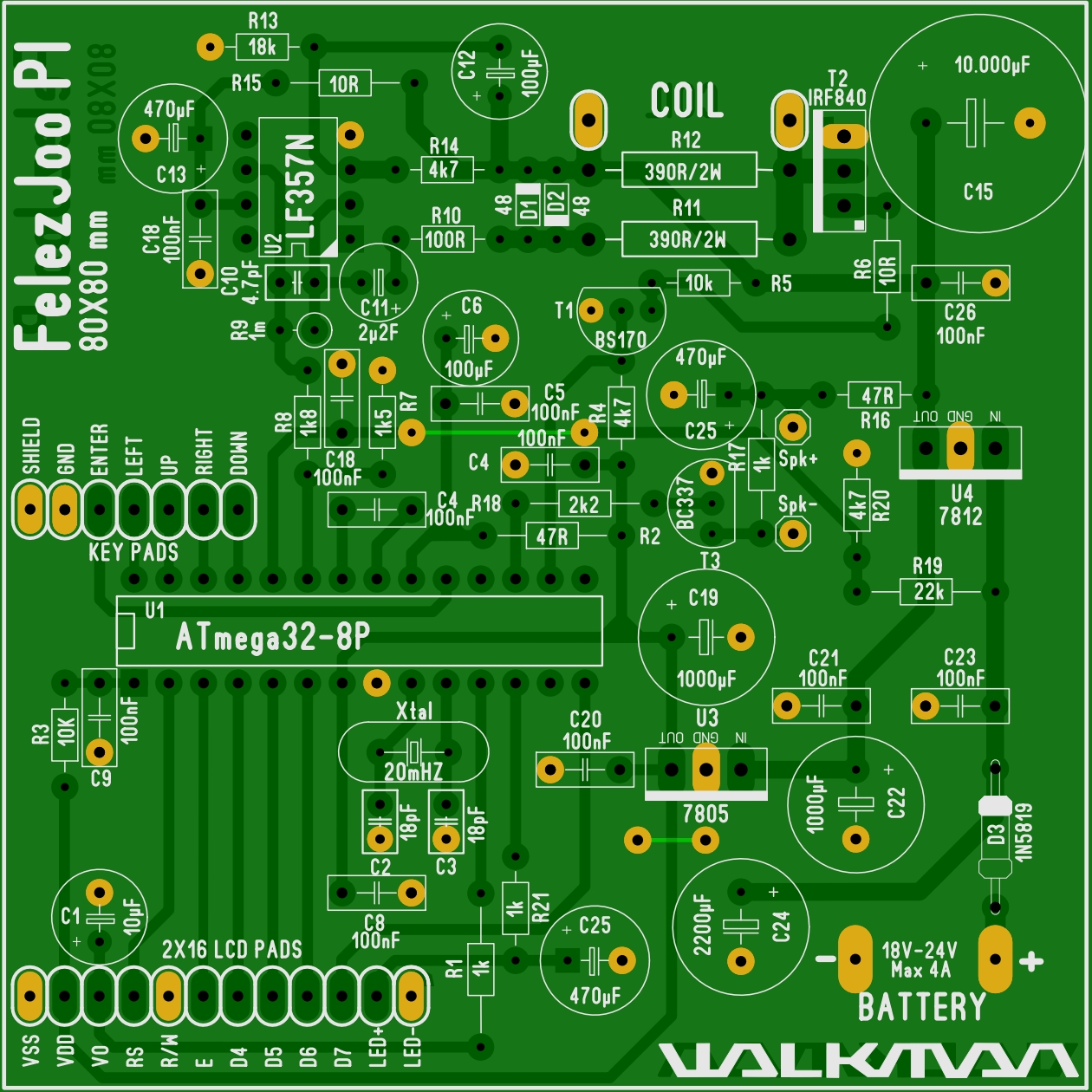

                        • i found two PCB layout.
                          - what do you think to do Gerber file ?
                          - Are they functionnal ?
                          Walkman felezjoo PI
                          FELEZJOO PI.pdf Click image for larger version
Name:	PCB LAYOUT.JPG
                          Lay6
                          Original in lay6
                          Felezjoo.zip
                          thanks

                              • TODAY I ATTACHED 16x2 LCD TO felezjoo PCB BUT IT DID NOT TURN ON. GIVING IT 12V DC FROM POWER SUPPLY, NO COMPONENTS HEATING UP OR ANYTHING. GURUS HELP ME SORT WHAT'S WRONG WITH IT. I HAVE MULTIMETER AND OSCILLOSCOPE TO TEST.
