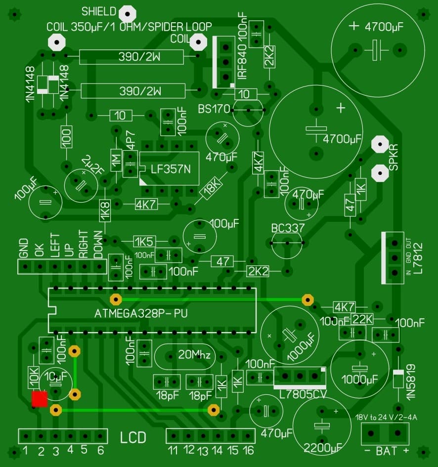

            My detector worked well. I wanted to insert the detector in a box and I had to do a wrong manipulation. My screen does not work anymore (so I'm blind) and i bought a new. I have no sound at boot time.
            I feed it in 19V.
            - I have 5V between the terminal of the resistance 10k (next to pin 1 of the LCD) and the ground. pparently is the good value. I put a picture attached Click image for larger version
            - The 7805 is very hot.
            - Are there points to test on the circuit (volt, impedance, oscilloscope) to check that we have not grilled or desoldered a component?
            Thanks for your help
            • @gandlofi my expert help was taking voltage readings throughout the building of felezjoo and claimed it a success. I will get the voltage readings from him and map them on the PCB layout same way as you did....
              • Originally posted by chuubaba View Post
                Thank you very much. This will help me and will diagnose faults according to the voltage, the conductivity obtained or the signal to the oscilloscope on certain points of the circuit.
                I do not know if it comes from a bad solder or a faulty component.

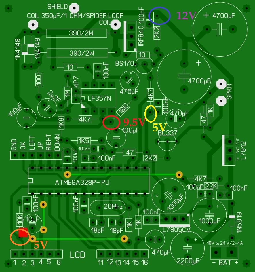

                • I HAVE USED YOUR PCB DIAGRAM TO MARK THE READING POINTS AND VOLTAGES . PLEASE NOTE THAT THESE READINGS WERE TAKEN WITHOUT INSTALLATION OF ATMEGA AND LCD USING 12V DC SUPPLY. IT IS AFTER I FIT ATMEGA AND LCD THAT THE VOLTAGE DROPPED SIGNIFICANTLY LOW AS FOLLOWS. BLUE CIRCLE = 3.5V. YELLOW CIRCLE = 1.5V. ORANGE CIRCLE = 1.32V. BOTH THE SCREEN AND SPEAKER REMAINED SILENT. NOW I RAISED THE VOLTAGE TO 30V AND FOLLOWING WERE THE READINGS; BLUE CIRCLE = 11.9V. YELLOW CIRCLE = 6.7V. ORANGE CIRCLE = 1.32V. BOTH THE SCREEN AND SPEAKER REMAINED SILENT. NO HEATING OF ANY COMPONENT.

                  • Chuubaba pin 2 LCD(orange circle)=VCC (power) of Atmega need to be close to 5V.
                    My PCB 4,982V if 12V supply try to put only Atmega no lcd my detector work normal for me without lcd.
                    • THANK YOU GLOWIAN. LET ME TRY TO REMOVE THE LCD AND SEE IF THERE IS A IMPROVEMENT IN VOLTAGE...

                          • DEAR GLOWIAN I HAVE TRIED BY REMOVING THE LCD FROM CIRCUIT BUT STILL THE VOLTAGES ARE DEFICIENT. PLEASE TELL ME VOLTAGE OF ALL YOUR RADIAL CAPACITORS whether 16V OR 25V?

                              well I would test the LCD, its easy, did you hardwire the lcd or is it pluggable ?
                              you can test the led on pins 15/16
                              connect 5 volt negative which is ground to pin 16
                              connect a 1 K resistor between 15 and +5 volts that should light the led.
                              now there is a simple test to get a line of squares.
                              connect ground to pin 1
                              connect +5 volt to pin 2
                              connect a 5-10K pot between ground and +5volts and the wiper to pin 3
                              this adjusts the contrast of the LCD , turn it, you should see a line of squares if working .
                              w
                              • THE PROBLEM WITH MY CIRCUIT IS THAT THE VOLTAGE AT HIGHLIGHTED POINTS WAS GOOD PRIOR TO INSTALLATION OF ATMEGA AND LCD BUT WENT DEFICIENT AFTER ATTACHMENT. TRIED REMOVING LCD BUT STILL NO RELIEF. I DOUBT PROBLEM WITH LCD AND SUSPECT ATMEGA PROGRAMING AS I HAVE CHANGED THE IC THREE TIMES WITH SAME RESULT.
