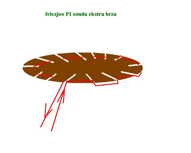

  • no felezjoo needs a specific coil, wrong coil is not useable for discrimination
      Oh..thanks for correction.
      What are the SPECS for the correct felezjoo coil to discriminate?
      • coil should be spider with auto delay 20s
        • Size of spider coil ?

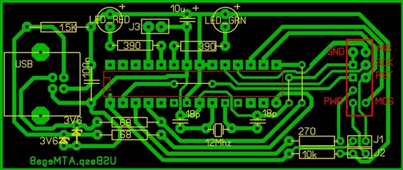

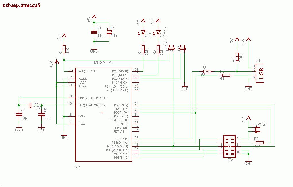

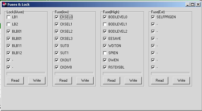

            USBASP.rar

Name:	felejo sonda.JPG
              • Usbasp is a good programmer for Atmega but people need to know that Usbasp made in China come with old firmware this firmware is not working because you cant change the clock by using avrdude in command line we already mentioned this problem and there is a lot of web site talking about this issue the web master of arduino stm32 made a video and a page to solve this problem you need a arduino to use it like programmer and update the Usbasp
                • Can make a plan here with steps how to connect ardruino and atmega328p to program. Thanks

                    • hi i need help to make a coil for felezjoo i always get coil error. how to make a good one?
                      • Any help .When start without connect coil says coil error why?
                        • did you try with a coil?
                          • i try with coil the same coil error last coil i made coil 368uh 1.1ohm, what to do now ?

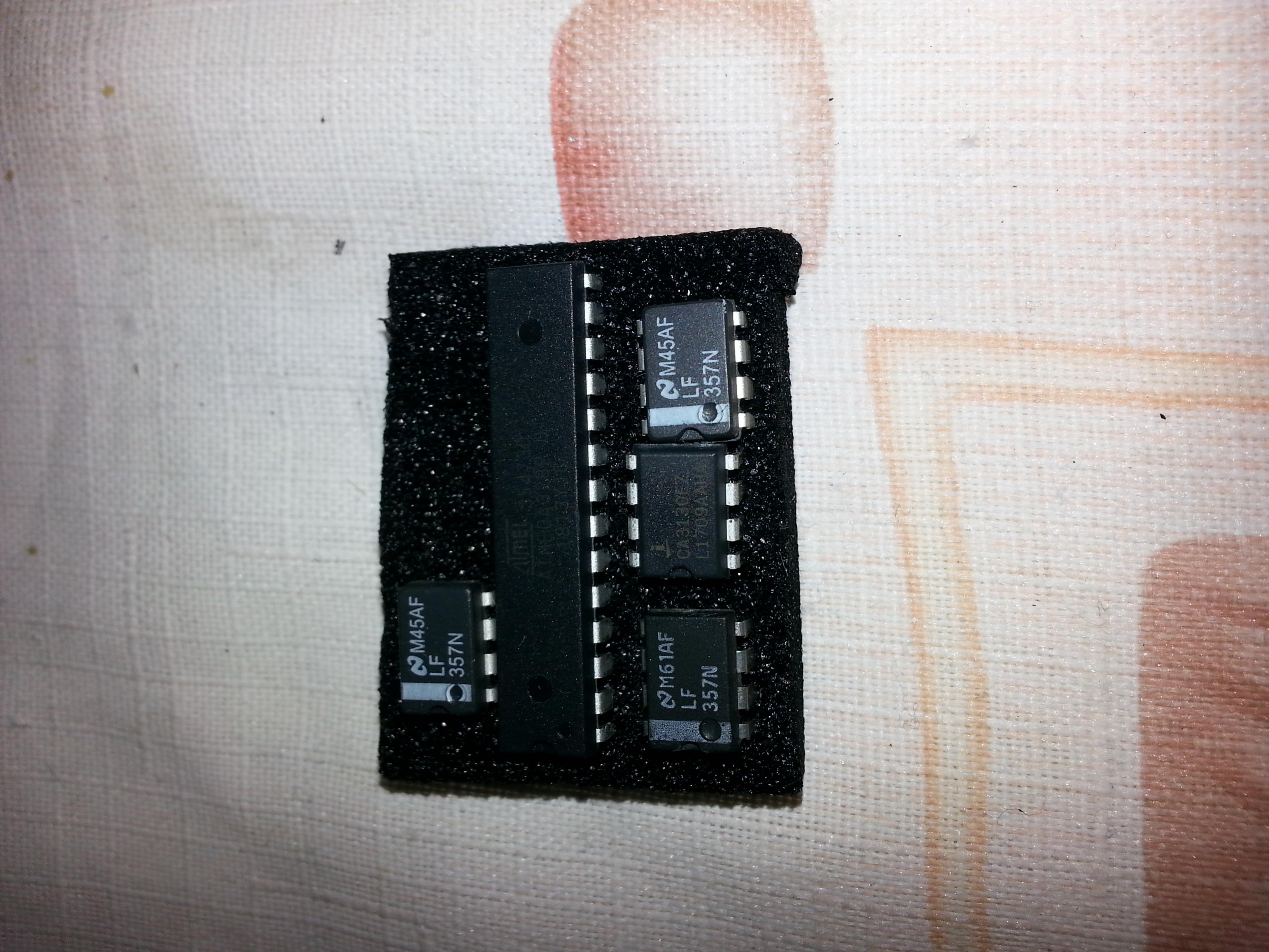

                            • Op amp seems to be a fake it cuase error coil
ID:	352320Click image for larger version
ID:	352320 I use the three of this allways say coil error and without lf357n empty say coil error , what to do?
