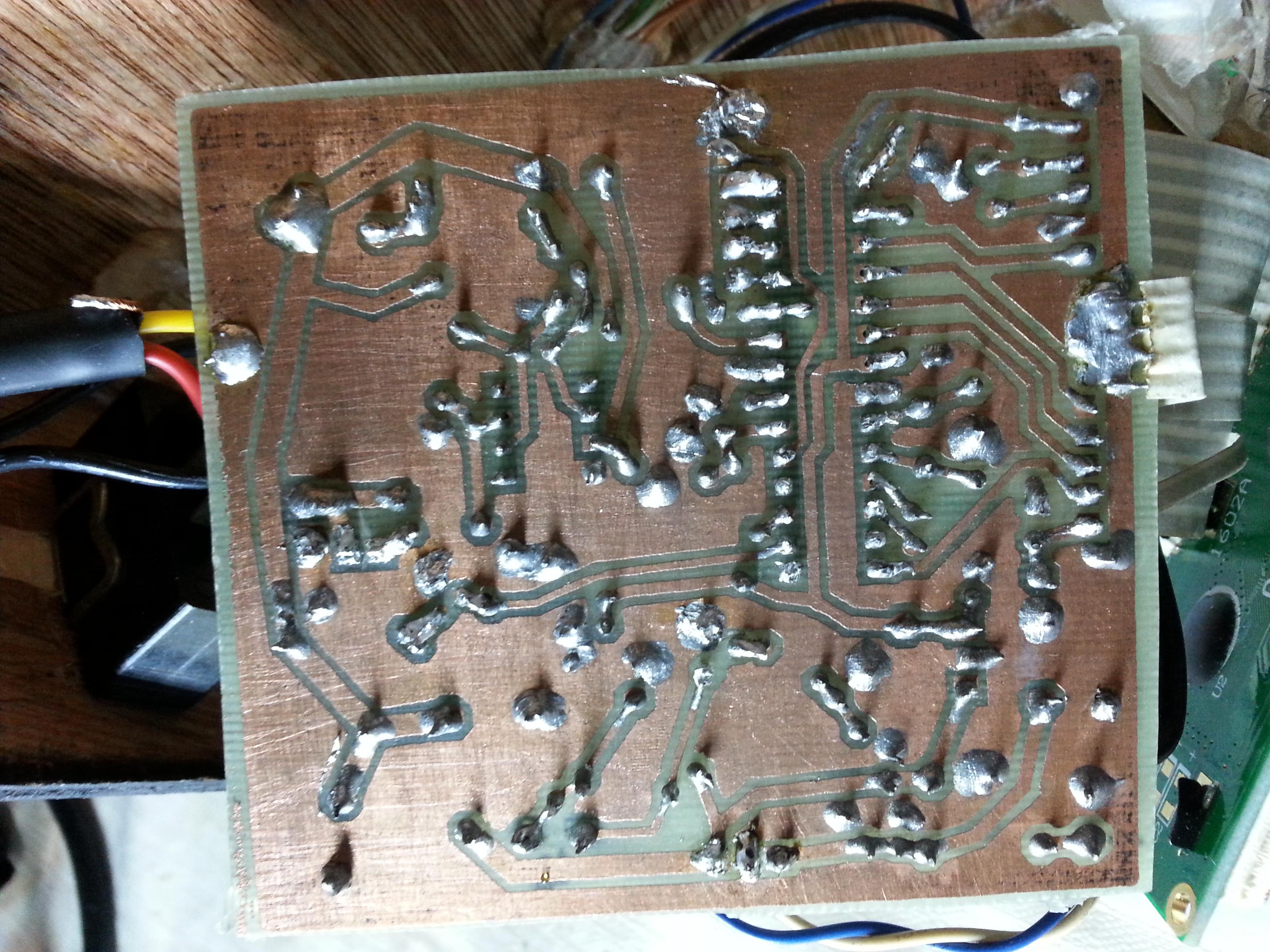

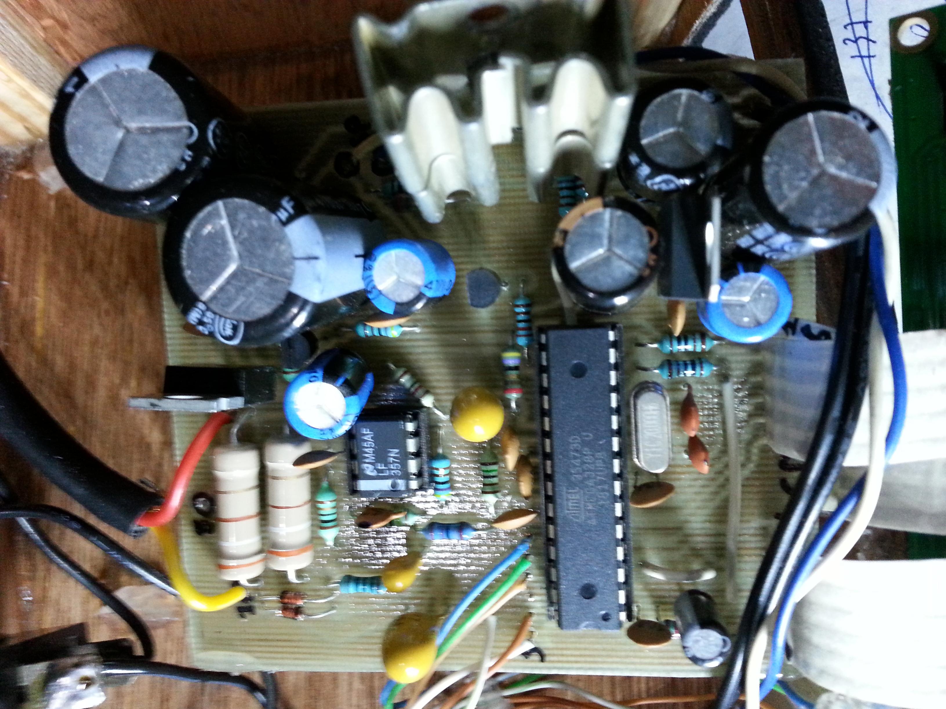

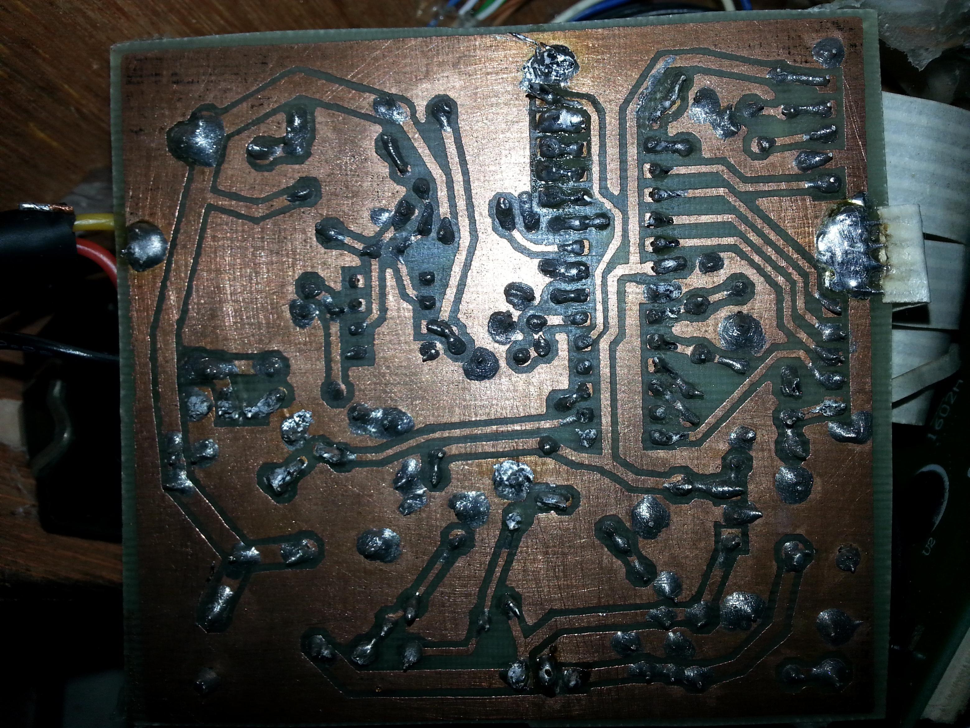

  • hi thanks for help all, here some photo Click image for larger version
ID:	352346Click image for larger version
ID:	352347Click image for larger version
ID:	352348Click image for larger version
ID:	352349 and some in the post #1803 thanks.

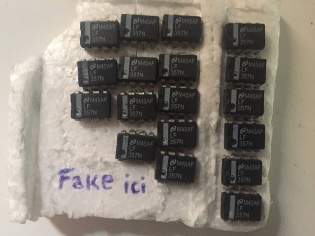

    • Originally posted by Kostasp View Post
      hi thanks for help all, here some photo [ATTACH]44372[/ATTACH][ATTACH]44373[/ATTACH][ATTACH]44374[/ATTACH][ATTACH]44375[/ATTACH] and some in the post #1803 thanks.

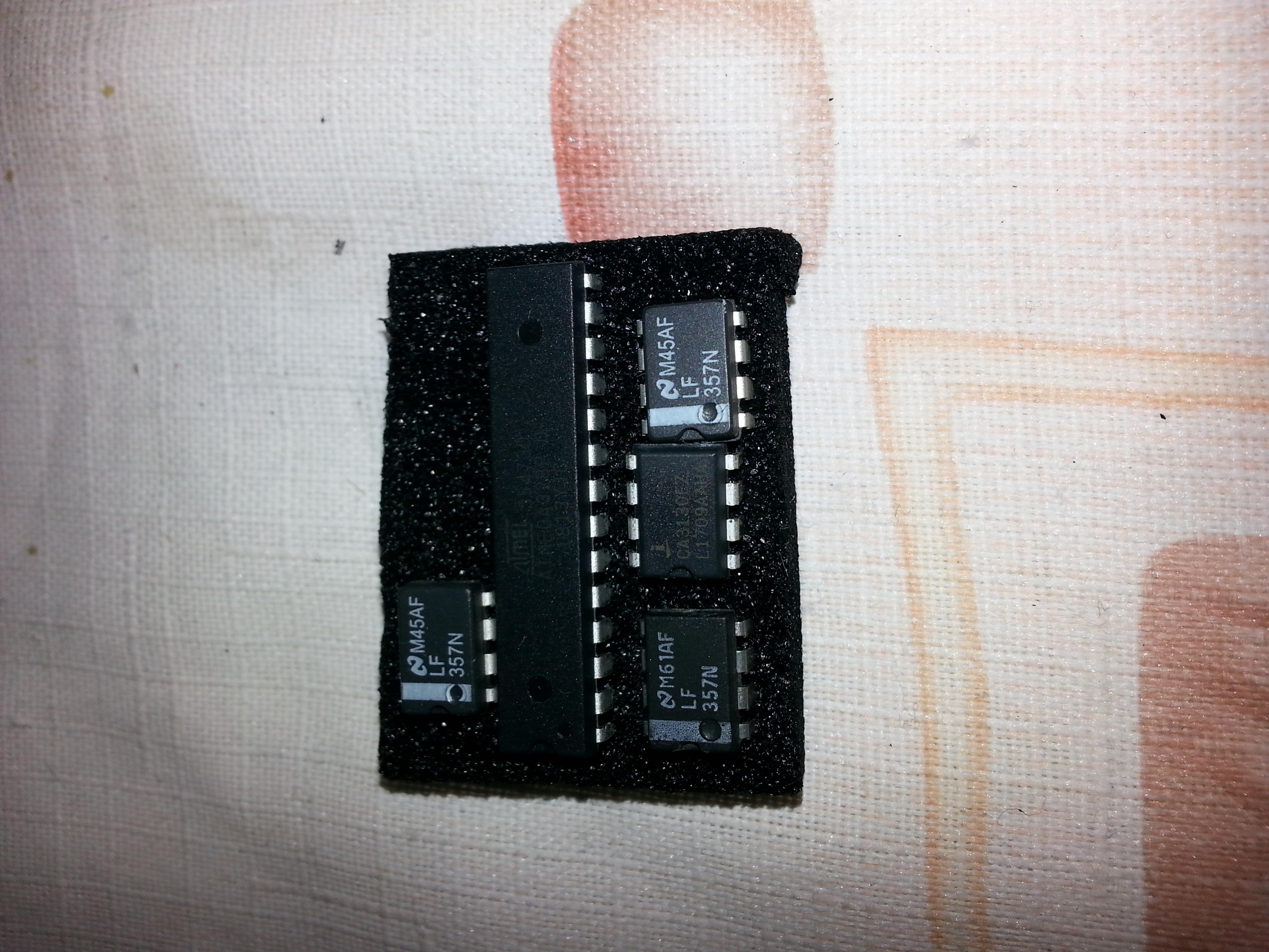

      your ici lf357n not original
      I tried this version of ici (m54af LF357N) is fake ici . Coming from China or singapor
      try lf356 or tl081 To test the device initially you get an original piece

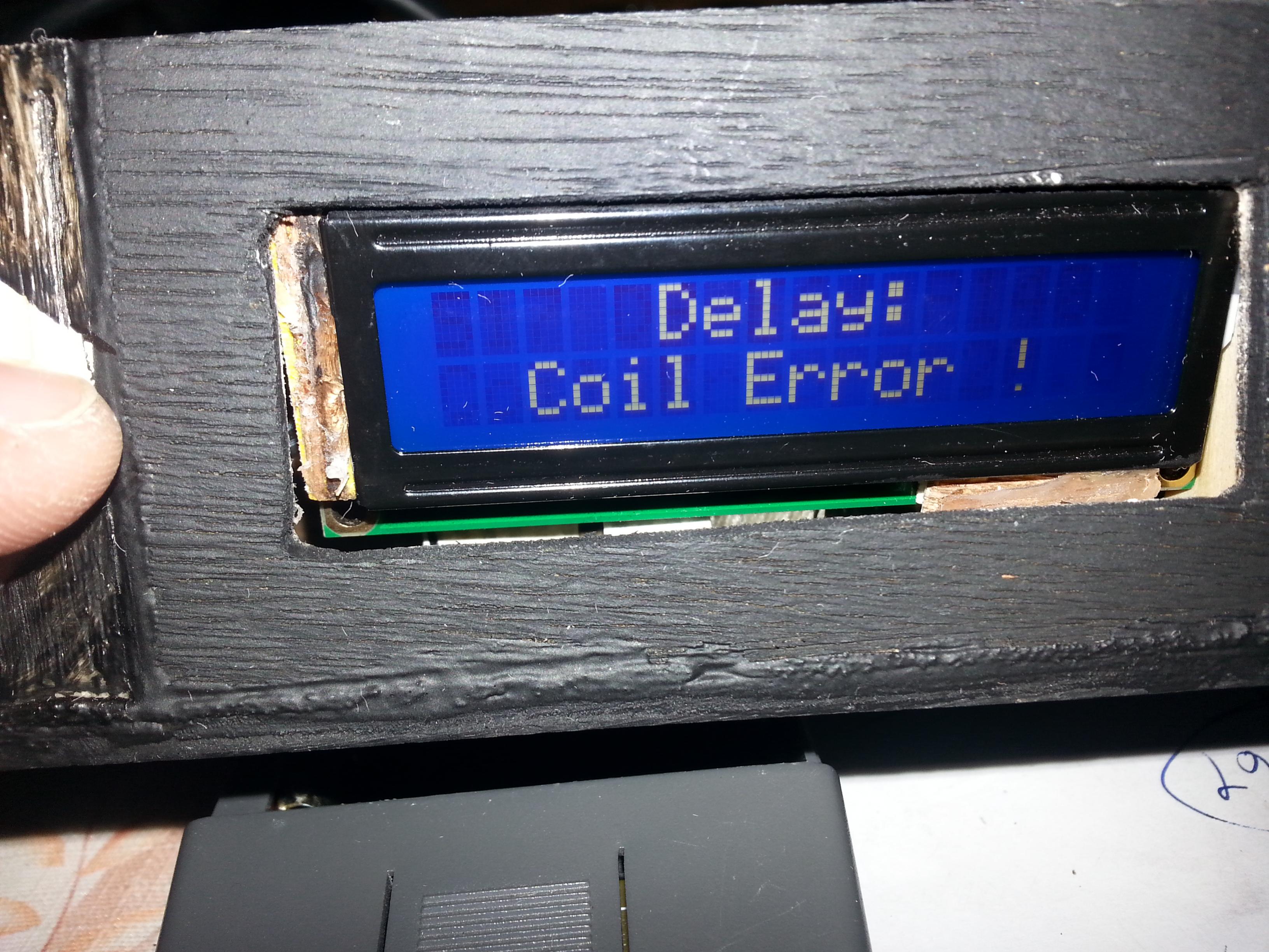

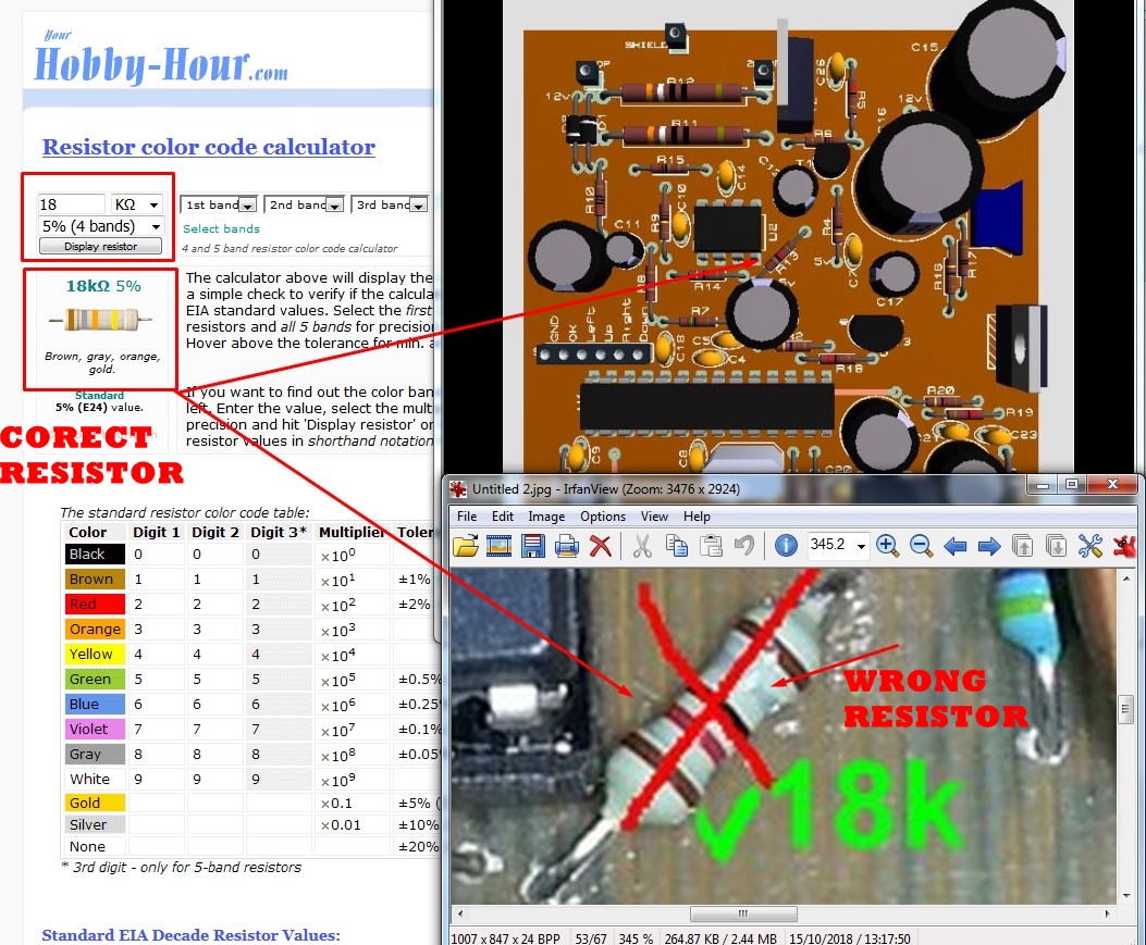

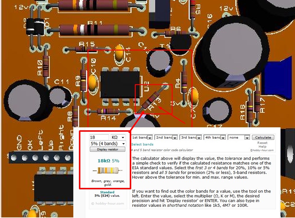

        • i have try and m61af lf357n its face and this?Click image for larger version
ID:	352351 i have try all this and ca3130 , and with out lf357 steel works and says error coil
            18kho not 12ohm
            • thanks i look tomorow and ia will tell you if i have any change.
              • Originally posted by karim1980 View Post
                [ATTACH]44376[/ATTACH]
                Sticking them in polystyrene isn't going to help either!
                Static electricity will kill ICs, or at least weaken them so that they die later.

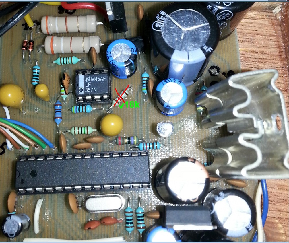

                • you always can sort any opamp on state work-burnt by special tester.

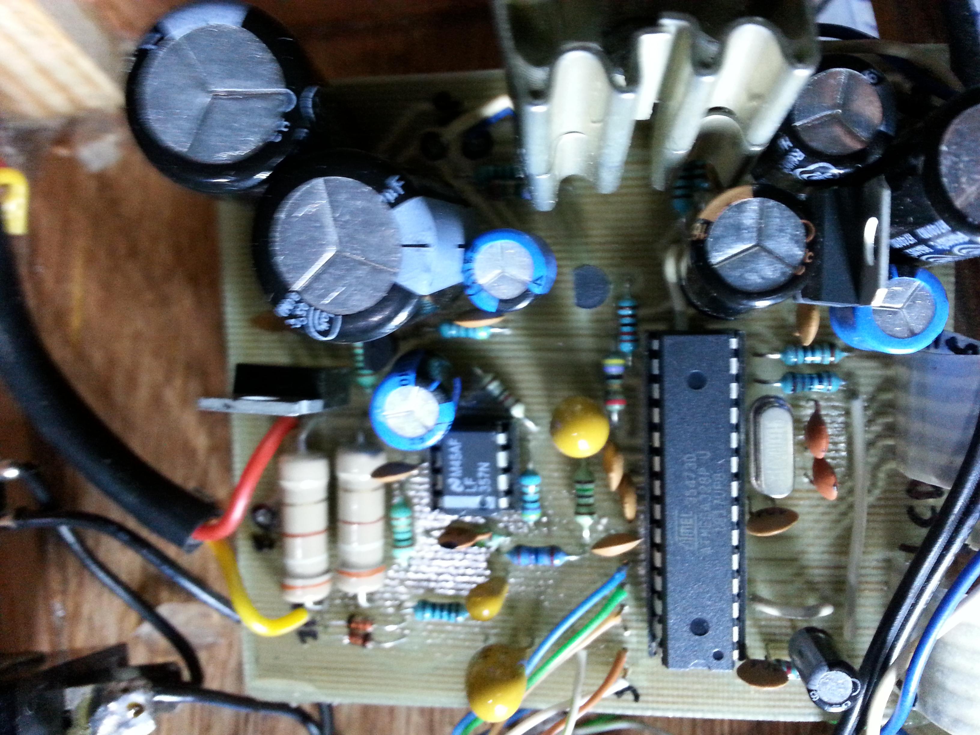

                  i have try and m61af lf357n its face and this?[ATTACH]44377[/ATTACH] i have try all this and ca3130 , and with out lf357 steel works and says error coil
ID:	352355 Click image for larger version
ID:	352356 Click image for larger version
                    LOOK MY PHOTO Kostasp

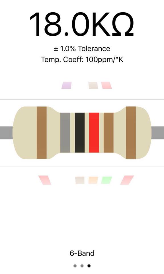

ID:	352365 the resistor is 18k then its ok
ID:	352366 when I press button up but this message is for every coil I connect

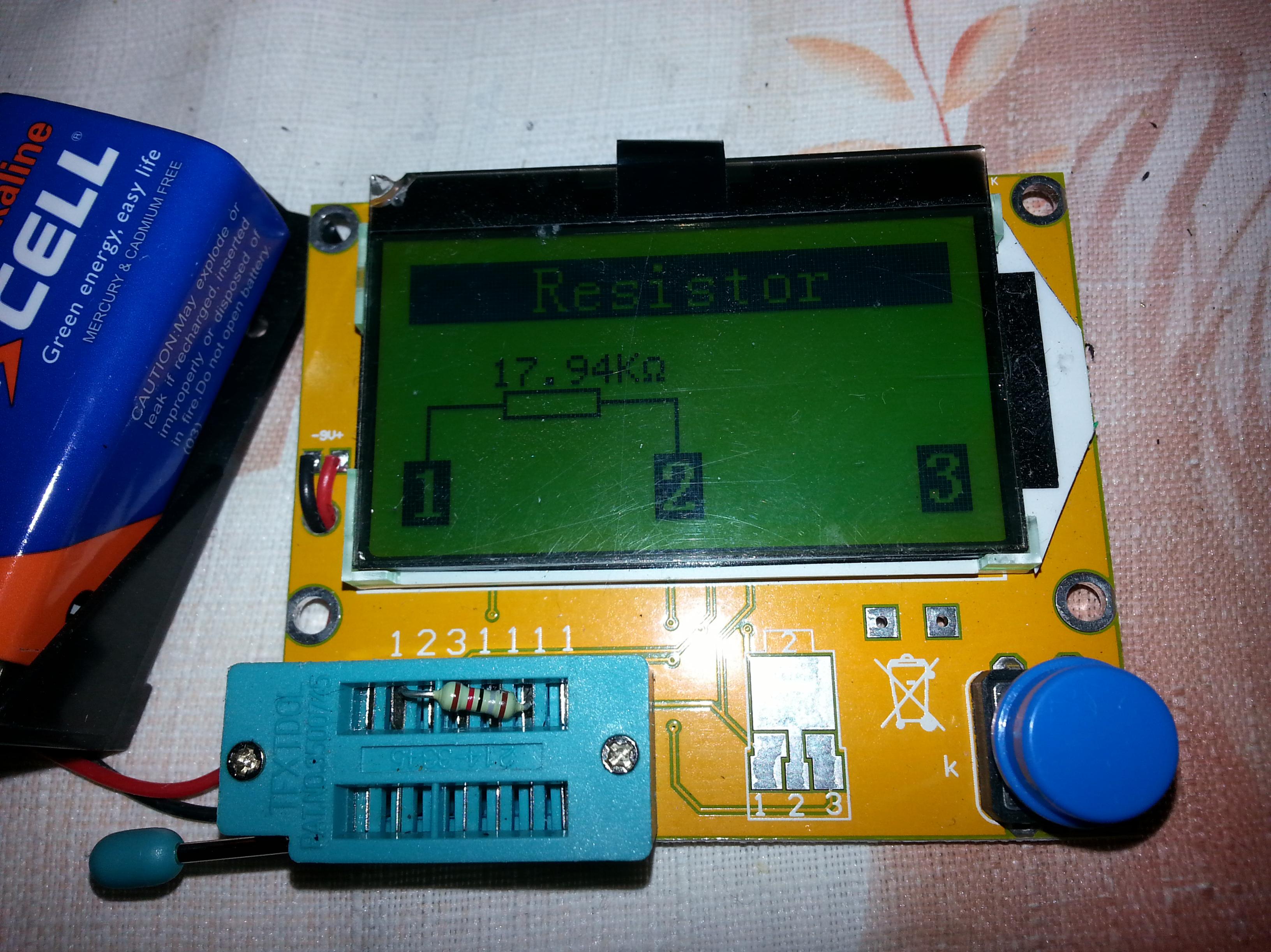

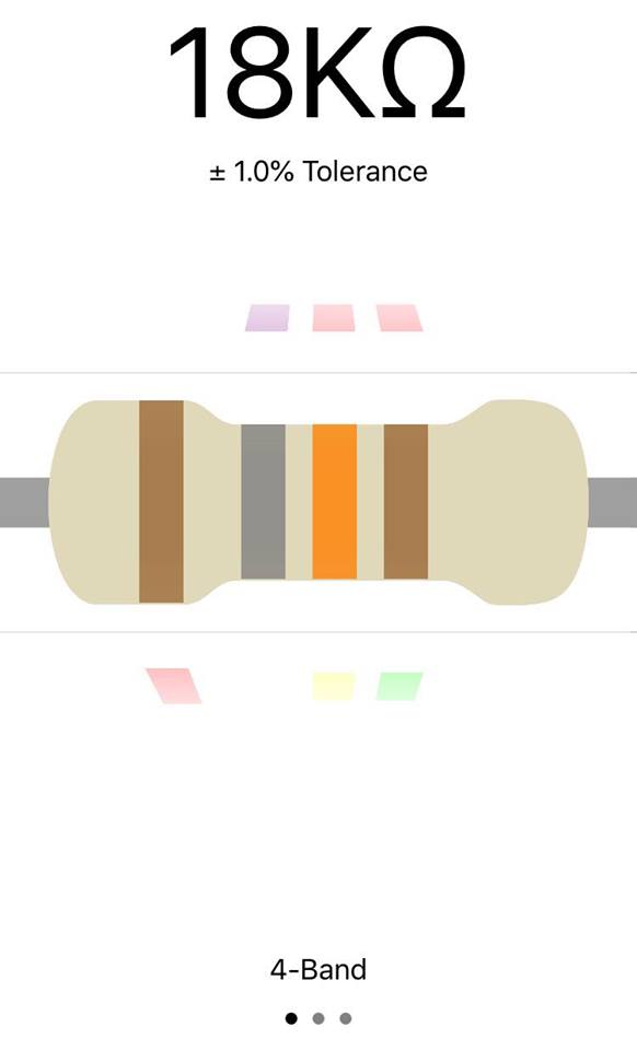

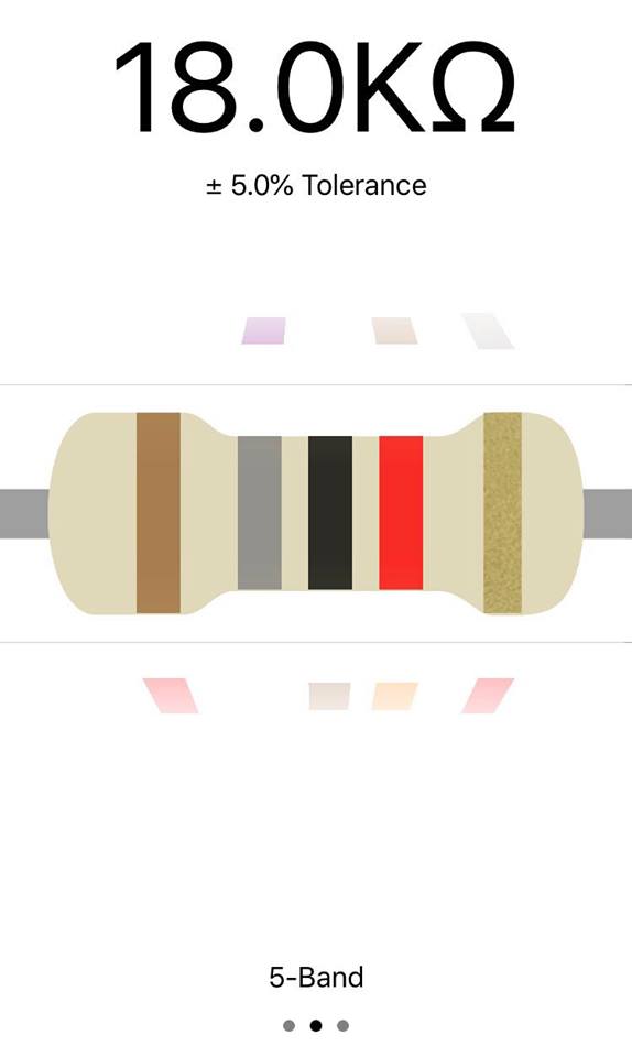

                            [ATTACH]44401[/ATTACH] the resistor is 18k then its ok
ID:	352367Click image for larger version
ID:	352368Click image for larger version

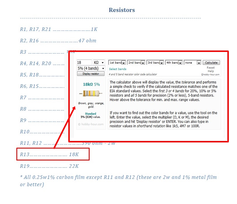

                            • it is 18k 1%
                              • and an other multimeter says 18k and from internet Resistor Color Code Calculator.pdf
