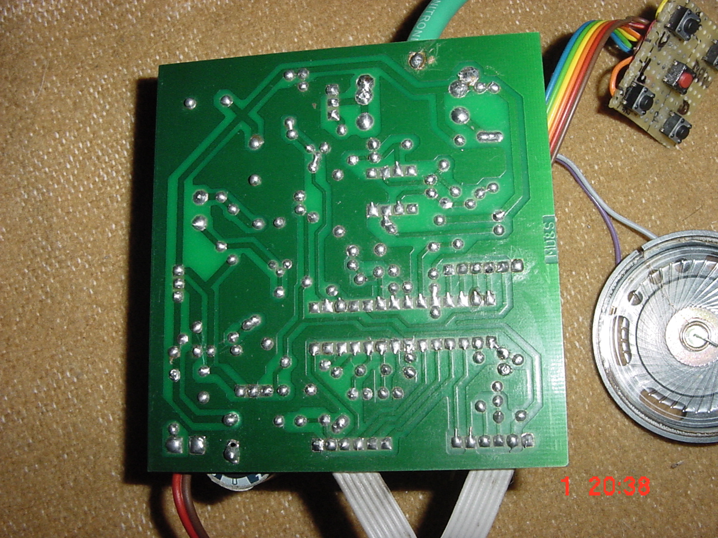

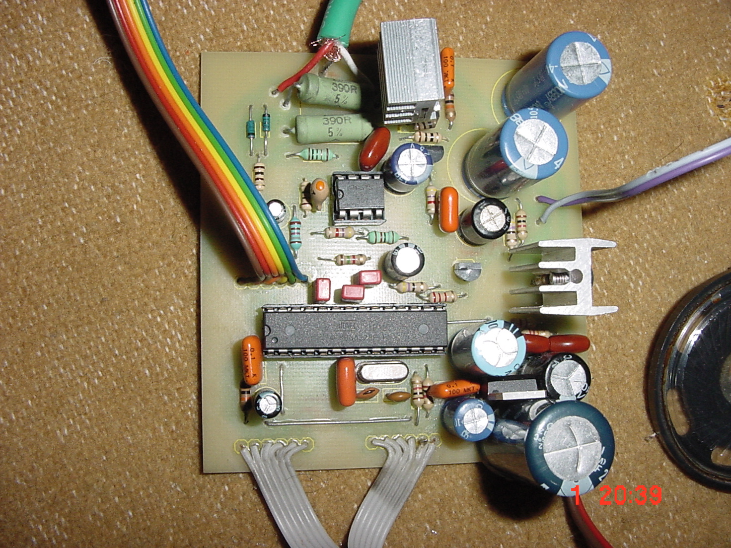

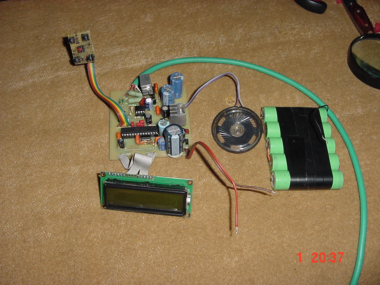

            • I did Felejzo ver. 3.25 but my L7812 is hot and IRF840 is a lot. The coil is 1,05ohm and 342uh and when I turn on the detector on the screen it shows error coil code 18,2.
              What could be a problem?
              Thank you.

                • replace bs 170
                  • I changed the BS170 as well as IRf 840 and L7812 from various manufacturers, I put them on refrigerators, the LF357 I tried and metallic, I replaced all 100nf placed ceramic, made a second coil, but still heated the IRF840 and L7812.
                    I checked all the bubbles and now I do not know what else could be.
                    • this problem from failer of bs 170 or electrolic cabaceters or short in line can you uploud a photo to your board

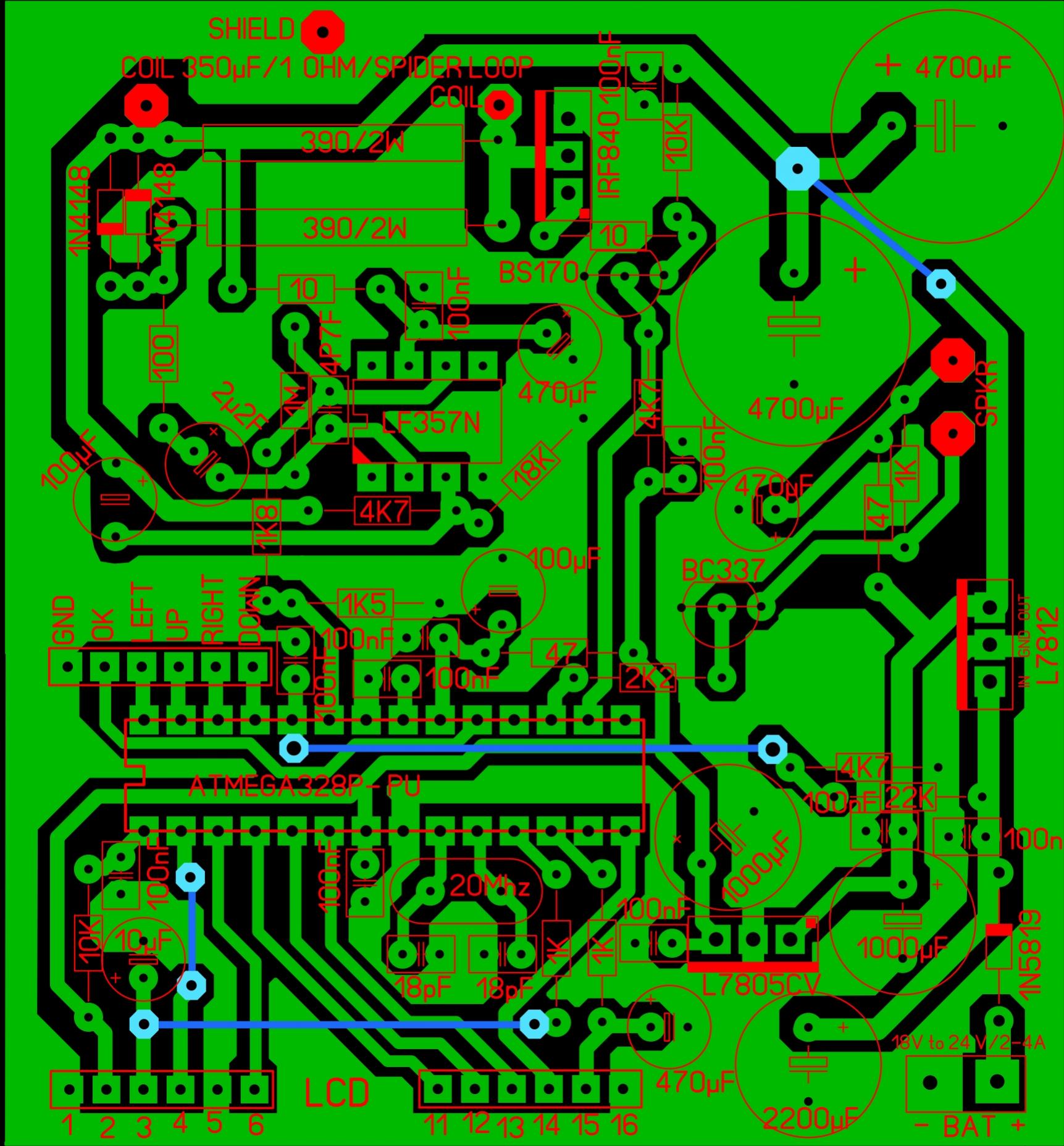

                      • My PCB is like this:
Name:	pcb sprint.jpg
                        Does the armor have to be on the winding?
                        • this pcb no prblem with it just take a bicture to your board
                          • My PCB
                            • remove heat sink on 840 meybe have a short and test around diod 48 its lock like a short yout cabaceters 100nano should be a ceramic and 2.2 and 100uf tantalom
                              • Originally posted by basellafe View Post
                                2,2UF and 100nf were tantalizing but I changed them because I read in one post that it can also electrolyte.
                                And the IRF 840 is heated even without a refrigerator.
                                The problem is with the winding, when I remove them everything is fine or maybe HEX is wrong, I'll try and replace it.
