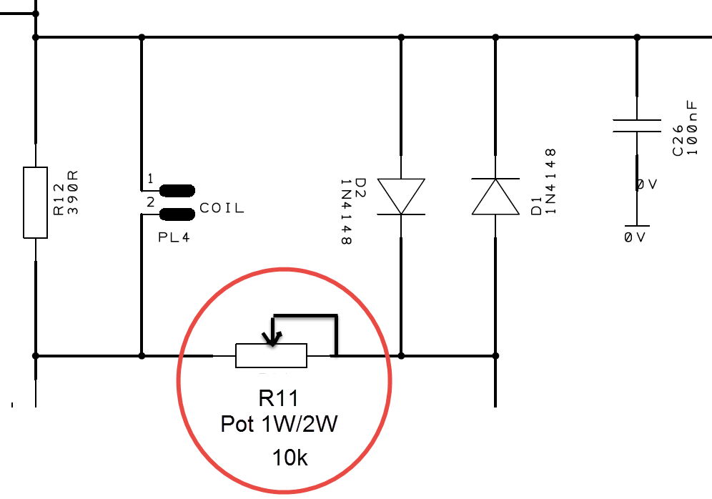

        Hello,
        I have added in series a pot 10k 2W with the resistor R11 390R;
        With adjusting this pot you can:
        - Use any NPN small signal instead of Mosfet BS170 (2n5551, BC548..........etc)
        - Fix Coil Error Message
        - Use any Amplifier as LF356, TL081..... instead of LF357
        - Change the super Value A B and C
        - Get the discrimination works correctly
        You can also use à Battery >14,5 to supply your FelezJoo by changing the resistor R20 from 4k7 to 5k1 or 6k8.
        • Hiya Ahcene2035,,,,On the Schematic that I have R20 = 10k. Thanks, Marty
          • The same Schematic but a different resistors numbing. Find in attached file the Resistor R20 4k7 (In your attached file is R12) to change 5k1 or 6k8.
            • @Ahcene2035,,Thanks, Marty
