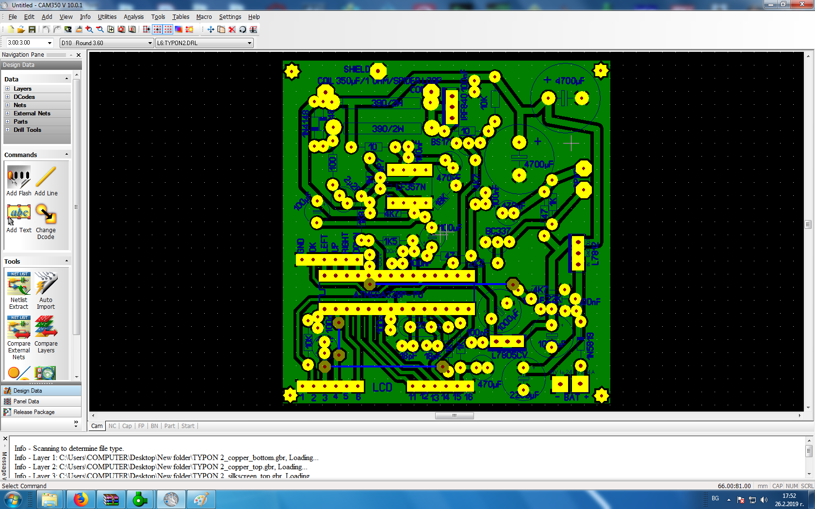

    if i do export, SL writes there are 5 holes in silk layer and thats impossible to do the file.
    These 5 points, are shown in the layer S1 field, but must be in C2. This is not fixed in the file I gave to Gandolfi. Gerber files are produced from the same not fixed file. The drill data too. I do not currently have CAM350 installed and I can not check where the Chinese problem is.
    I apply a new folder with fixed these 5 points and new gerber files. Open files with online gerber viewer do not indicate a problem.
    • I installed the CAM350. This is how the circuit board looks like with a professional PCB program
      • Gandolfi,
        If the Chinese do not solve the problem send me your address I will make a PCB in the home and I will send it to you. It will not cost you anything.
        • the chinese says " Hi Sir, Thanks for your e-mail ,so sorry for that my colleague send the incorrect reason why we cancel your order . It's because there is no outline layer for your file , so we cancel your order and refund to you . Could you kindly to check your file about the outline layer ?"
          How i can resolve this ?
          thanks
          • this company takes any CAD files and does without gerbers http://wonderfulpcb.com/
            • Hello
              a square needed around drawing for board outline
              try attachment file
              • hi, i have send your file samii. i'm waiting the audit.
                For the other file from Toros chinese says "Hi, so sorry for that we cannot make the board for you since there is no board outline in the file. Could you please fix and reupload the correct file ? Thanks~"
                • THANKS SAMII !!!! The pcb is approved and in production. And thanks Toros and kt315 for your help.
