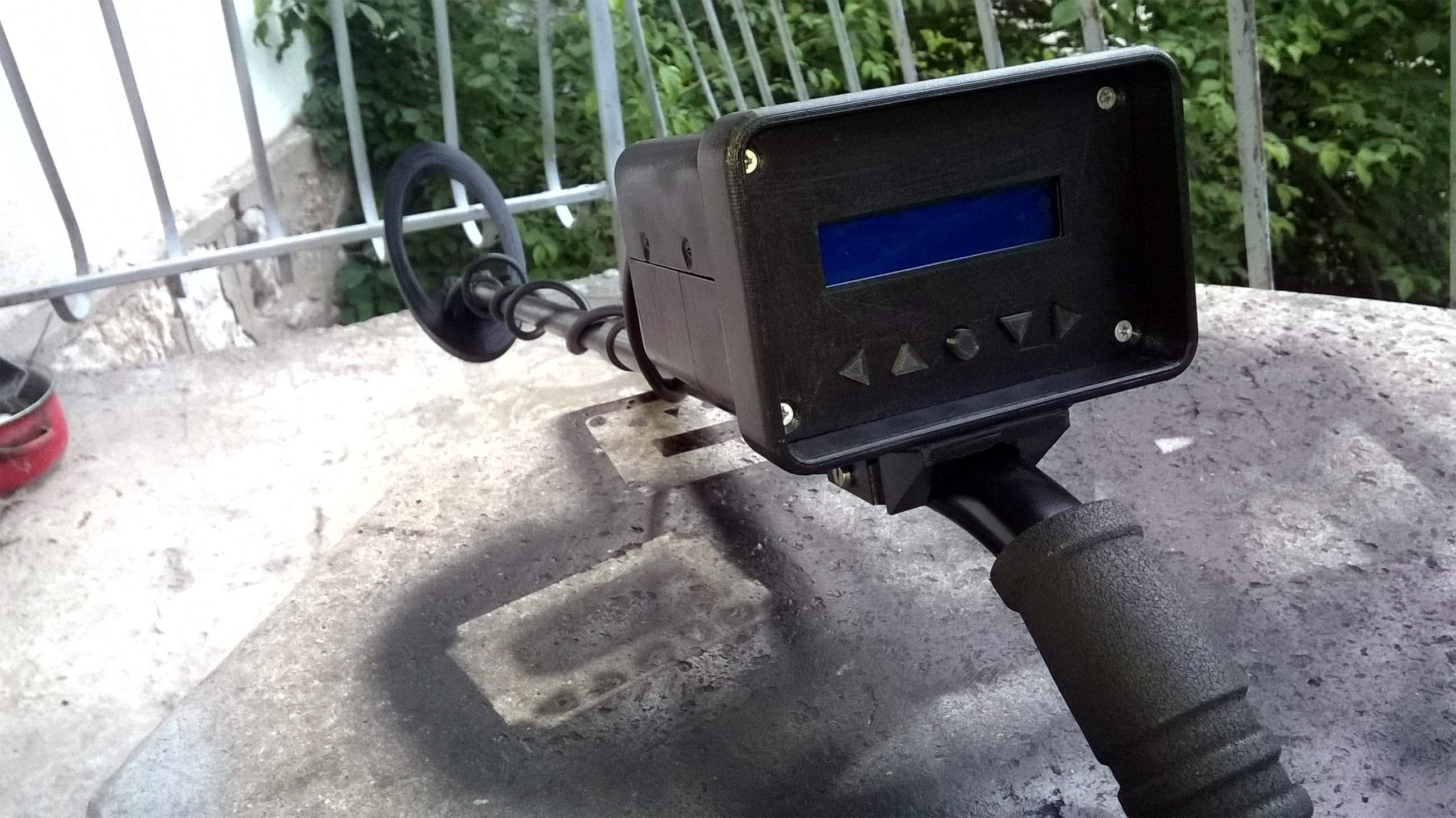

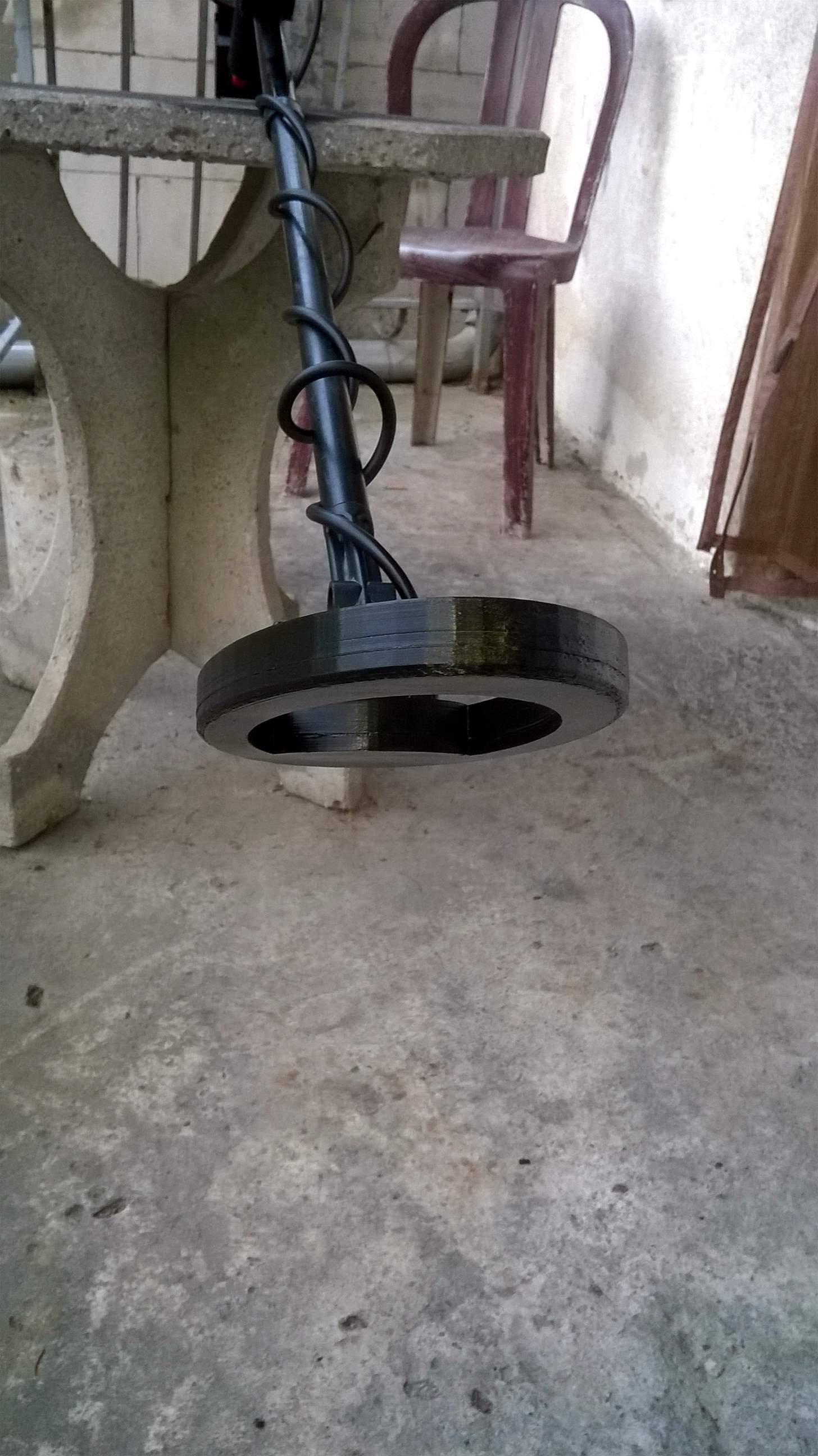

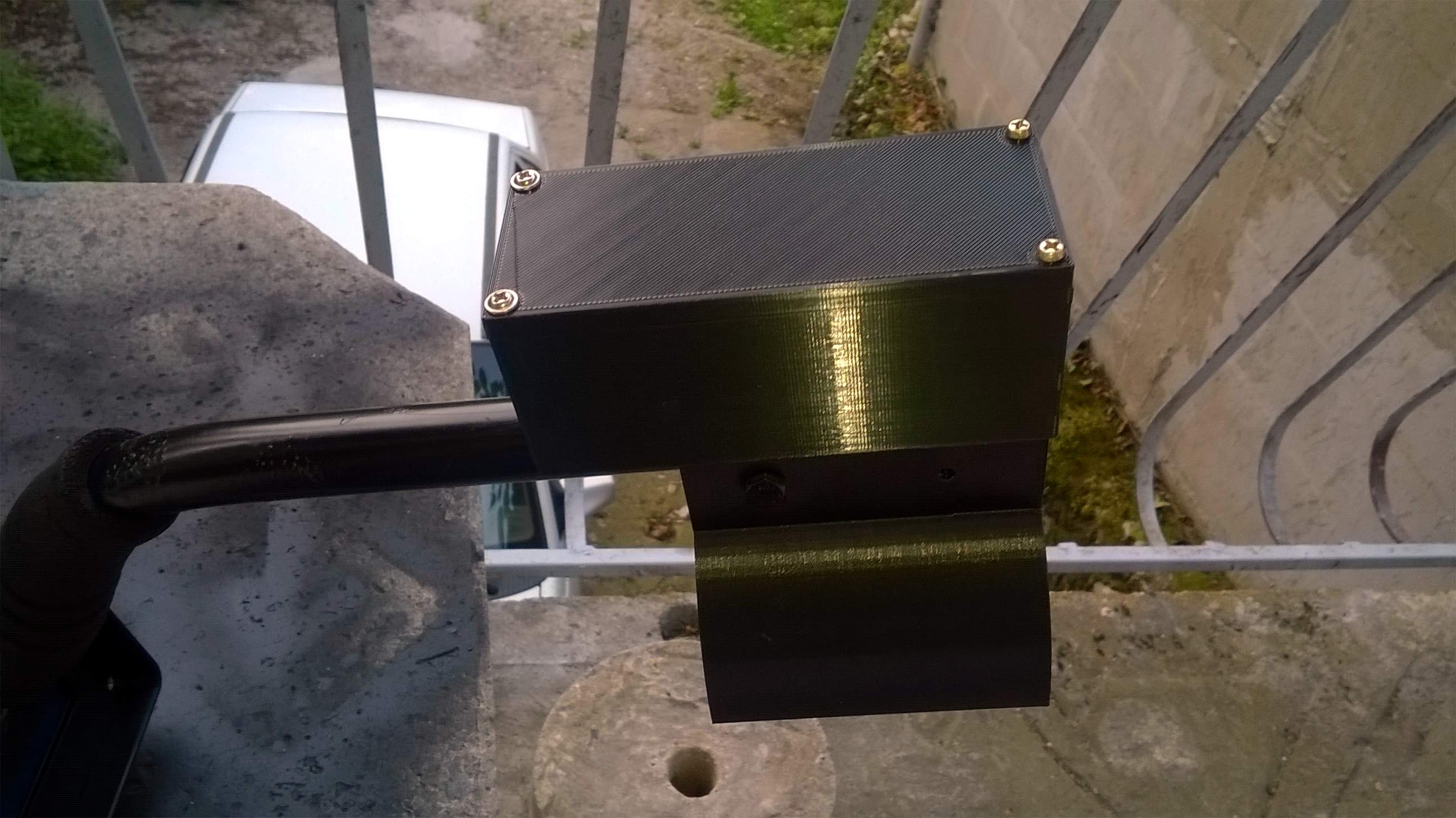

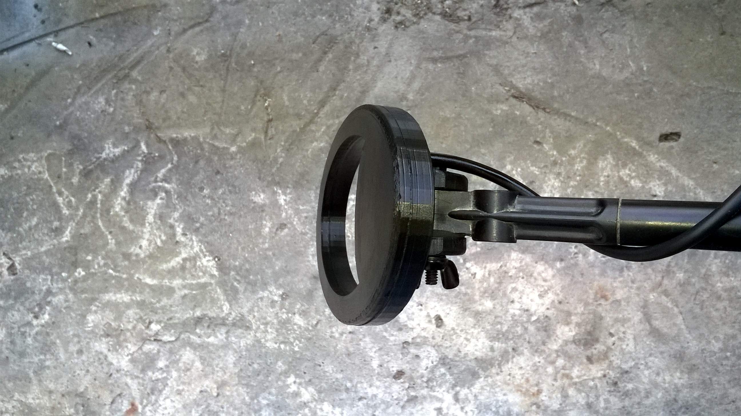

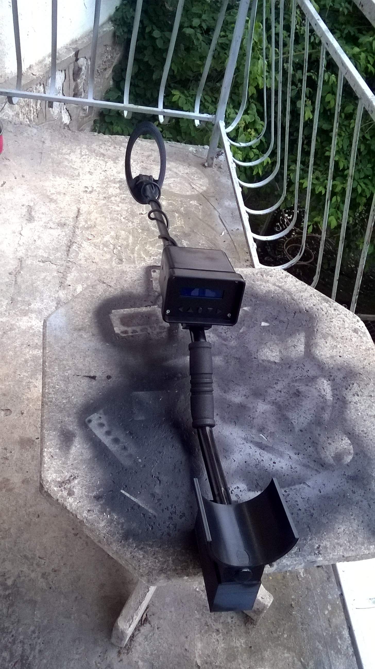

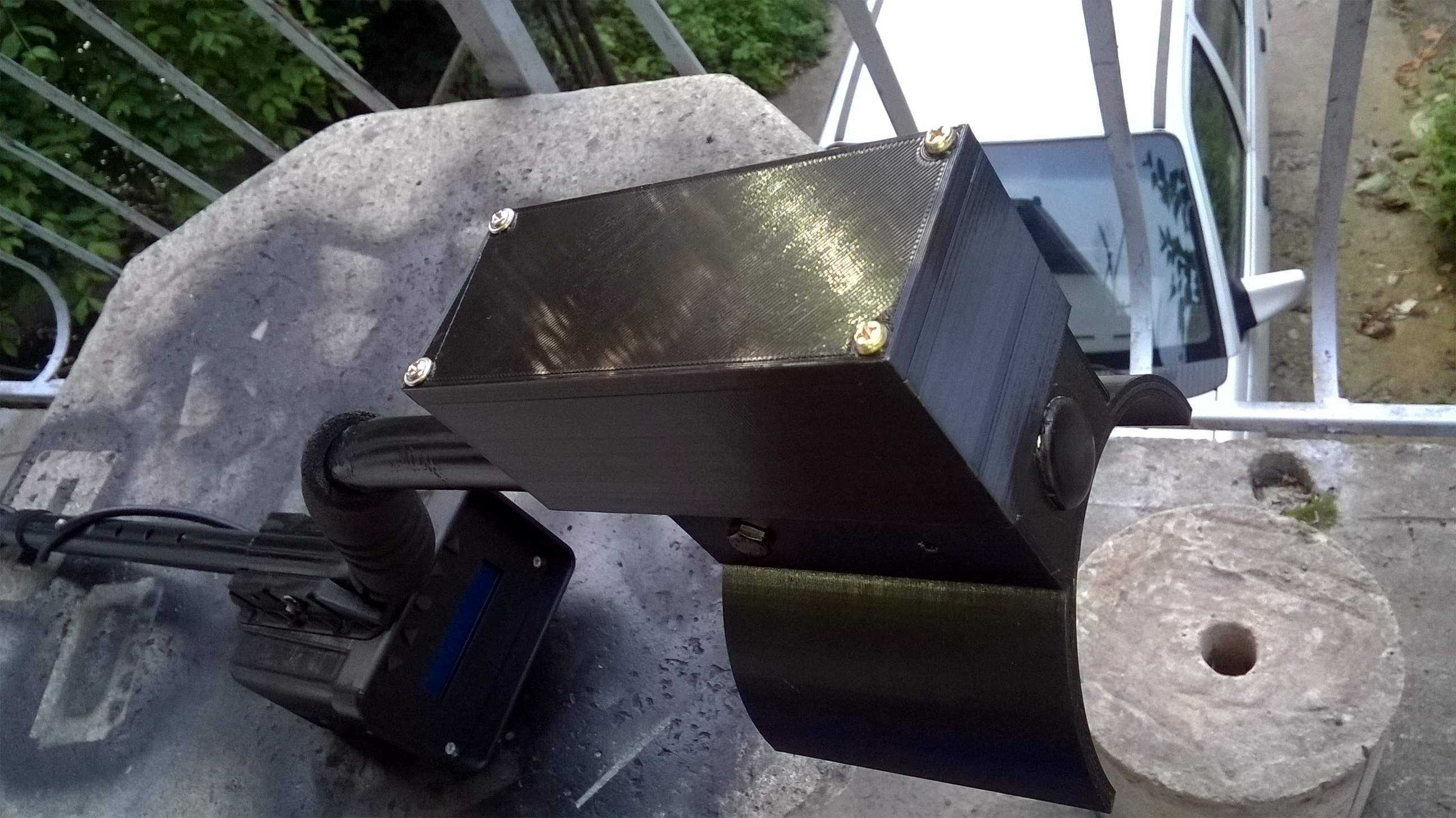

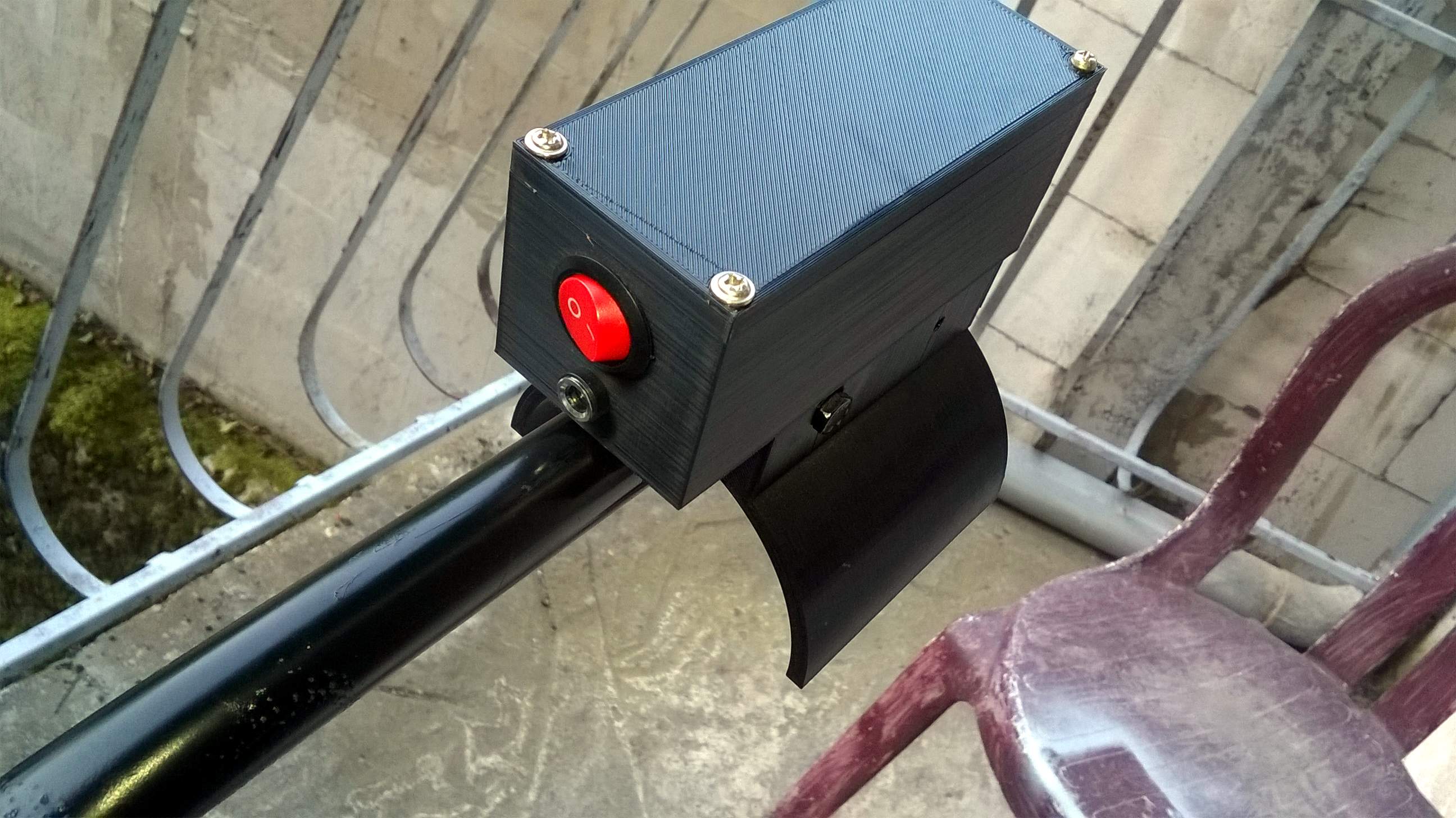

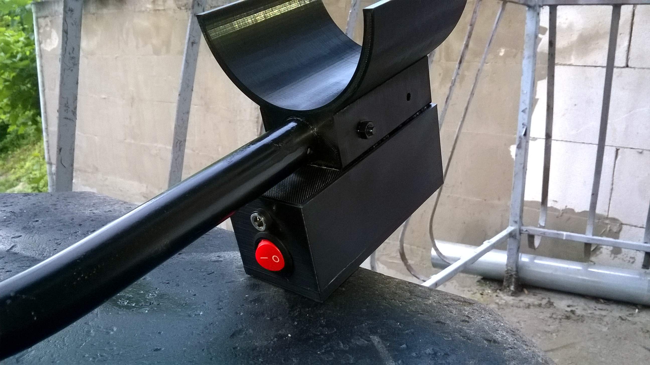

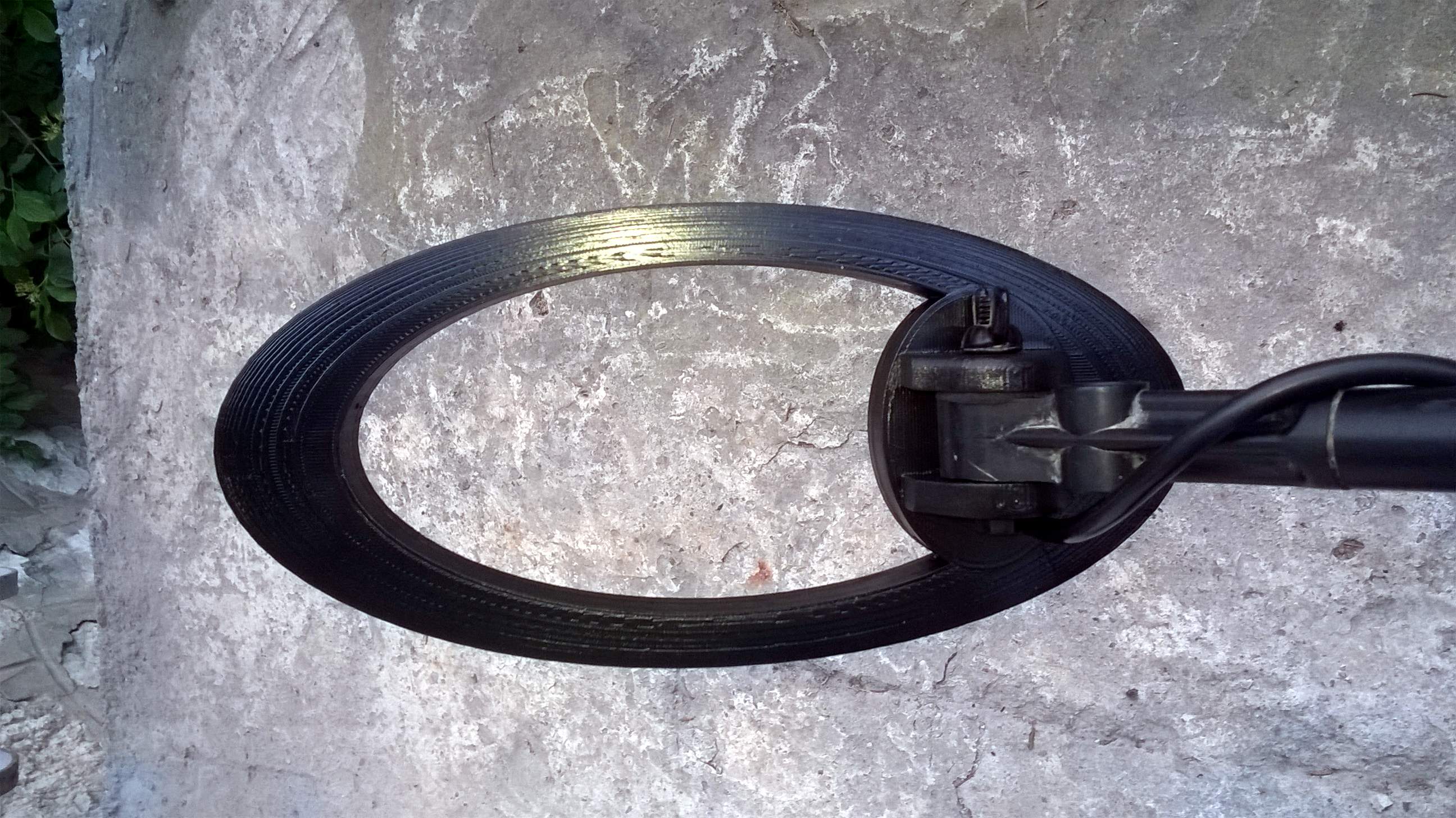

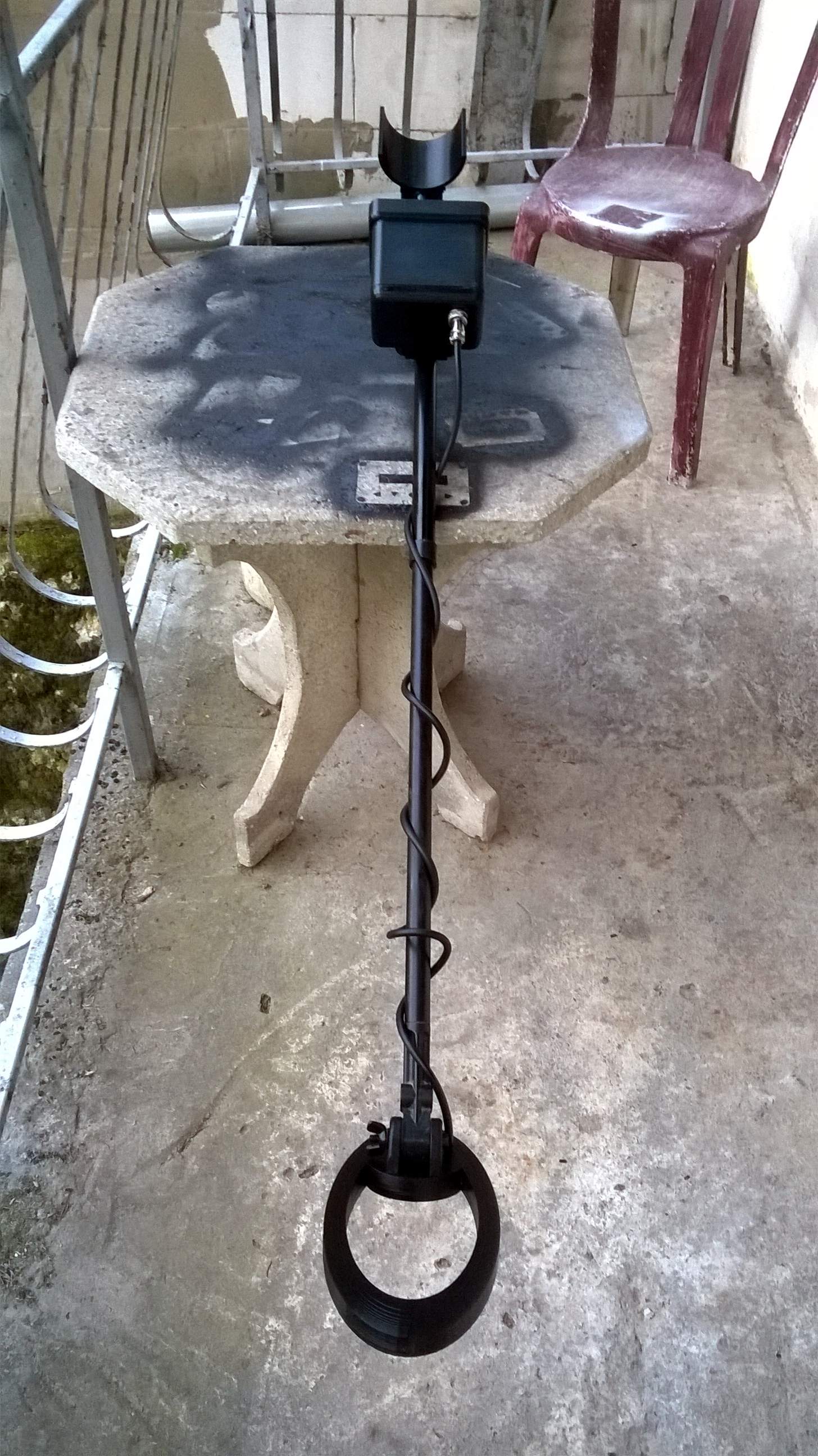

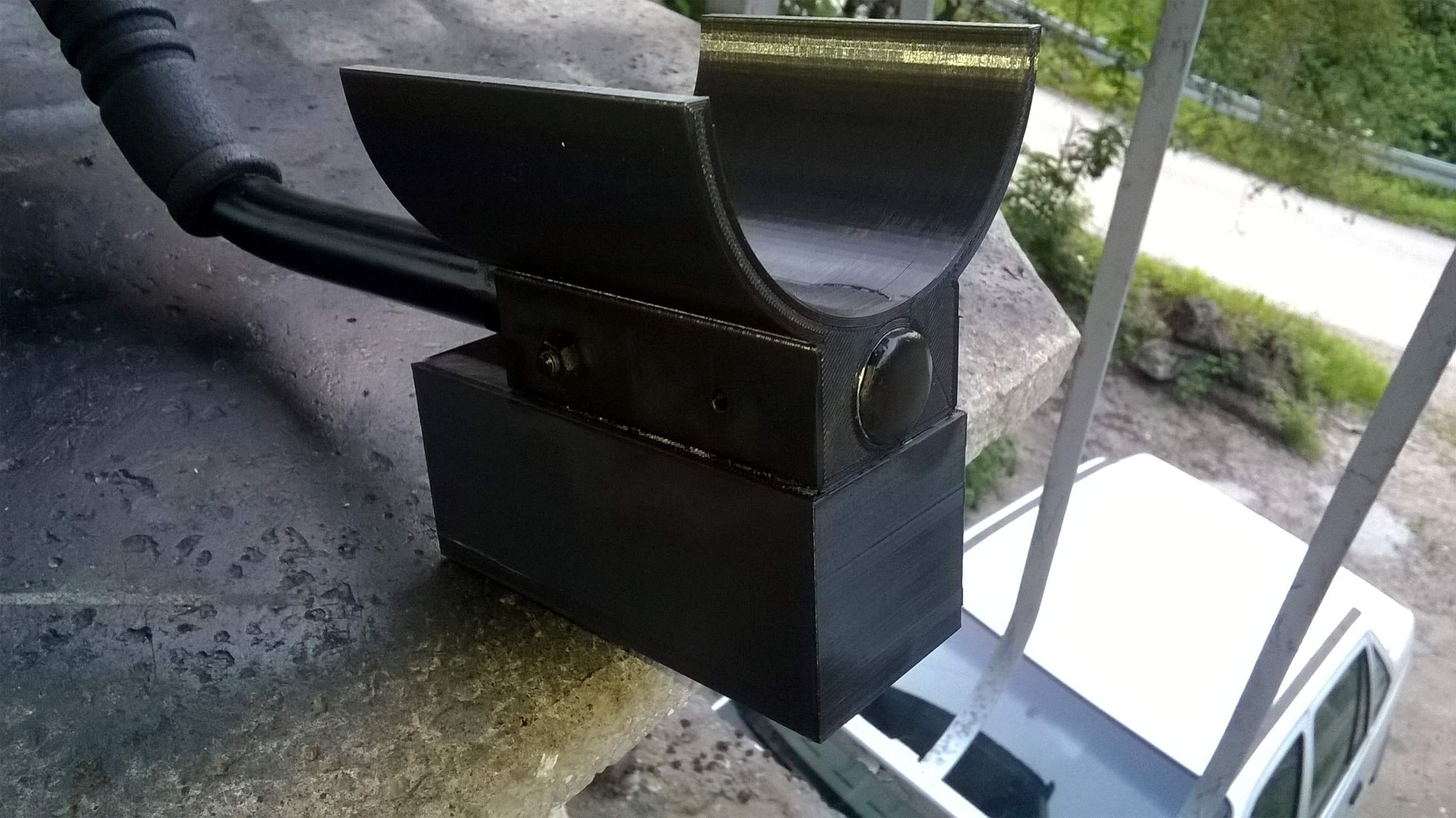

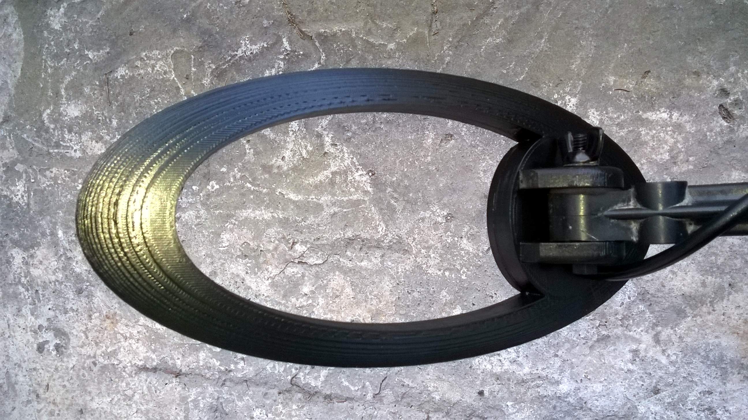

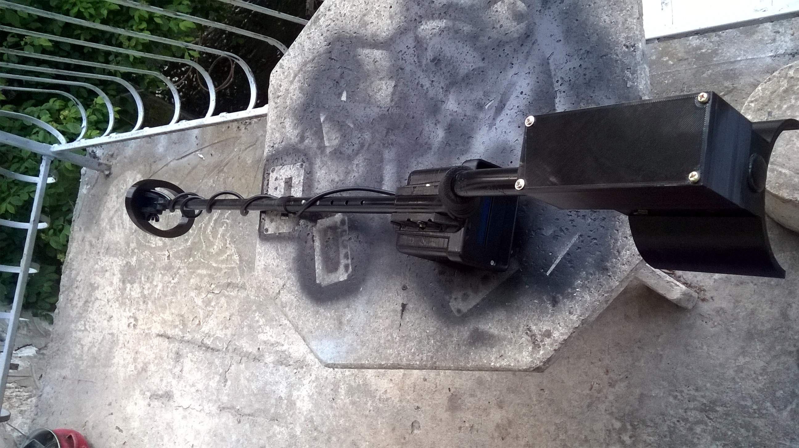

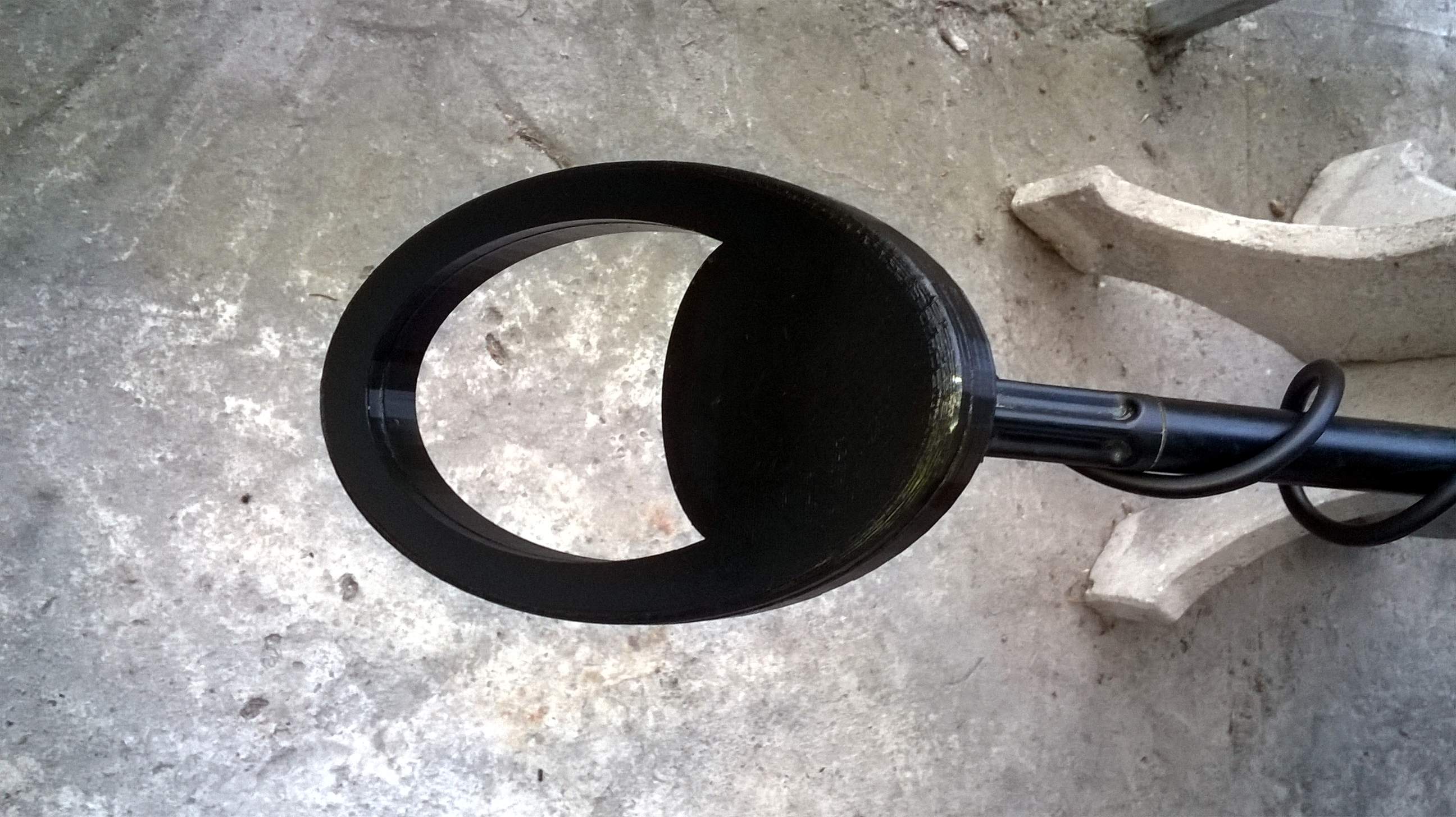

        • After a while i made another one. For fun. And for real searching with it, of course!
          This time i decided to make smallest as practical coil.
          It is 24x11cm coil. Works like hell good!
          Disc and GEB perfect.
          Don't ask me about details, all the details are already present here on topic.
          No other extra details.
          Some parts are 3D printed. Ultra lightweight! That's what i prefer.
          Inside the battery pack; BMS + 4x18650.
          Thats all.

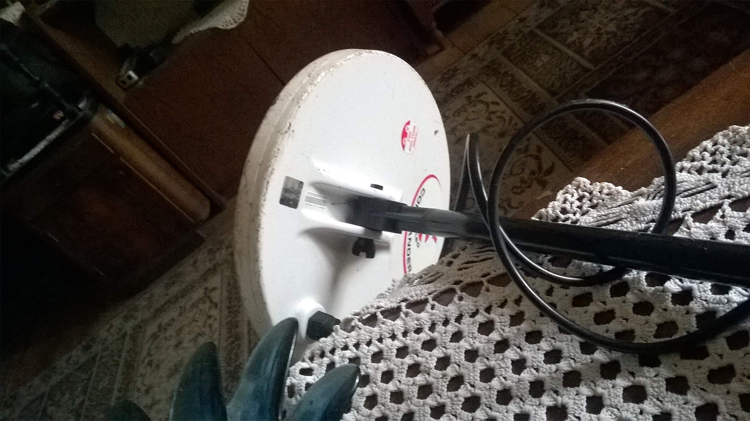

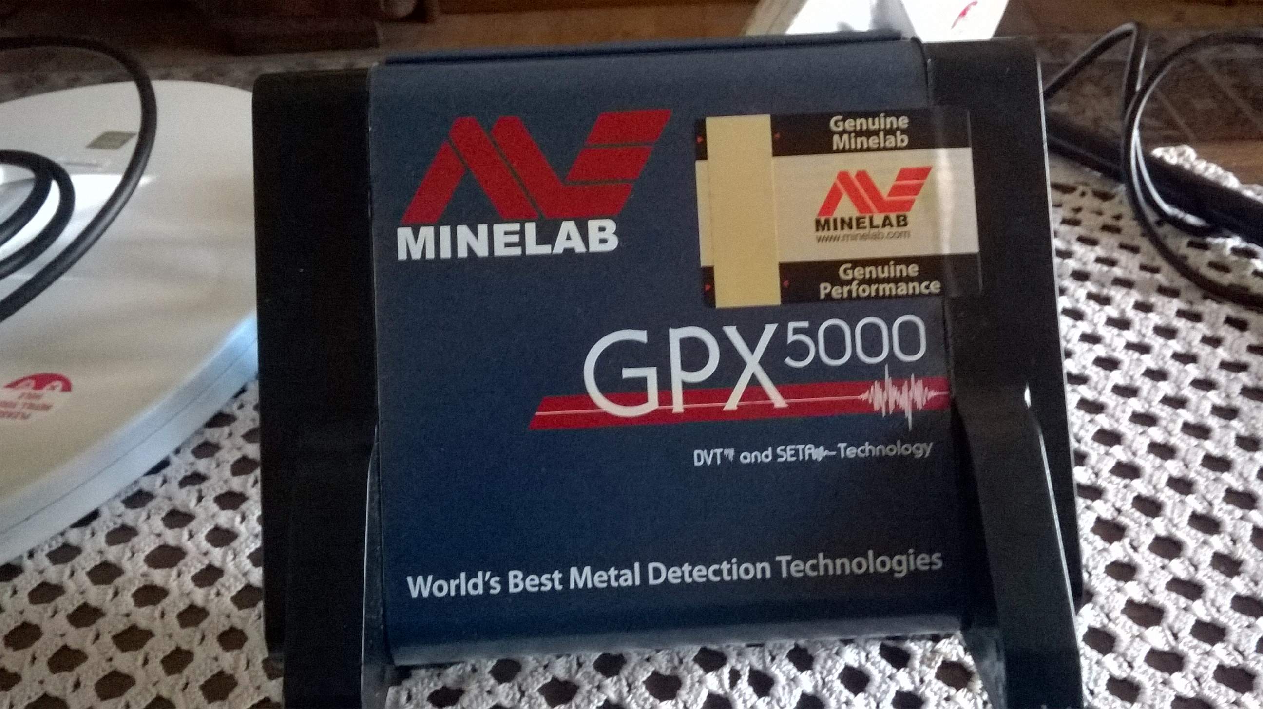

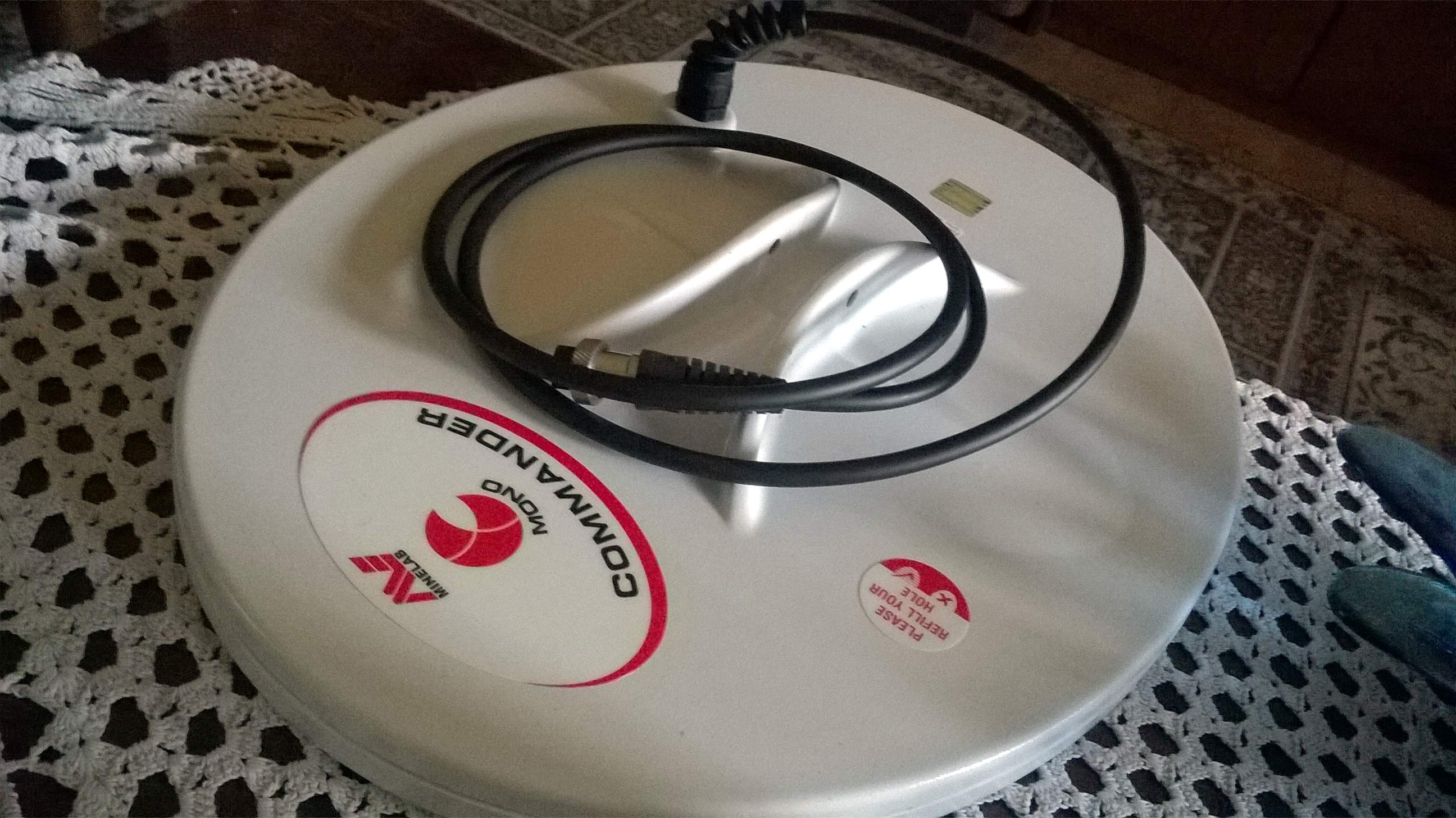

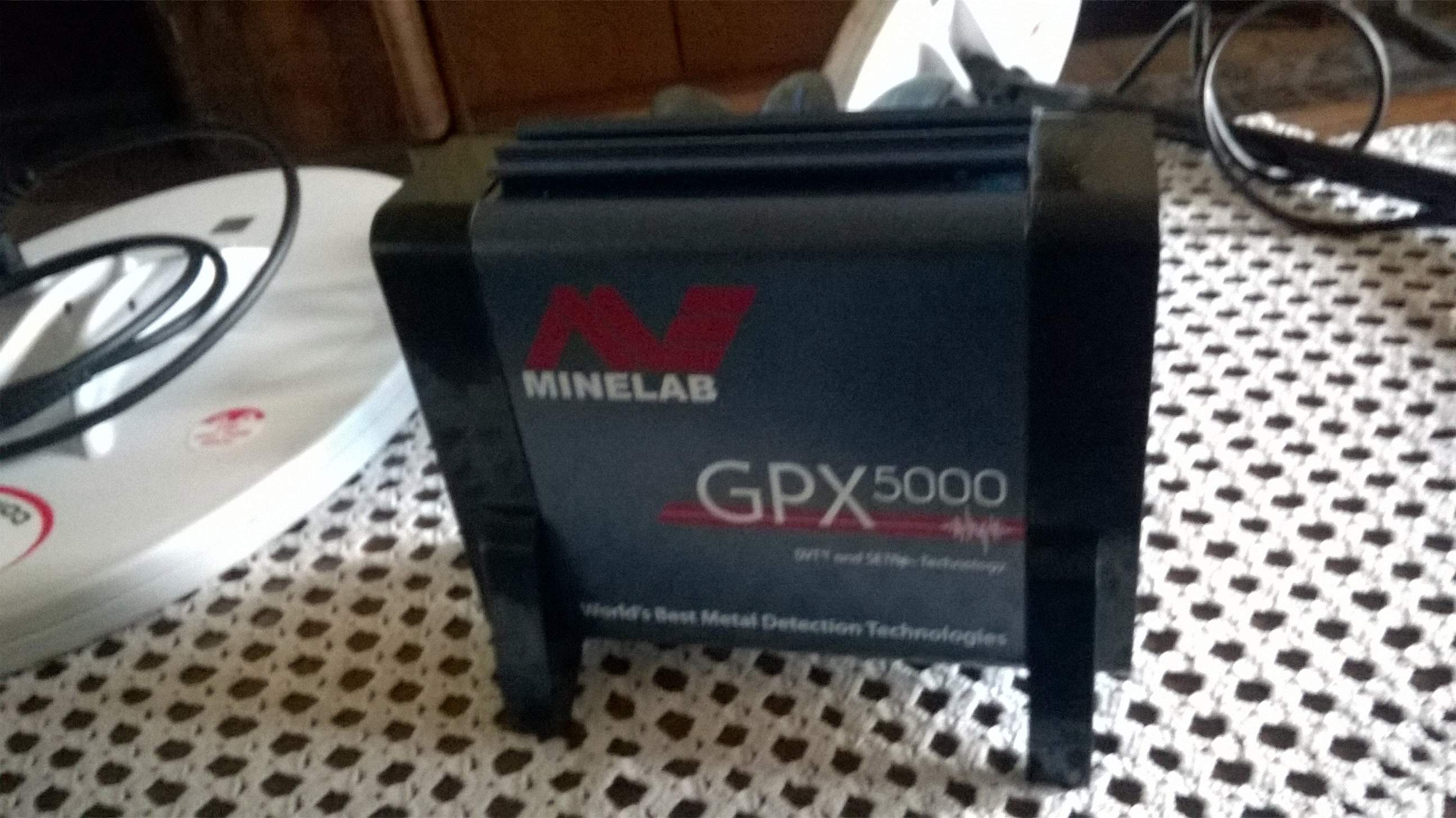

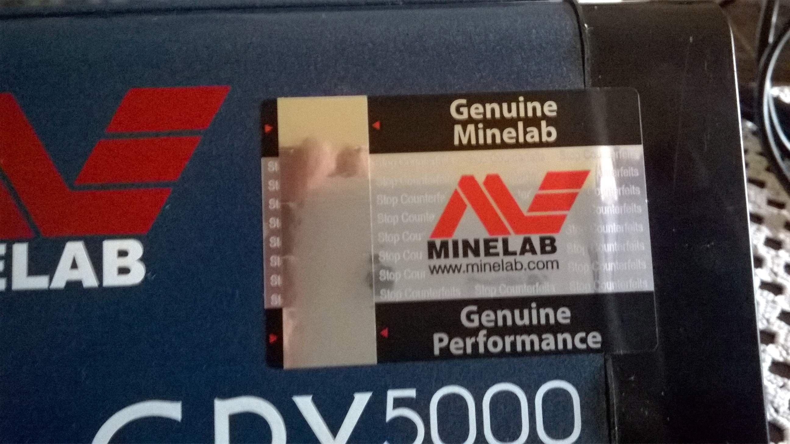

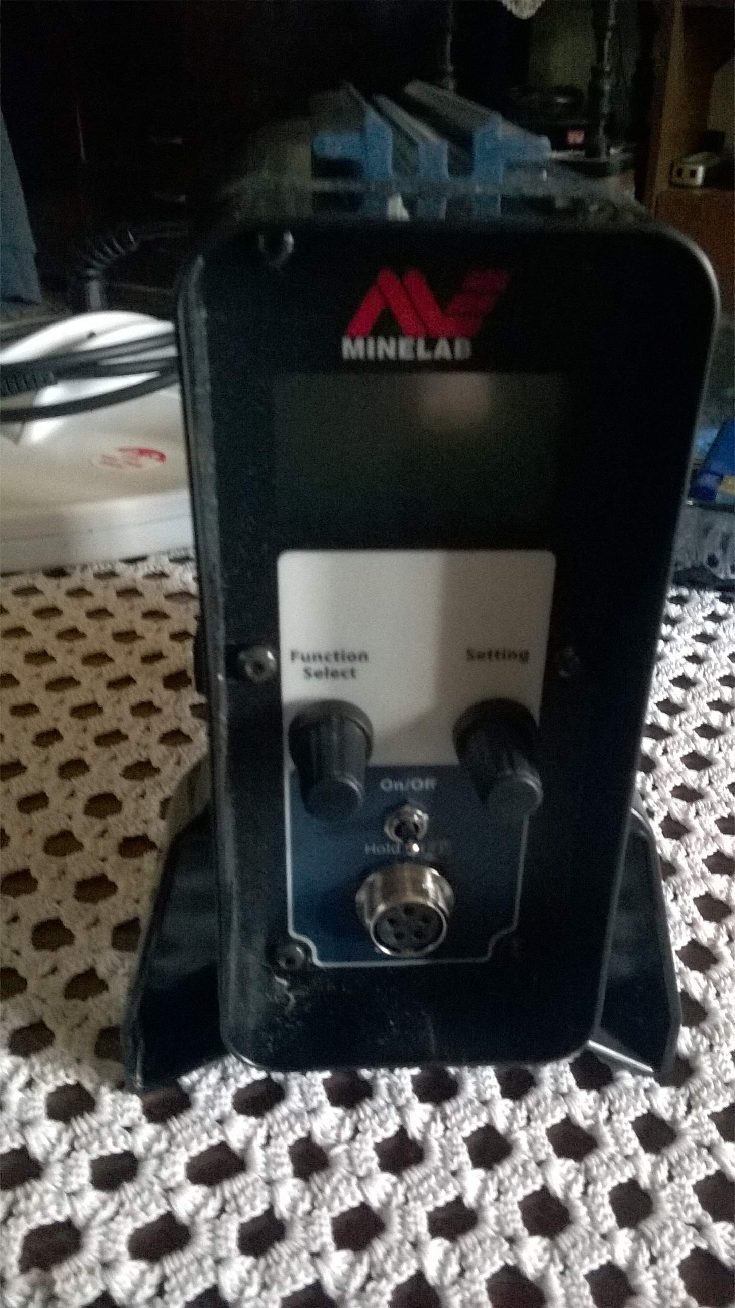

            • The other day i also had GPX5000 with me, on testing, for several hours.
              So i took an advance on having it and made several comparisons in some aspects of behavior, against FelezJoo PI.
              Author of FelezJoo PI was absolutely right and truthful, claiming that he followed ML patents explanations in process of writing code for FelezJoo.
              GEB and DISC are behaving very similar on the same testing soil. GEB at GPX is of course much more refined and more accurate.
              But DISC is much similar. At some moments i don't see the differences in behavior.
              With important notice that i am indeed very impressed with GPX and it's refined behavior.
              I had GP3000 in the past. It is obvious that the "core" is the same. Only added lot of refinements and more jingle&bells.
              Probably slightly better DISC and GEB accuracy and maybe bit better depths than GP3000.
              GPX5000 is impressive. No doubts about that.
              But my remarks on GP3000 from the past also applies to the GPX too; it is too robust and uncomfortable for walking with it through the bushes, climbing rocky hills and approaching narrow spots.
              Yes it is splendid machine... no; it is not suitable for my local sites...

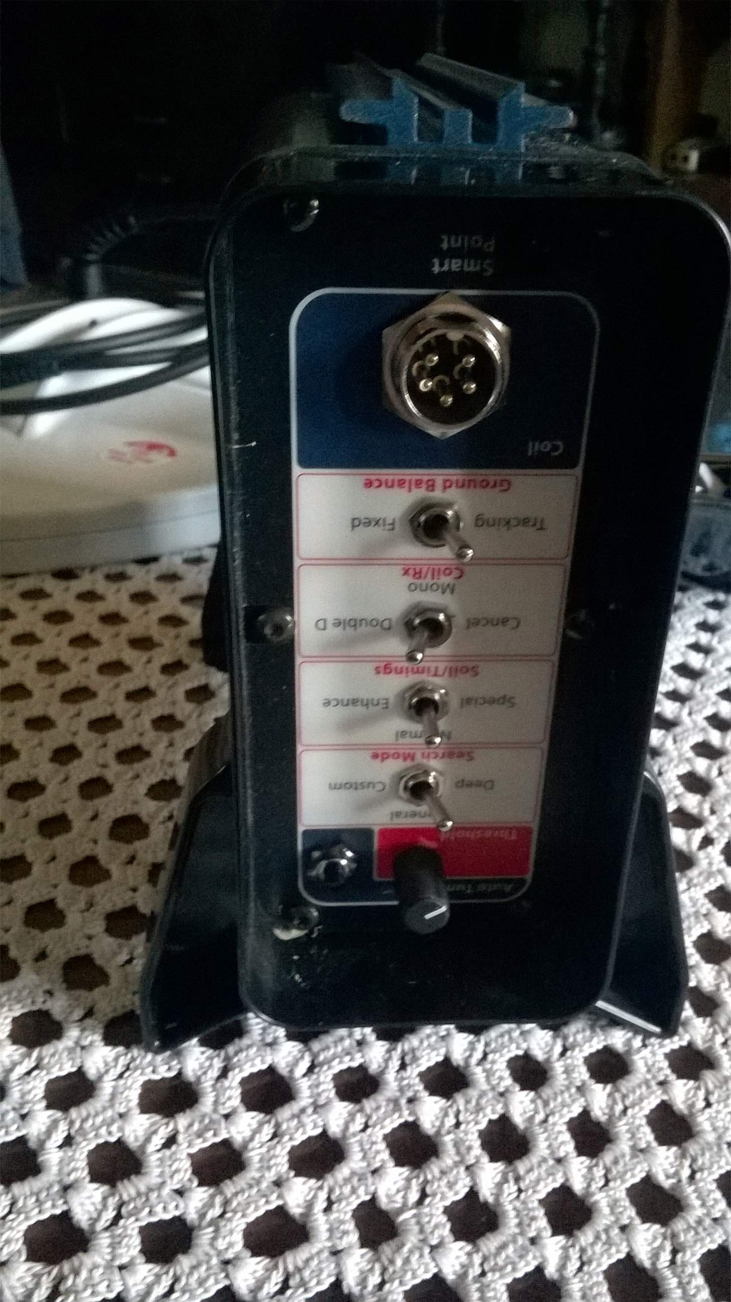

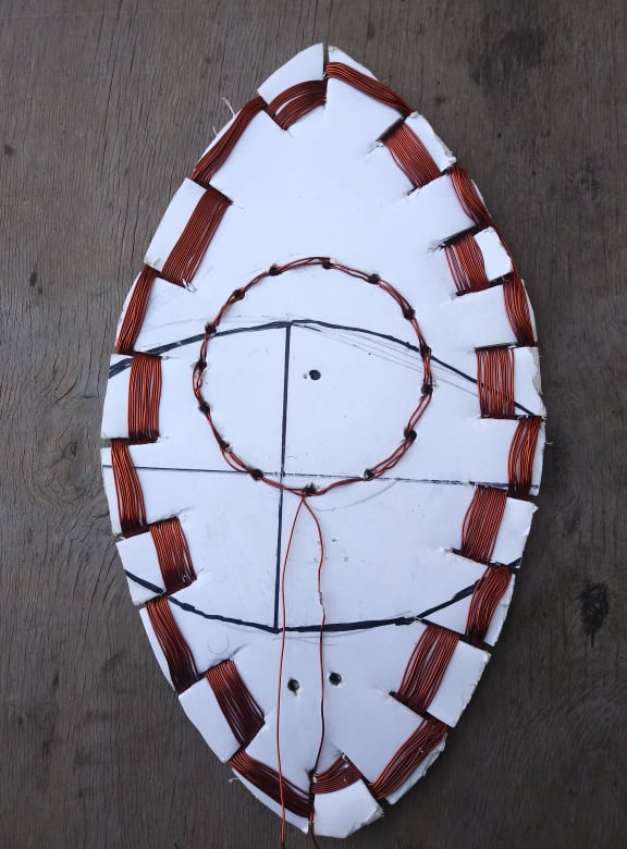

                        • I liked this machine ... I did not fully achieve the adjustments, I have 240 630 730 and still discriminates perfectly .. to the 11 x 24cm coil I made a 5-turn coil of a 9cm circle connected in series with the largest coil, the result is that it gave me more range for the gold, numerical identification presizes for the gold with a delay of 20 ... marriage ring with this small coil 33 cm and a presisa identification 29 cm ... very surprised to be a coil So small..
