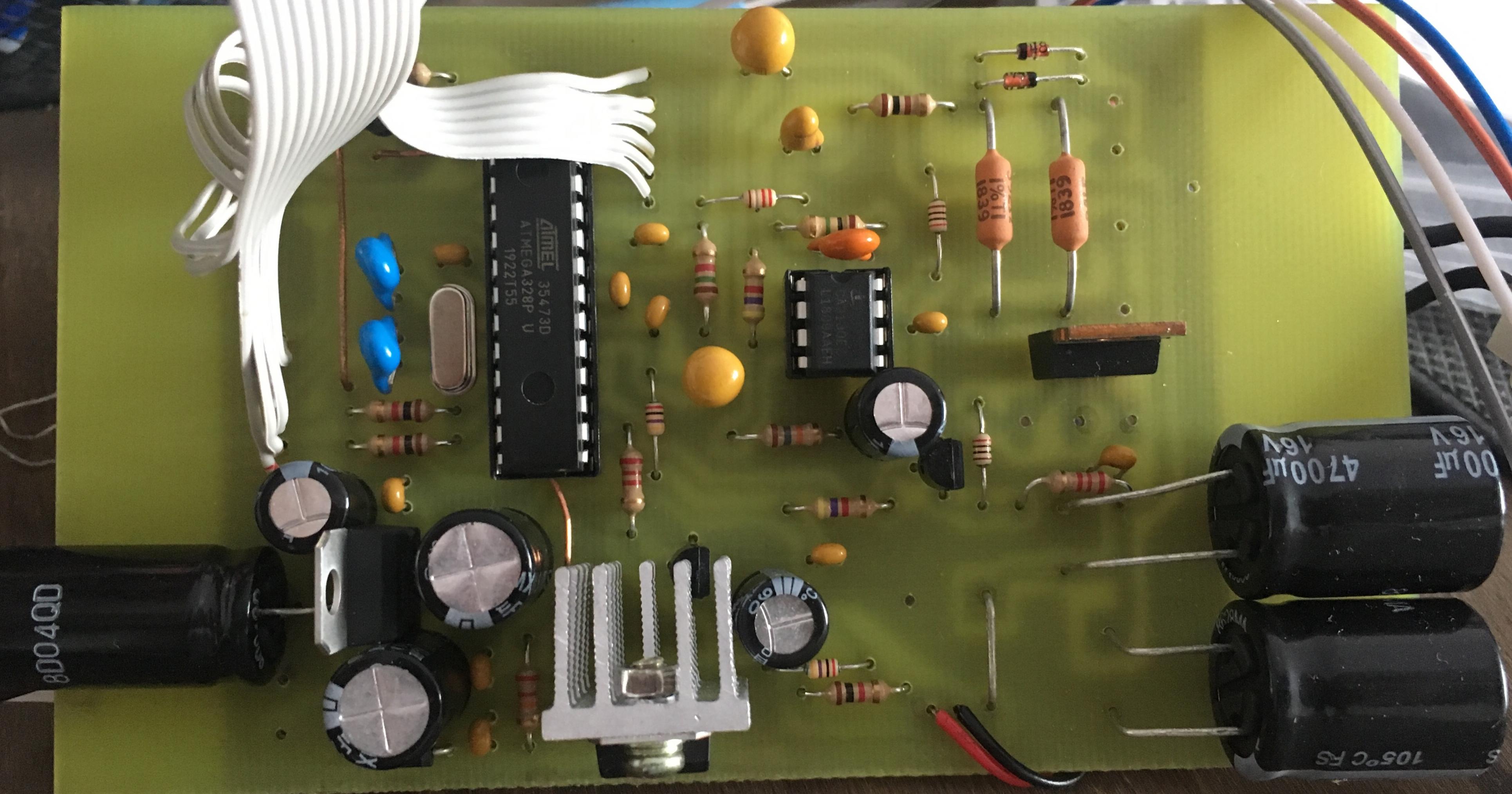

      • Hello,
        Felezjoo pi finished, i use ca3130ez instead of lf357, detector is discriminating good, but depth is not so great. Aprox 20cm for a coin. I still need to do more testing and adjustments. As a coil, for now, i have a 30cm diam bundle alphawire, aprox 300uH and less than 1ohm, rg58 cable, shielded with conductive fabric cloth tape.
        I’m not sure about some things:
        I had read somewhere that metalic coil connector make problems.
        I also want to add 2 aluminium plates paralel to the board for shielding.
        rg58 is enough for the coil cable or i need to add 2wire cable and shield connected to ground.?
        i want to add onboard isp connector for writing atmega 328 without taken it out. Jumper somewhere? Or i just rewrite with the detector on?

          to me the metal connector does not create any problem. I use a high quality microphone cable. The coil should not be shielded.
          There is the non-counter hex, you find it in the page 76 so there is no need to reprogram.
          you must use the original LF357 for correct debug values. however try to physically remove the shielding, not only disconnect it and see if the debug values ​​are close to 300 700 800. You should bring the coil close to 350uh 0.9 to 1.1 ohm and absolutely no shielding.

              I use ca3130 too and i have the same problem.
              Ca3130 overflow debbugs. Lf356 get closer but no perform very well.
              Lf357 have 20mhz gain bandwidht & 50 v/us slew rate. Lf356 have gain bandwidht of 12mhz & 12 v/us lew rate.
              I'm sure that the hex file felezjoo was writing acording to lf357 parameters.
              I agree with useus.

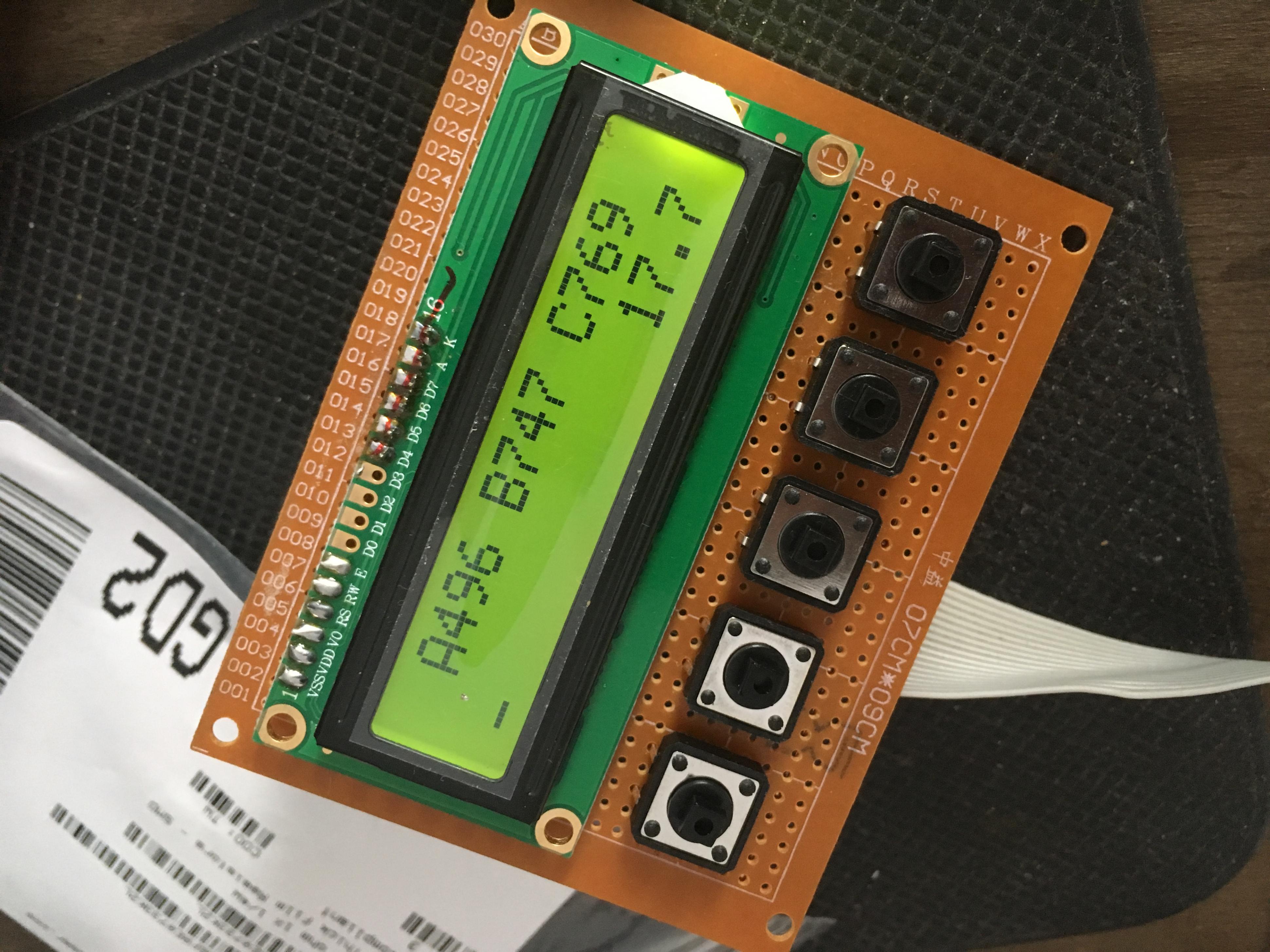

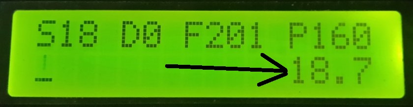

                          • I have not found information, out of curiosity this value to what it refers to? Click image for larger version

                            • this is the level of the battery. At 14.5 gives error coil.
                              By touching the top button, numbers indicating the size of the metal will appear. The larger the size, the more these figures change significantly compared to a small size of metal.
