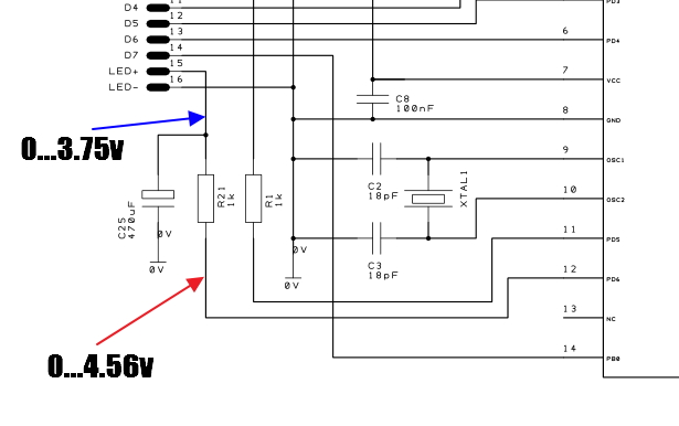

  • Originally posted by SWL View Post
    Hello! There is no backlight. On the circuit there is a resistance of 1 kOhm ... Shouldn't it be 100 Ohms? In the settings, the backlight level is 10.[ATTACH]48925[/ATTACH][ATTACH]48926[/ATTACH]
    Hello, R21 - 1k is correct. check voltage, led+- and before resistor also.
    • Voltage varies from 0 to 3.75 at pin 15 of LCD. If apply directly 5v to pins 15 and 16 --- the backlight works. I will do a separate power supply through a resistance of 100 ohms ...

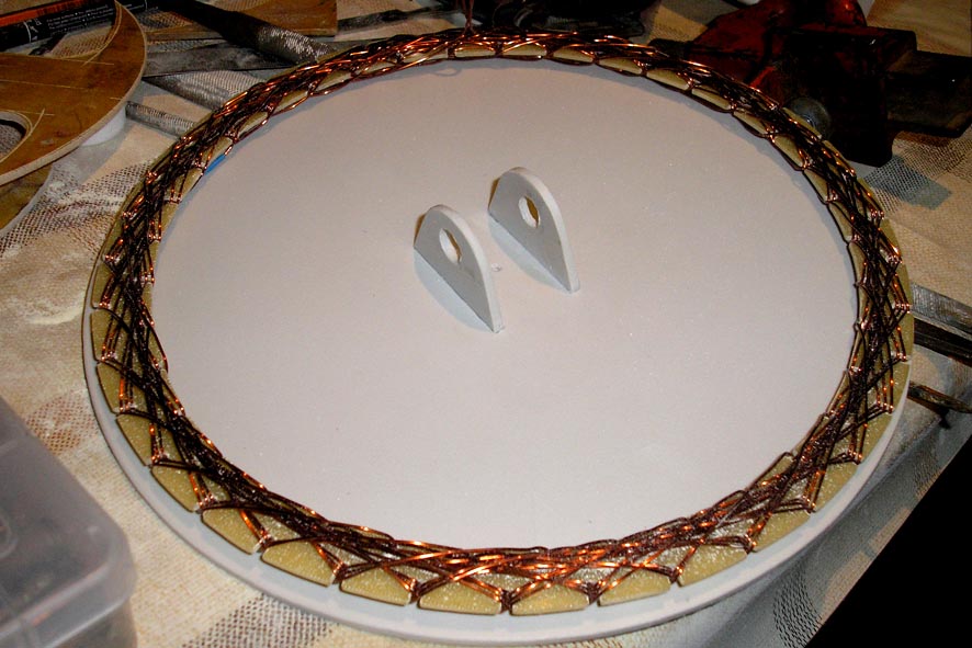

      • One more question ... I'm going to make a basket sensor. Size 190 mm. I’ll look for small things. Has anyone already walked with such a sensor?
          [ATTACH]48945[/ATTACH]
          Backlight varies only if volume is off and target is near the coil. I’m not sure about your problem, it might be something to do with fuses when writing atmega chip.
            [ATTACH]48972[/ATTACH]
            i’ve tested yesterday flat coil/ debug numbers almost perfect, air distance for a coin aprox 35cm. But in the field i had a lot of false signals, only way to silence the detector was to adjust speed from 10 to <5 but depth become very low. I think shield of the coil is the problem. Basket coil give best depth/sensitivity but you need to test. Depending on the coil size you have to use the right wire to match resistance and inductance. I saw that inductance is more important as for the resistance, you can adjust PW to get the best debug numbers. Minelab gp coil also works but not yet tested in the field.
            • Thanks for the information ... Today or tomorrow I will wrap the sensor and check .. But I won’t figure it out with backlight --- I’ll connect constant power

                Ionut, can you tell for us at which PPS and pulse width you drive your flat coil?
                As for compartion my clone pi-w coil-target distance limits are - 35cm for 26mm coin (1 gryvna) with flat coil 27cm, with PPS 200, pulse width 100uS.

                  hello and happy new year!
                  i’m not at home right now to see the exact Settings but from what i remember frequency was 201 (on felezjoo iranian forum they say it is less noise affected) and PW different from coil to coil, influenced by coil resistance. For example for my homemade flat coil r=~1.9 ohm i use less PW ~ 135 to match number A 300. For detech spiral 11” ultra sensing gpx coil R=~0.4ohm i had to push PW more ~180 to get A 300. Detech coil is more stable and deep. But did not had the time to test in the field.
