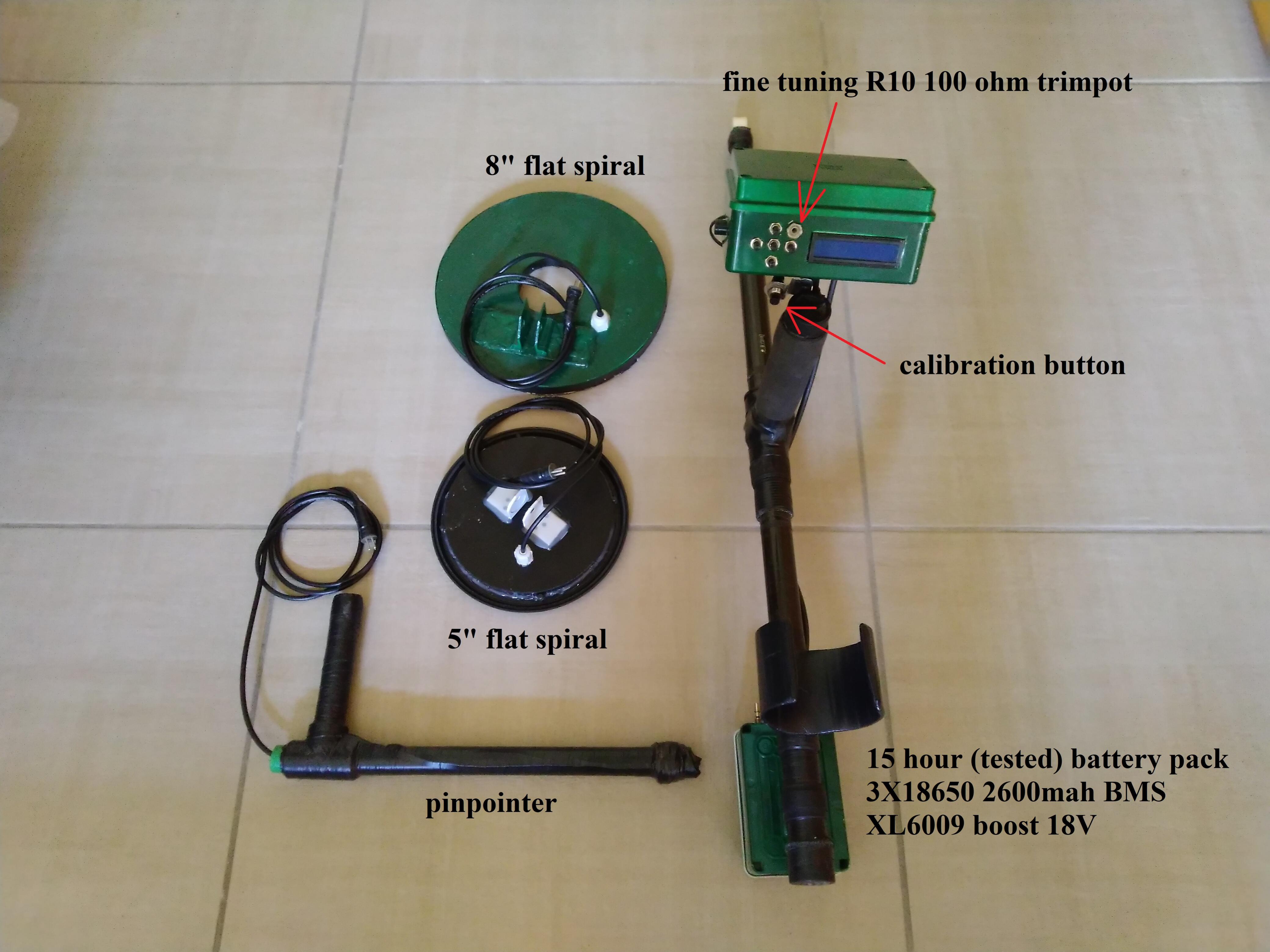

  • today first use in the field, various findings even at 28cm depth!
    my felezjoo is finally completed and fully functional! he is really sensitive, he found me an m4 nut about 10cm below the ground.
    I can safely use sensitivity 18 with unshielded flat spiral coil.
    I shielded the electronics box,
    mounted C14 / C26 green cap capacitor and replaced R10 with 15ohm as refinement of debug values.

              • I have a question to ask you about the power supply and the circuit. the metal detector consumes about 115ma without target.
                I use 3x18650 2000ma BMS 3S and XL6009 boost to bring the voltage to 18V.
                Calculating 2000ma (batteries): 115ma (consumption) the theoretical use should be 17 hours (without targets), but it lasts about 3 hours.
                I can't understand what causes batteries to last so short

                  Have you tested the batteries with a constant current load to confirm their actual amp-hours capacity, and not what's printed on the side of the batteries?
                  There a lot of fake batteries available on the internet. If your battery pack is really 2000mAh, then 3 hours implies that the circuit is consuming an average of 667mA.
                    no I have not tried, it is probably as you say, I will change batteries with original sony and we will see if I solve

                      Was the 115ma measured at the circuit or the batteries?
                        Circuit
                        • Originally posted by useus View Post
                          Circuit
                          With the boost supply the battery current is probably closer to 200ma? Still doesn't explain the 3 hours.

                              I solved, it was the bms that had problems, the metal detector has been on for 5 hours with the coil connected and has not yet turned off!
                              if it arrives at 8 or more hours I will be happy: D
