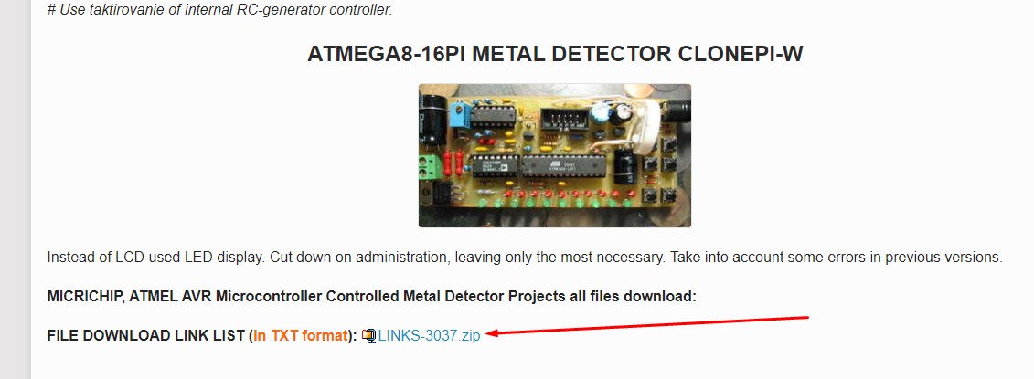

    I used the clonePI AVR schematic from this webpage:
    https://montazhtv.ru/de/metalloiskat...em-minimalnoe/
    On this webpage you can find a ZIP-file called "LINKS-3037.zip" with a complete clonePI collection (scm, firmware versions etc.) as download.
    https://320volt.com/en/mikrodenetley...oru-projeleri/
    I am using the latest firmware version 1.8.1 and did not notice any issue yet.

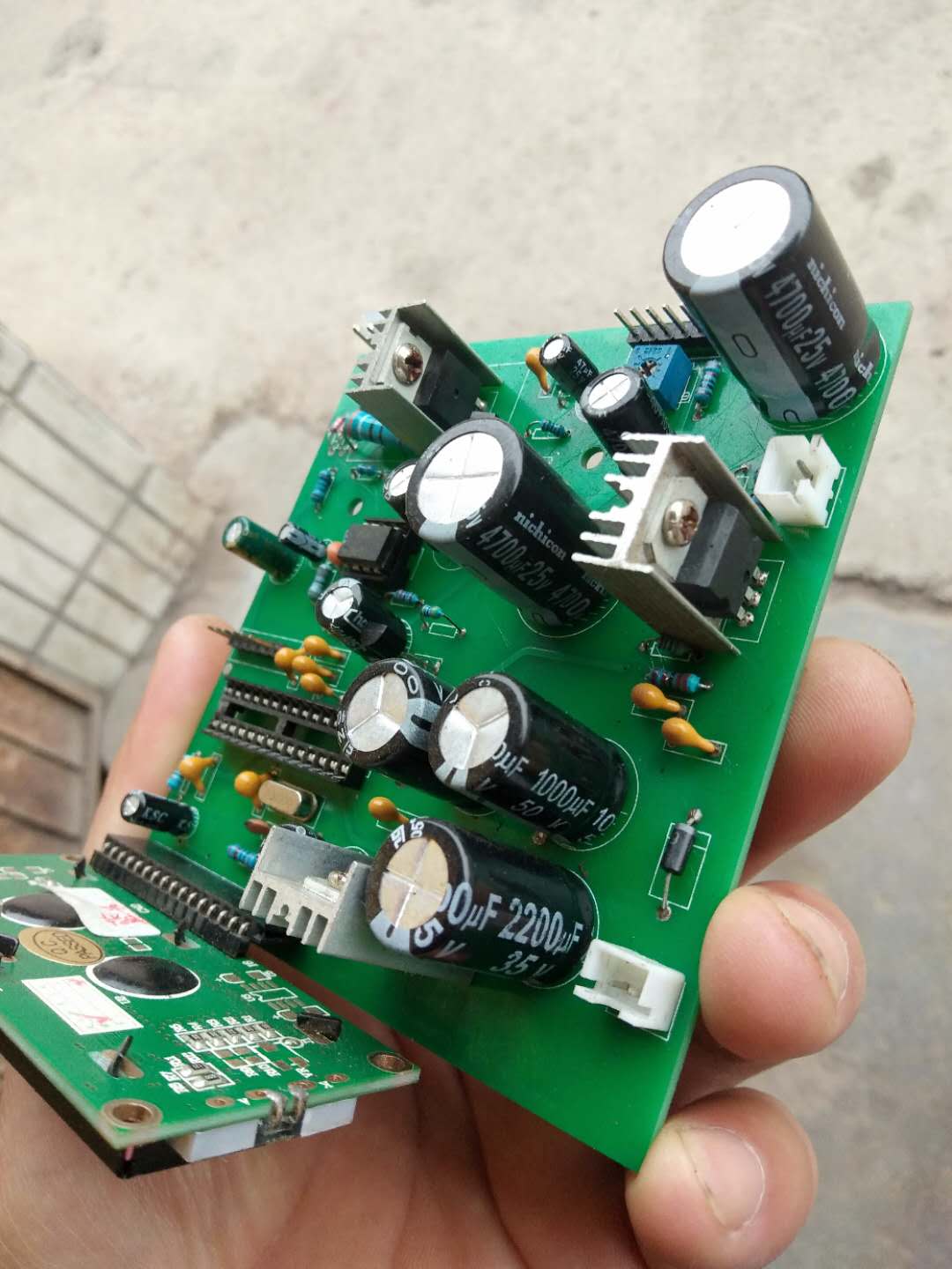

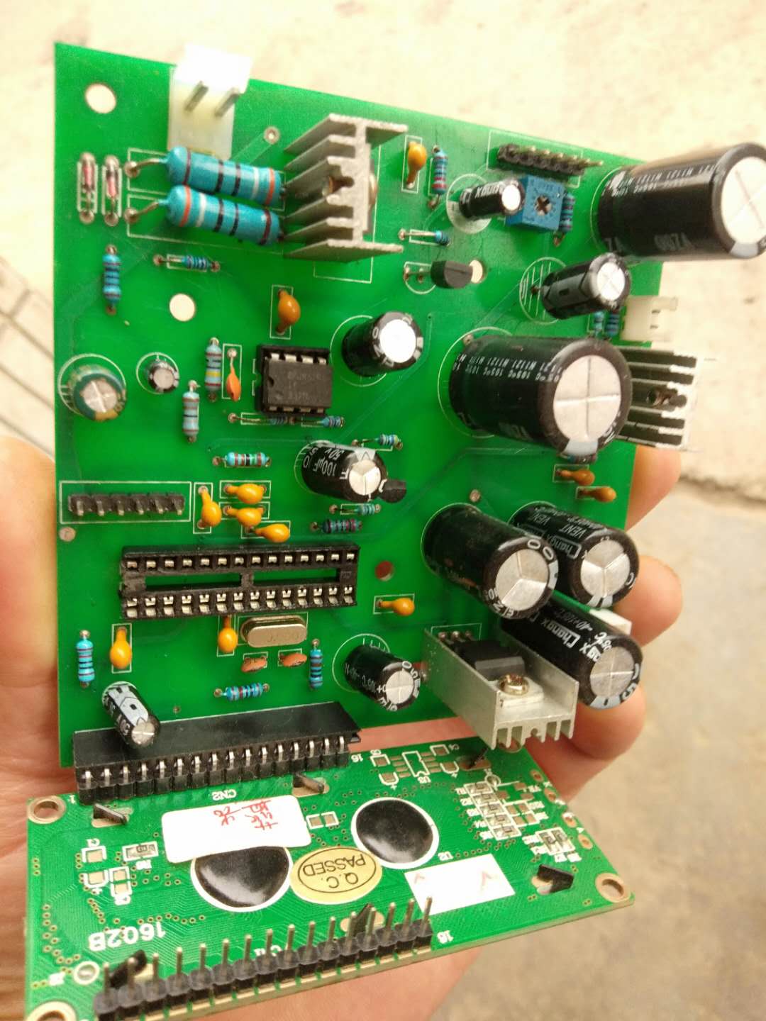

        • Hiya all,,,Can someone please check my re-drawing of a 'Felezjoo Rev-A' board that I've just completed. I had searched everywhere for the Gerber files for this PCB as I have built 6 of these boards up to now and never had any issues with them. They all work exactly the same, good depth, great sensitivity etc,,I wanted to fnd the original Gerbers or layout so I could order some pcb's for my friends but couldn't find one so I decided to copy the last 3 boards that I have left in hopes my drawing is correct,,,hope someone can check it for me,,,Thanks in advance, Regards, Marty.
          EDIT:- Silly me!,,,forgot to attach the file!,,Lol.

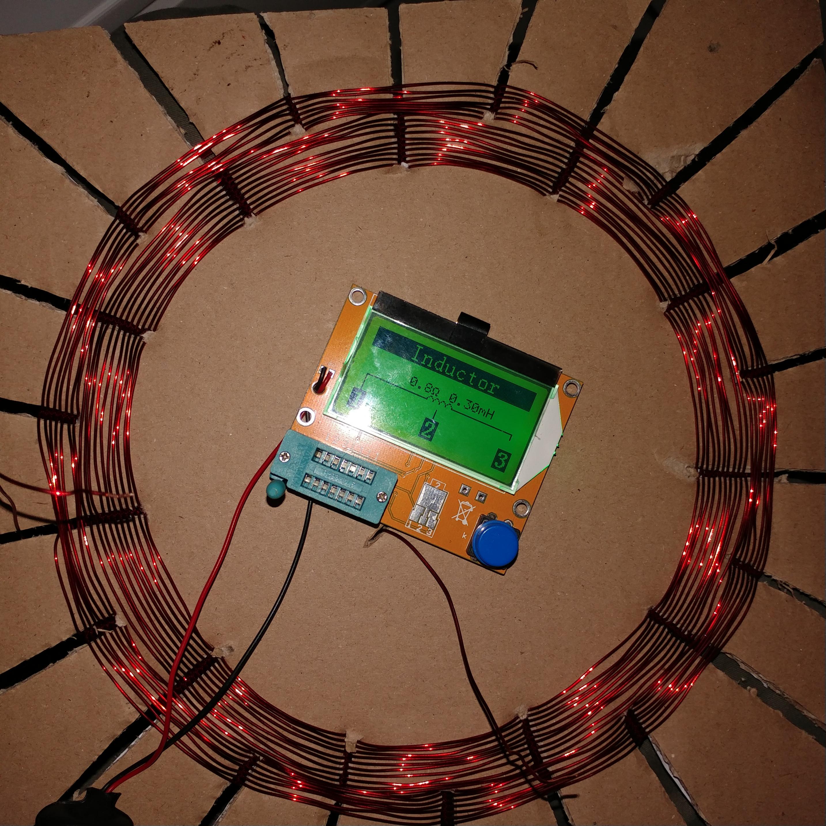

                        It is this coil it's 0.8mm enameled coper wire.
                        Inner diameter is 16cm and 22cm for outer diameter.
                        I did 17 turns.

                          you said without coil voltage is ok, so, maybe mosfet drain-source short. Or frequency too high, or pulse lenght too big... check amperage of your circuit.

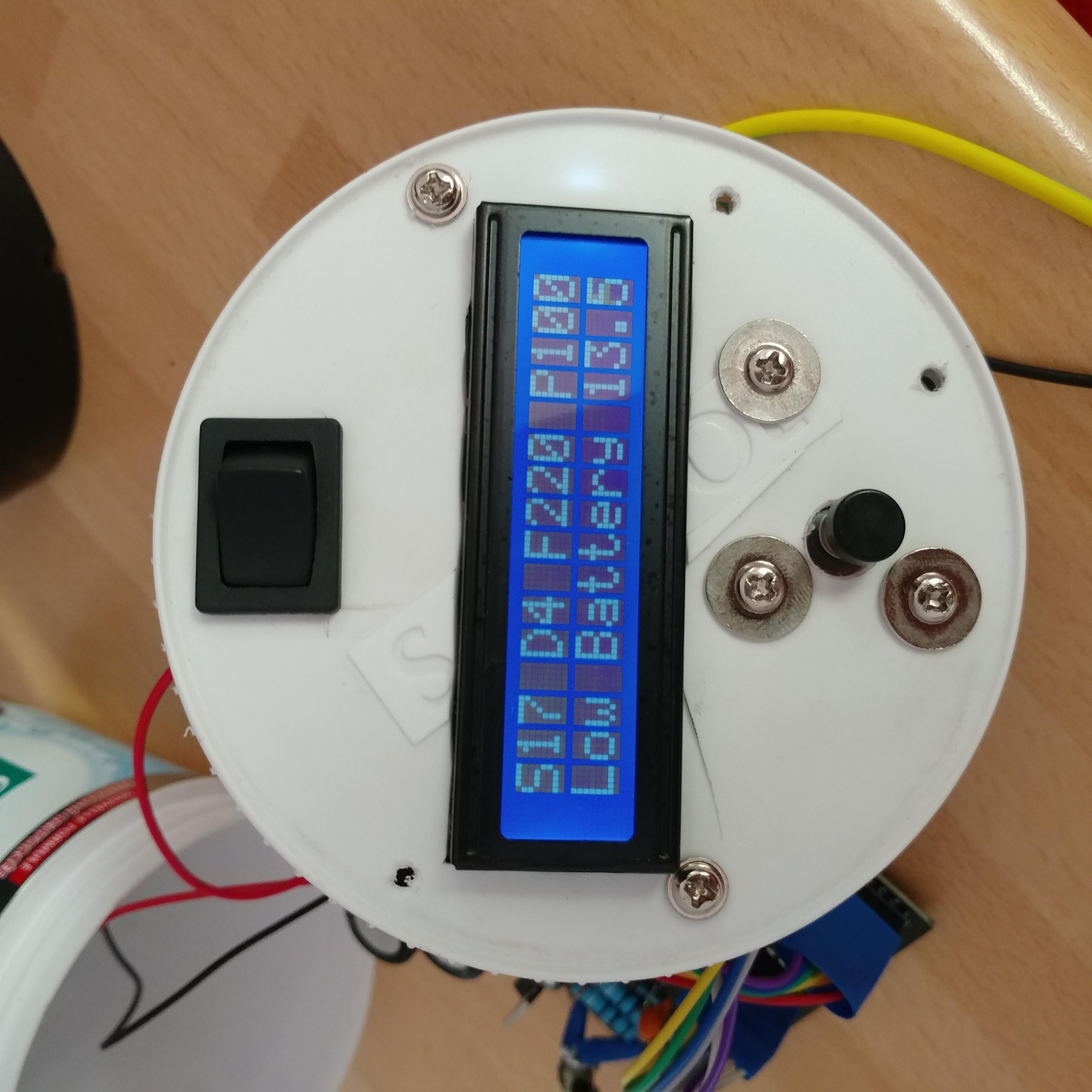

                          Voltage without coil is good. For pulse width and frequency I use this parameters.

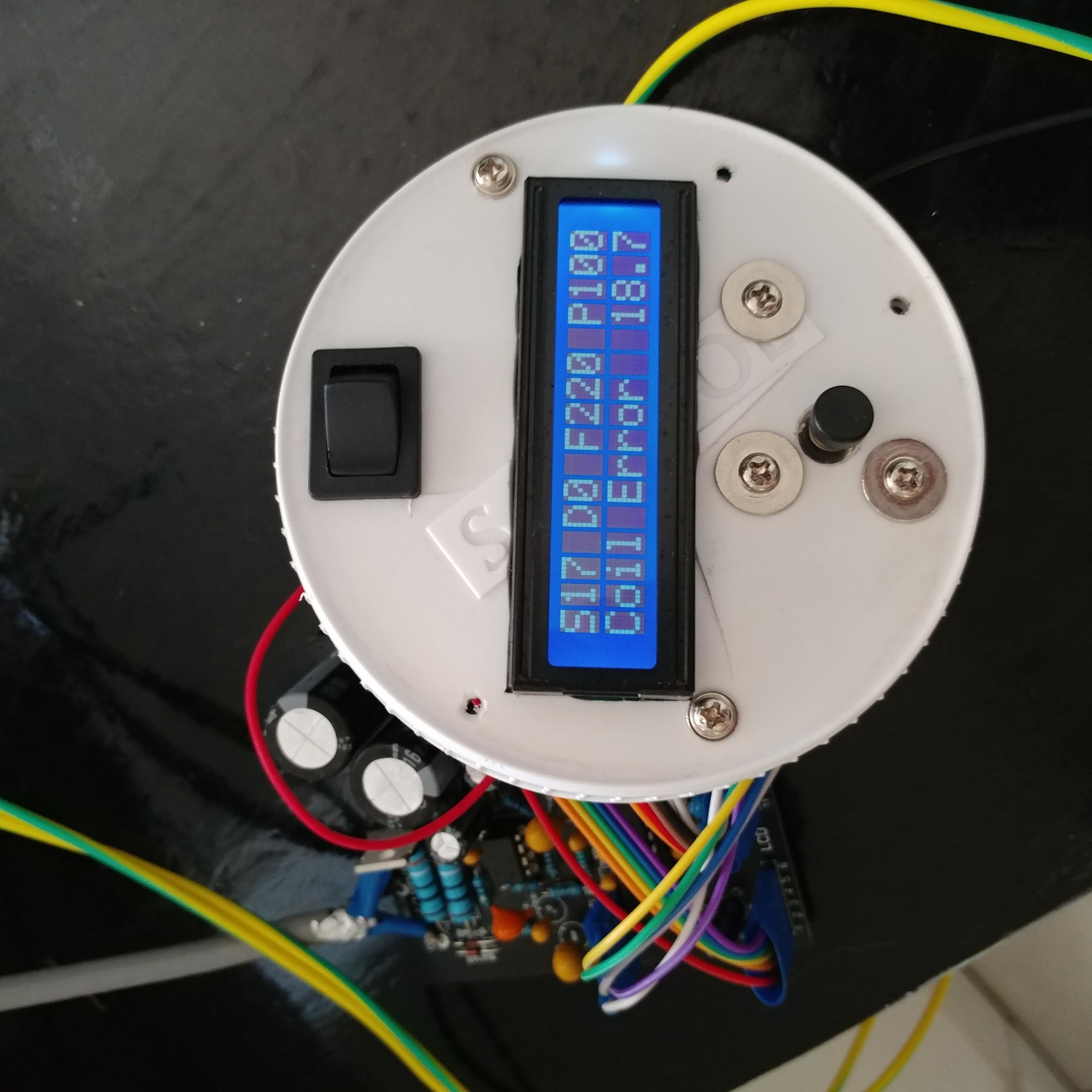

                          And now with the coil :
                          This time the felezjoo worked normally during two minutes before battery problem appear....
                          I touch irf840 and it's not really hot 78L05 as well.
