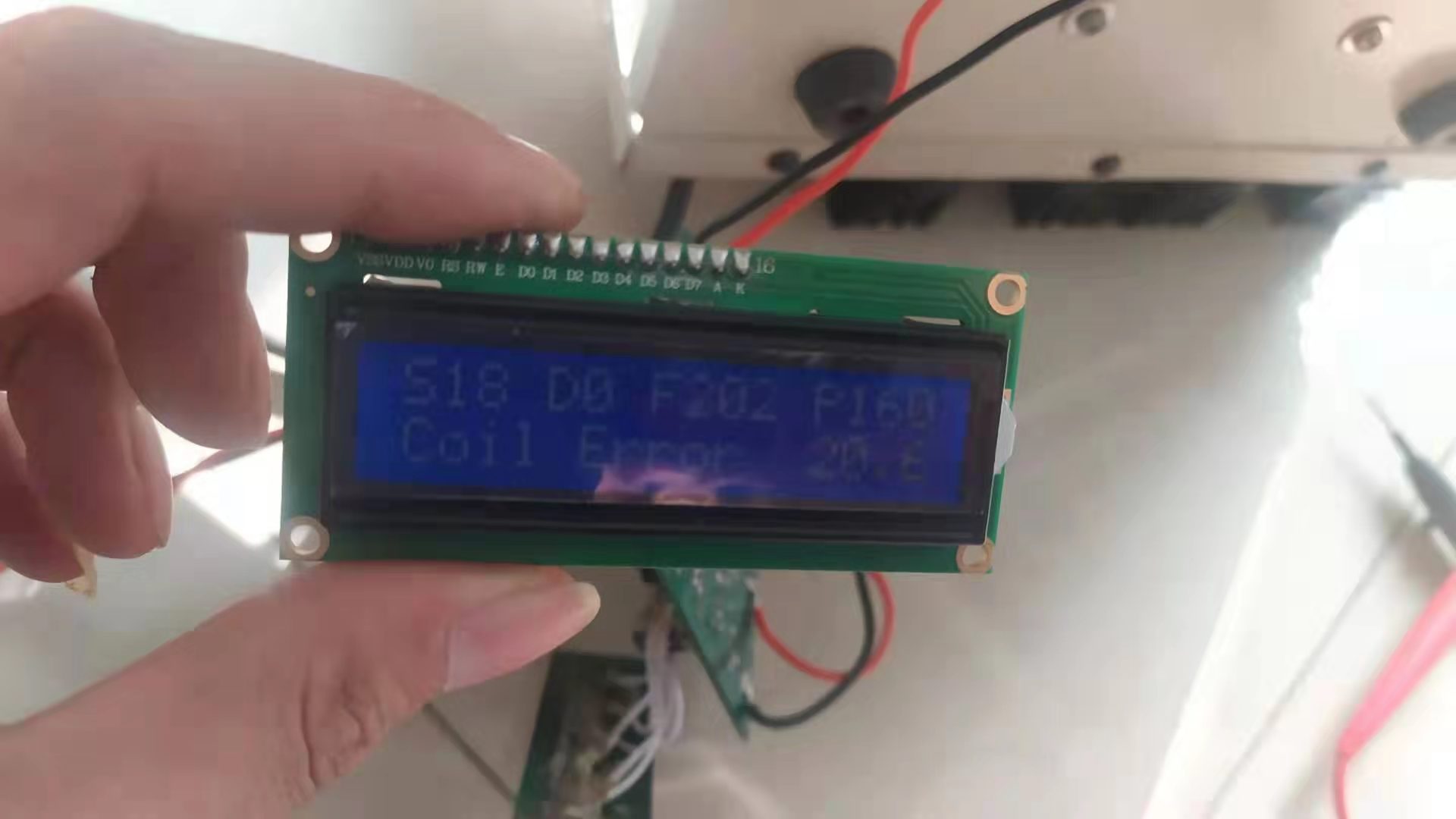

  • Hello everybody, Am your friend taha from Tunisia. I have the felezjoo with all his model of this great machine, For you, who HAD this " COIL ERROR " this is simple use potentiometer 5k or 10k instead of R11 390 ohm. Using the potentiometer with clicking Down button, felezjoo read the coil, slightly try to fix the Super number ABC then restart the box.
    • My dear, Don't rush its simple Use Pot 5k or 10k instead of R11 390ohm it will works

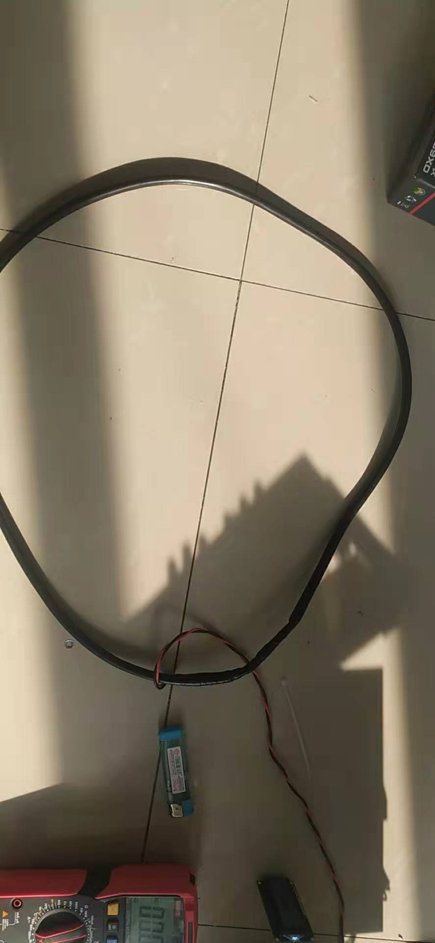

                              • Hi,Do me a favor And tell me why the coil err,Thank U.Click image for larger version
