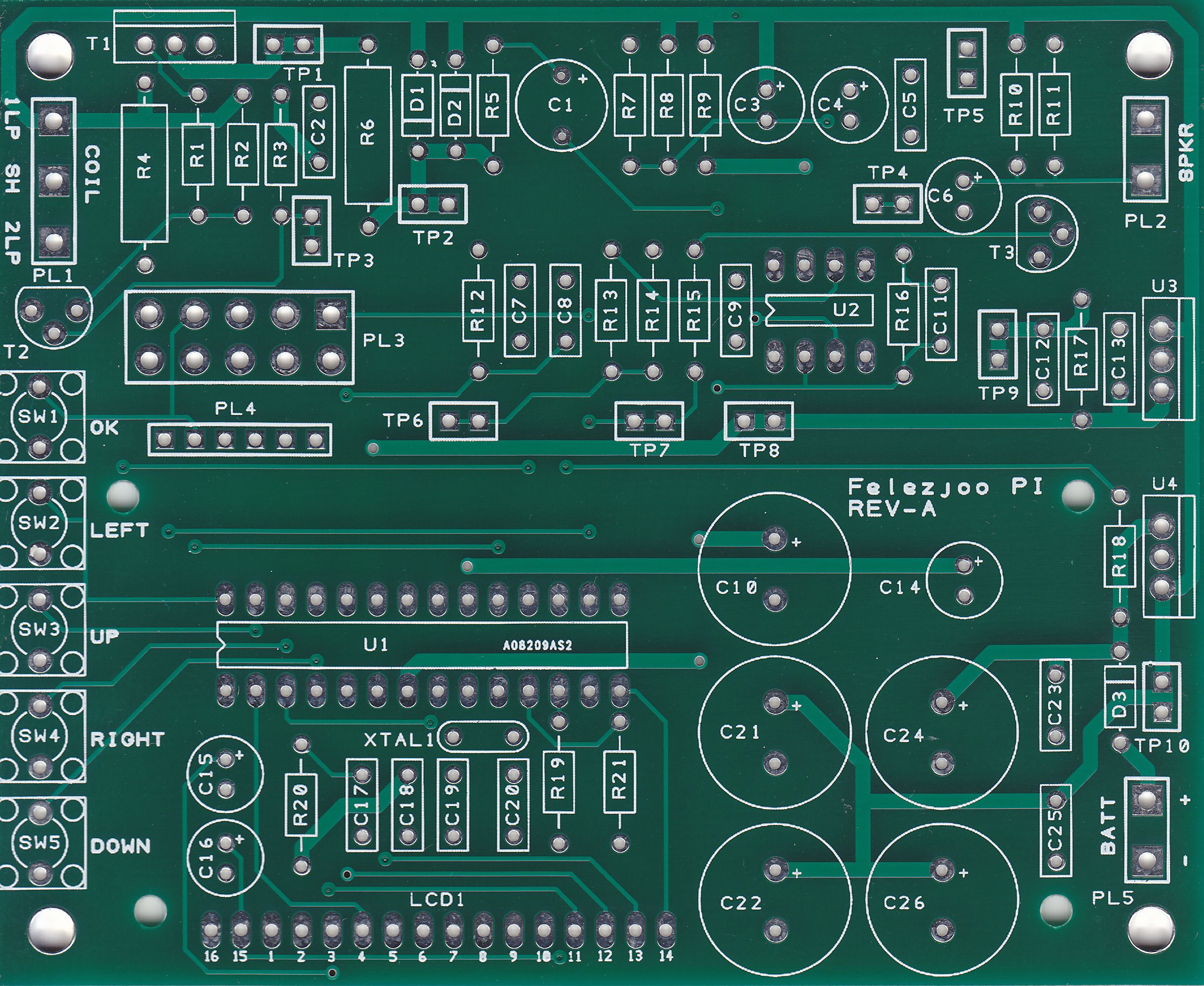

ID:	362059FELEZJOO Rev A-2.rargood colleagues I have a question regarding the detector in particular to the version of FelezJoo RevA I have seen some revisions and I found some flaws and I would like to know if any of you could tell me if it is okay as it looks.

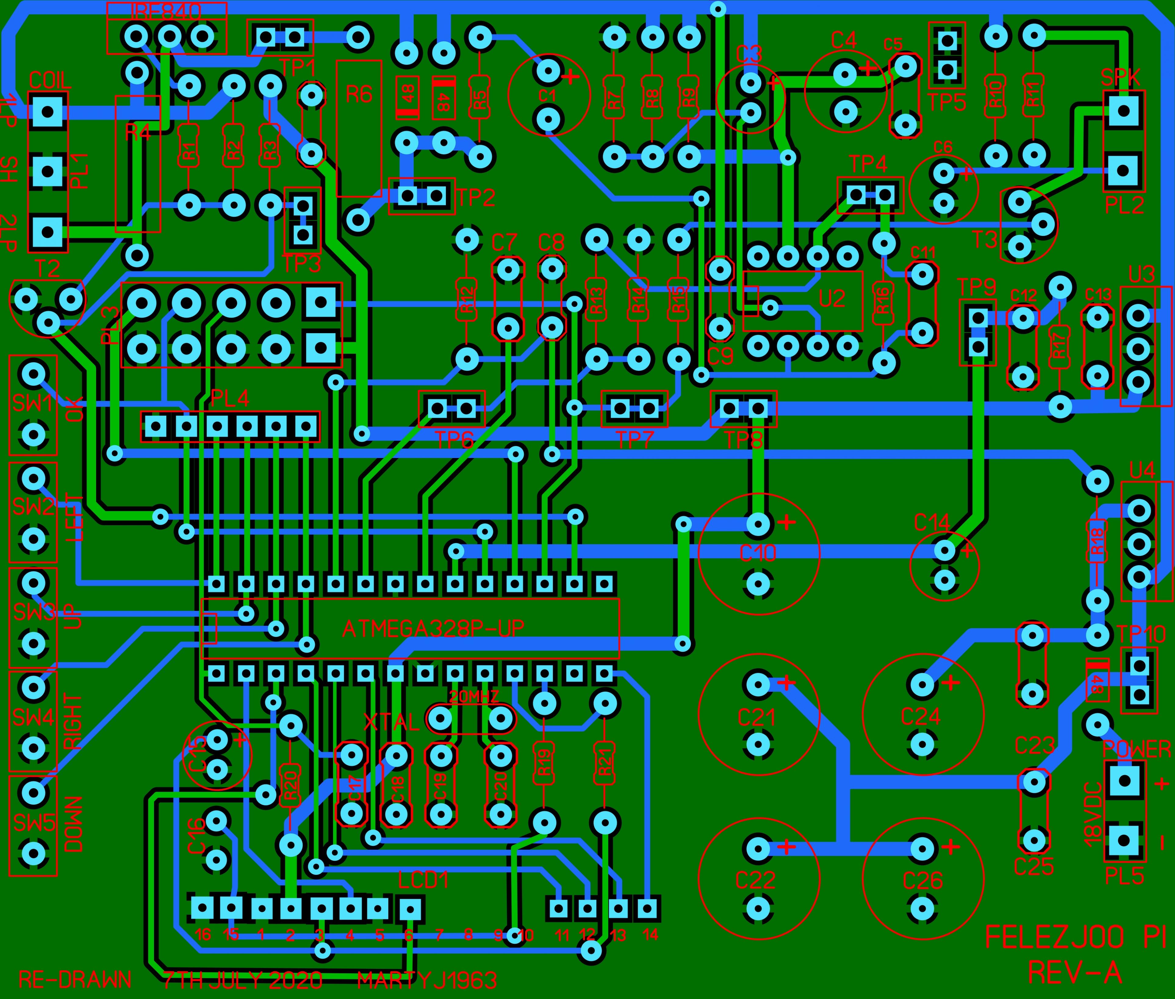

        • Hi Sabios. I was the one who copied this layout from my working Felezjoo board. It works without flaws. Regards, Marty

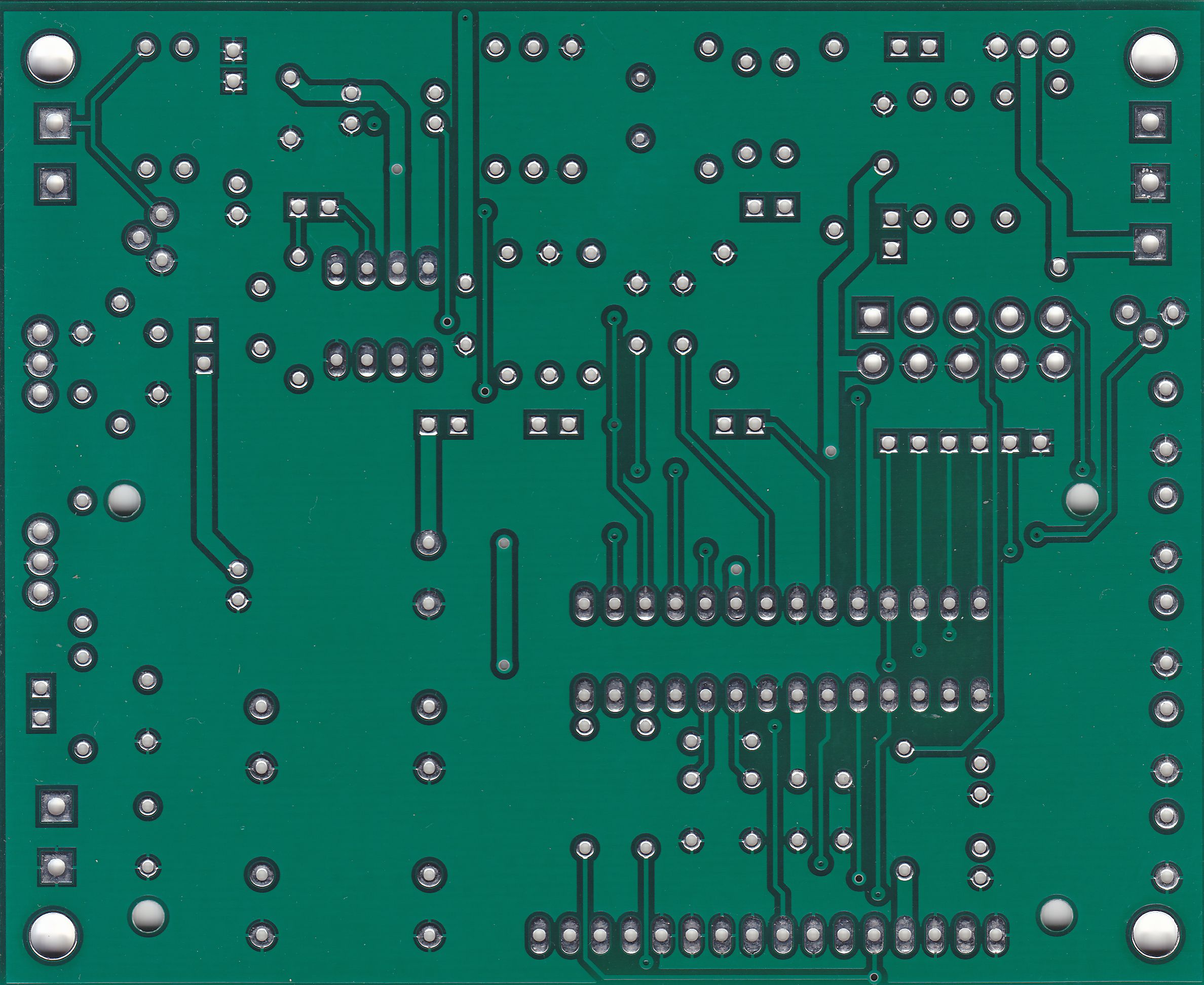

          • @Sabio. I updated the layout tonight. The layout is the same but I added the component names and values. I also included the schematic I used to build this layout, a Parts list, and a 2 x photos of the original PCB i copied in case you want to build this layout. I also included all available HEX Files from v2.4 to v3.5 full edit and the Felezjoo Fuses. There is a manual also that I translated on how to operate it. Good luck in case you decide to bild! Regards, Marty.

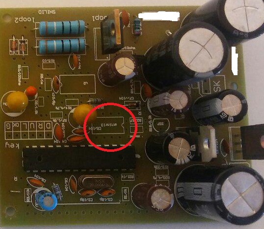

                      • Extra chip, ATTINY13
                        It must need another program.

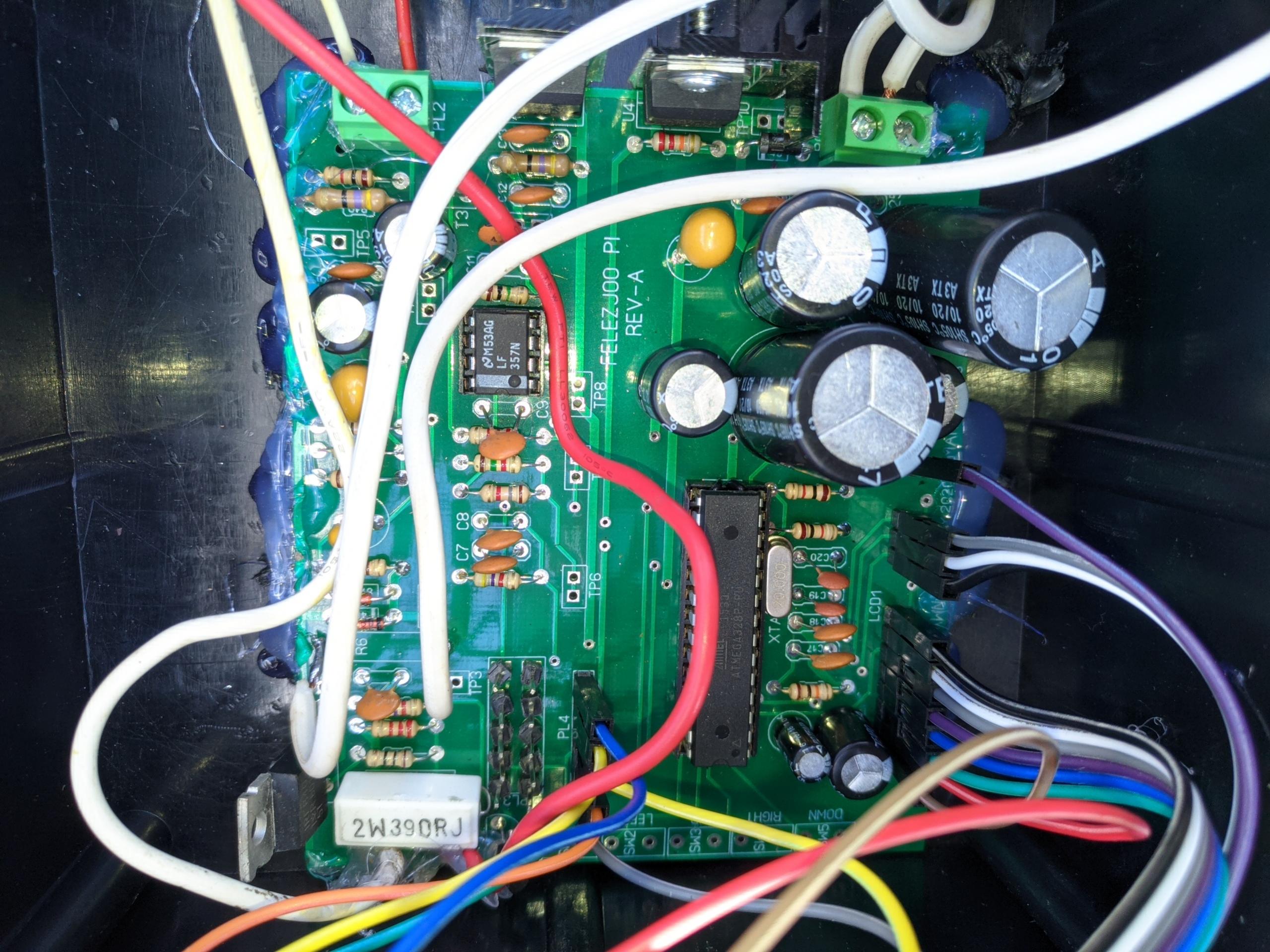

                        • I just finished the FelezJoo but I get the annoying coil error message, there is some solution since it is read that with a potentiometer in resistor R11 and that changing the resistor R10 for a potentiometer and that the CA3130 also serves as a replacement.
                          but of which poteiometer 1k, 5k or more
                          • I have a question about how much would be the voltage of pins 2 and 3 of lf357 and how many voltages would be the output through pin 6 since the measurements that it gives me with the multimeter is pins 2 and 3 are around 9.5 volts of 12 volt on pin 7 and 0.4 volt on pin 6 with lf357 and if I change for tl081 the output voltage rises 1.24 volt and I already changed the 390 resistance for a potentiometer which would be the error.
                            • I checked the voltage on the LF357 and on pin 2 it gives me a voltage of 10 volt on pin 3 9.66 volt and on pin 7 it is 12.18 volt those numbers are correct
                              • Originally posted by sabios View Post
                                Hi Sabios,
                                Slightly different subject, but it looks like your 2W 390 ohm resistor is wire wound ceramic which can introduce additional inductance. I would change this for a metal film resistor of similar value
