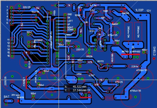

      • Hello, everyone! Can this ATMega328 be replaced with a patch? thank you
        • I wonder if we can use a 7812 to provide LF357 as the power supply, so as to reduce the noise caused by the coil on the power supply. Has anyone done this before?
          • mohamadreza26204 you have a mistake in this pcb sound .

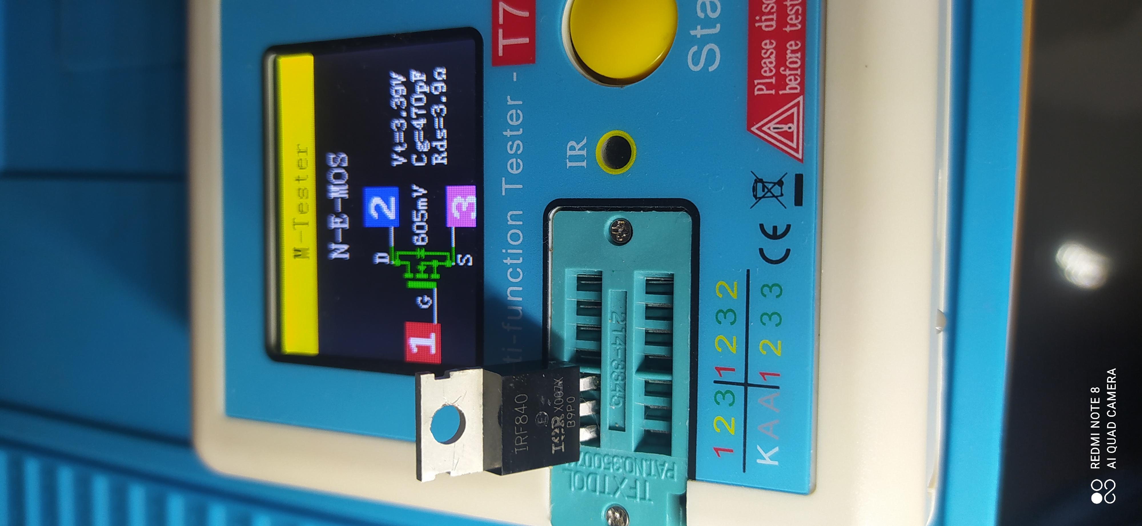

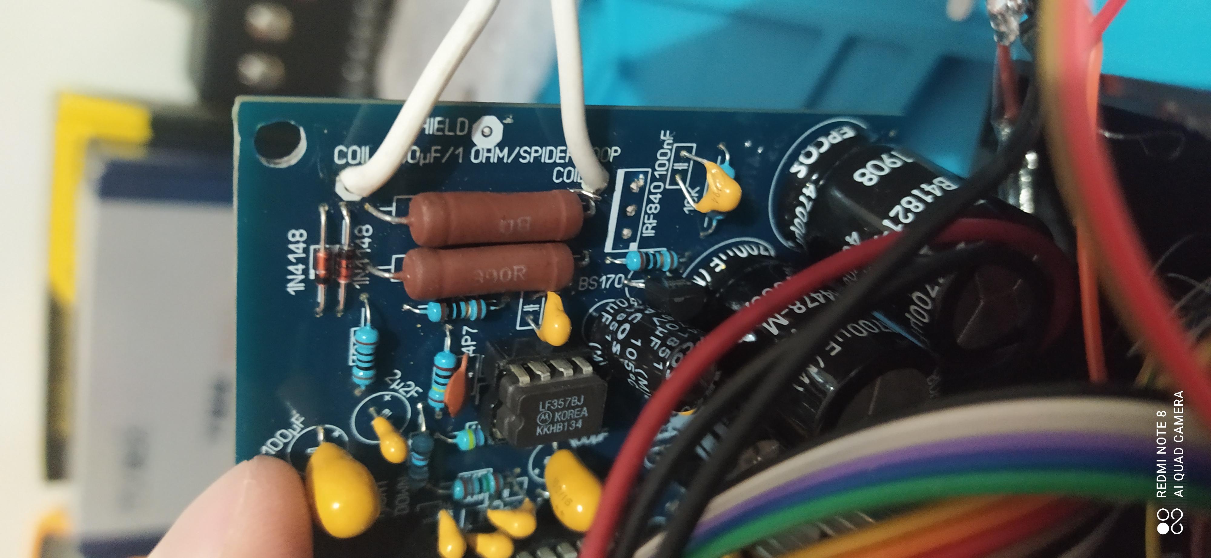

                        • After almost two years that I assembled my felezjoo I discovered that the IRF840 transistor is fake well outside the specifications of the datasheet Do these different values ​​affect at what point in the coil switching?
