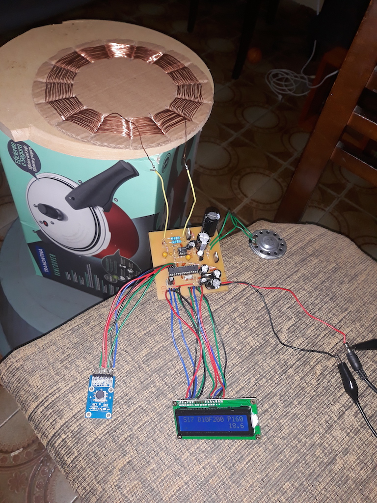

                    • I finished building the Felezjoo, but it is too slow to start, it takes about 5 minutes to go from the start message to the menu and when it is there, the joystick commands seems very slow to respond, anyone else having this problem? Thanks.
                      • Cristiano.sar
                        Fuse atmega
                        • Thanks for the help!
                          I got it working, after bricking an Atmega, I burnt another with usbasp and avrdude from mac os terminal with the commands below:
                          avrdude -c usbasp -p m328p -u -U flash:w:felezjoo_full_M_3.35_.hex
                          avrdude -c usbasp -p m328p -U lfuse:w:0xf7:m -U hfuse:w:0xd1:m -U efuse:w:0xfc:m
                          Now it's working normally.

                              Just sharing the final result:
