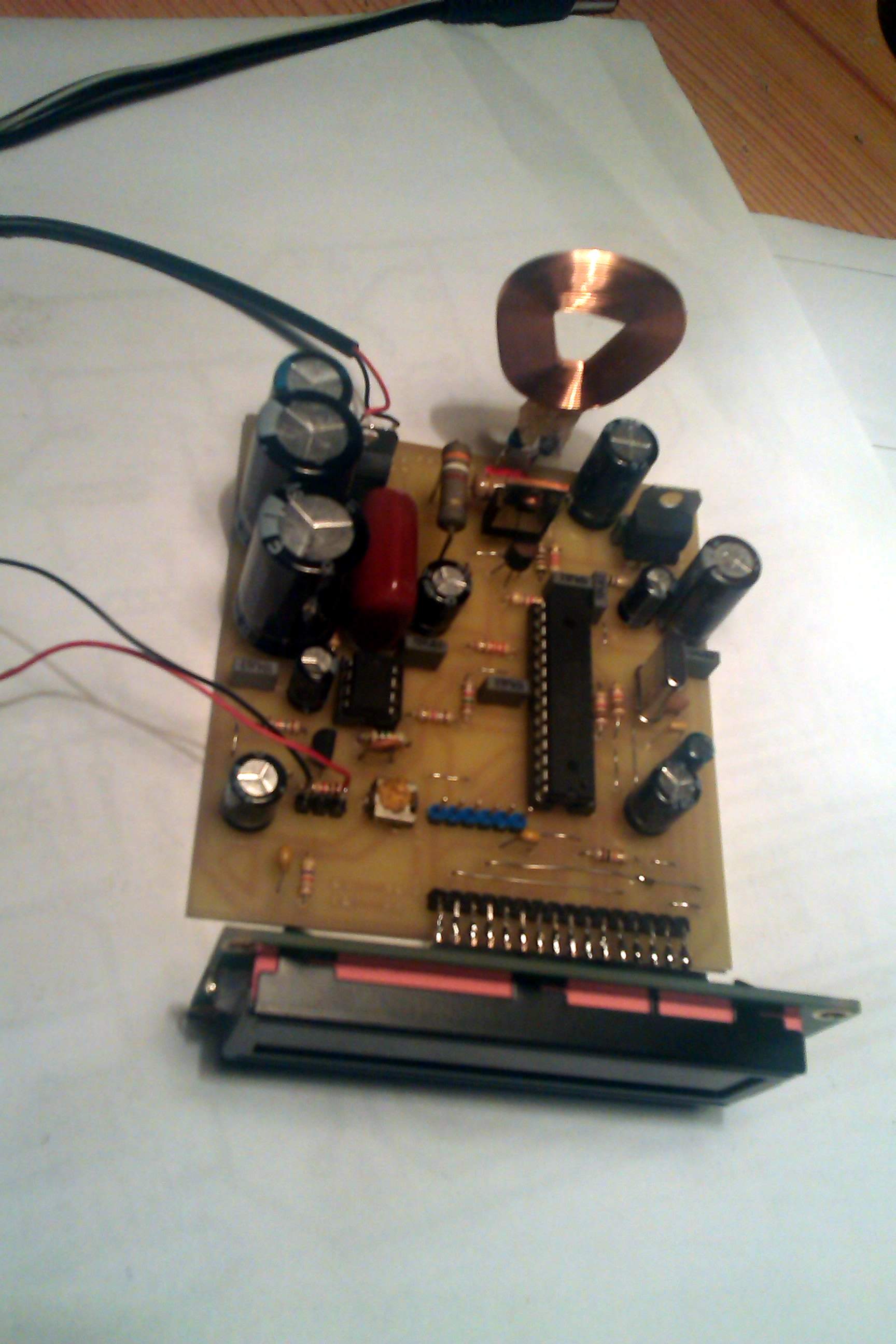

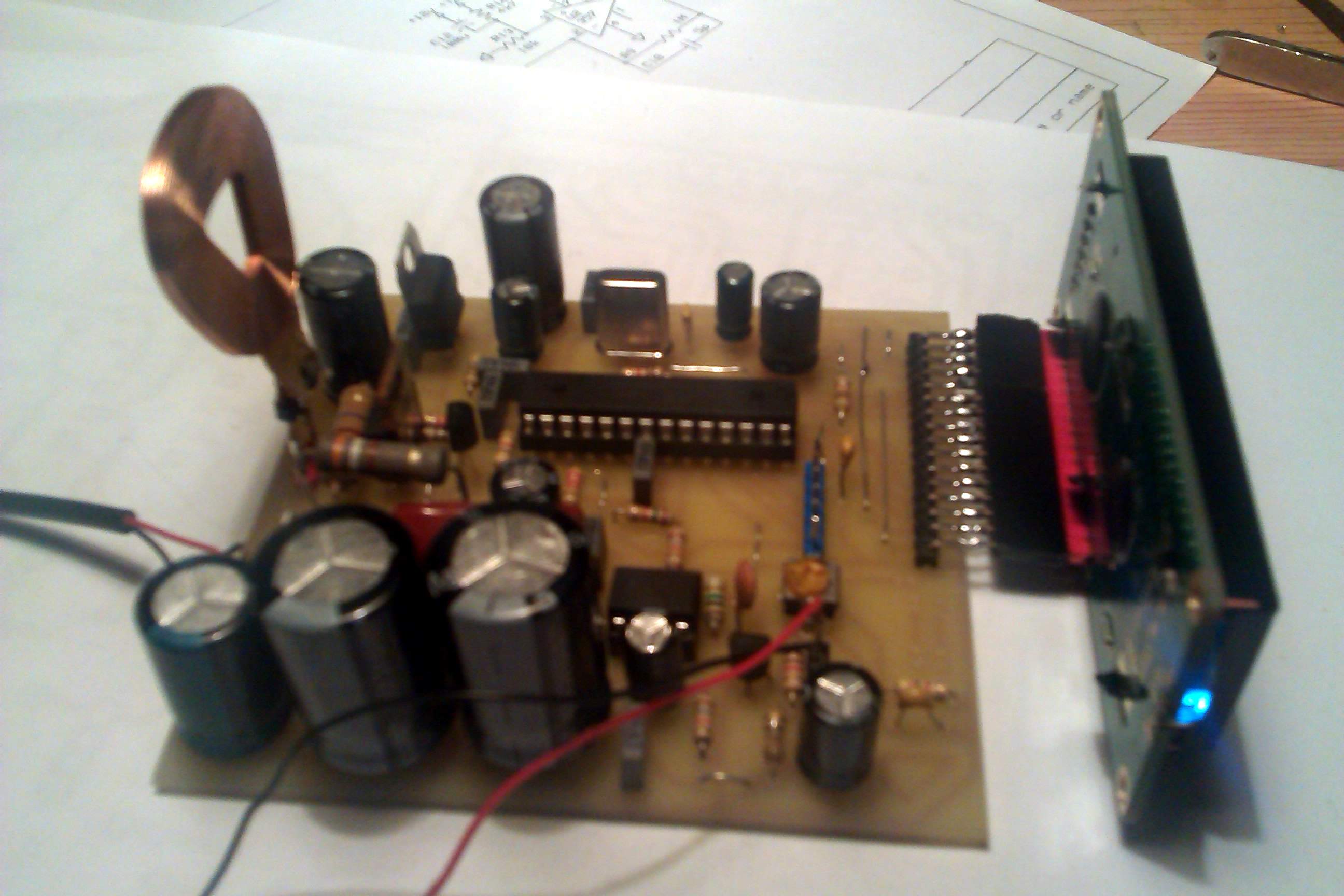

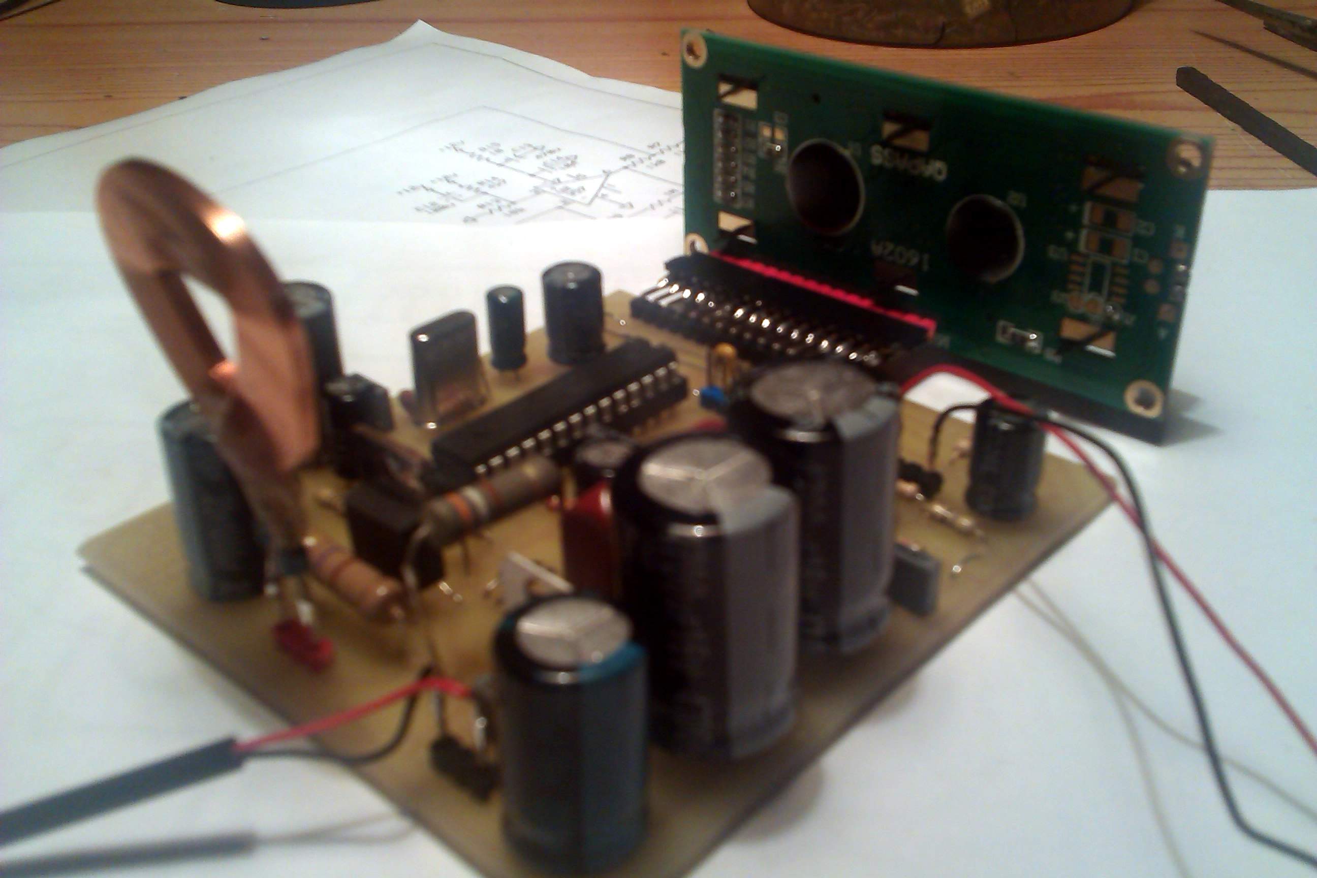

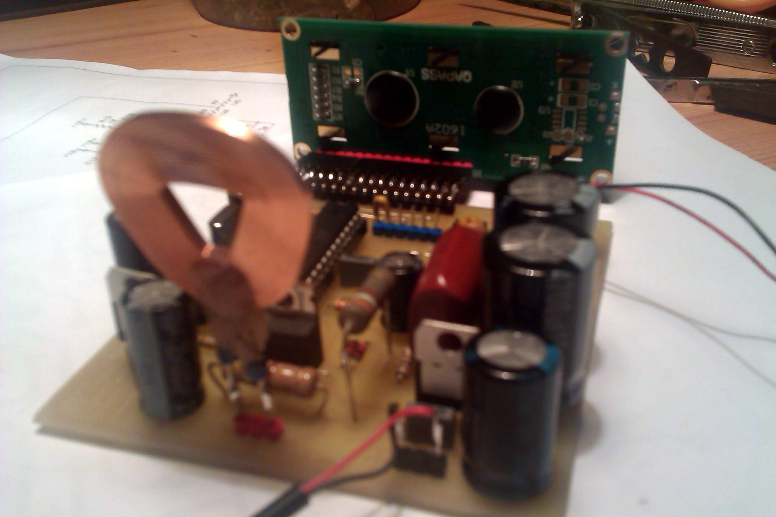

                            • Finally i got some free time to finish "standalone" (no Arduino) version of this PI.
                              I made it on my own pcb, don't like the proposed one.
                              Ok, it is alive and kicking.
                              But it sucks BIG TIME with standard 28cm coil.

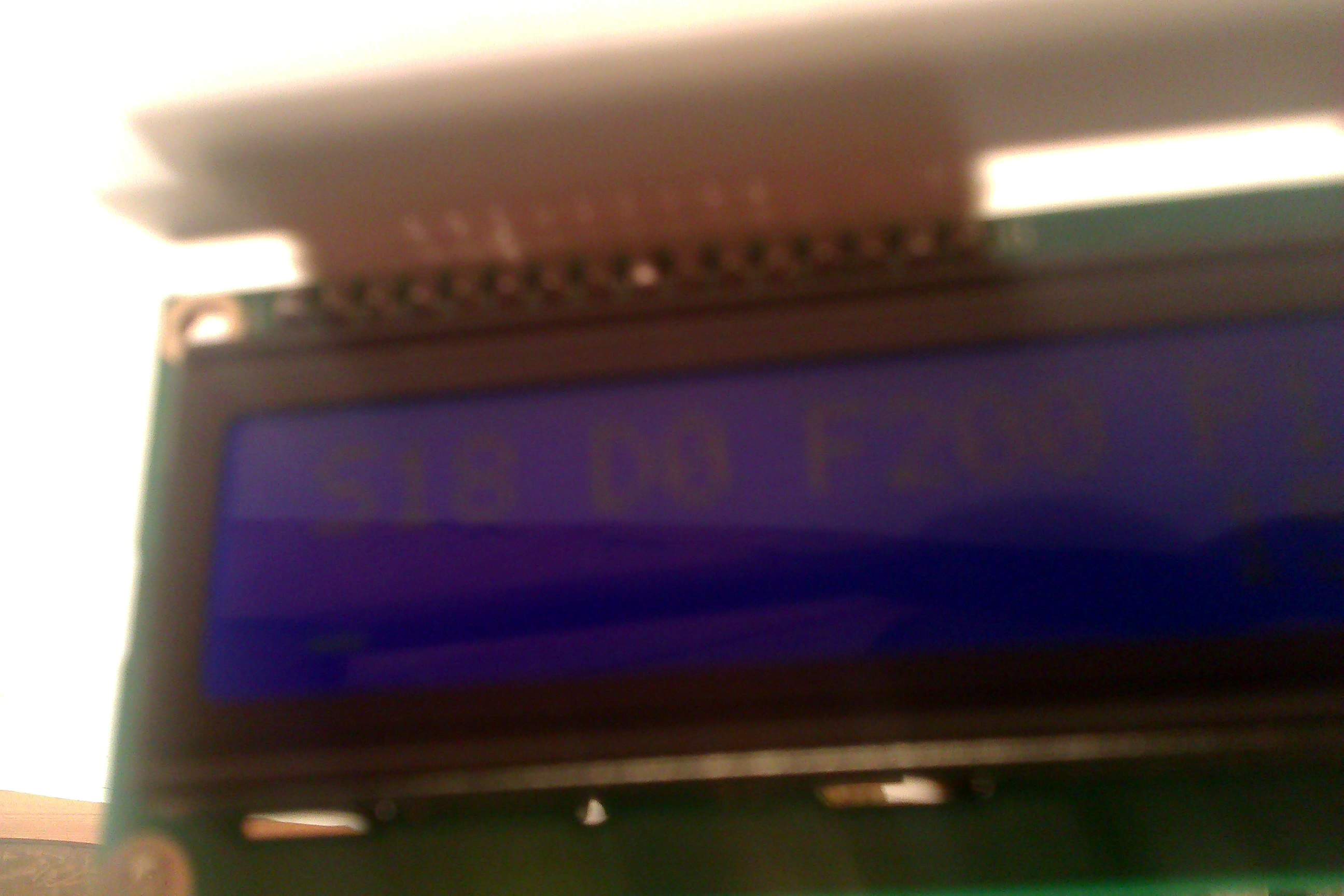

                              There is very short "Balancing..." sequence displayed on LCD after switching up the detector, it shows up and disappear fast. So, it's some "balancing".
                              Which gives me idea that author f'cked up BIG TIME in code with it. Because obviously this detector is not working acceptable with "smaller" coils.
                              After trying with 28cm coil i replaced it with tiny and small coil from previous experiments, showed on my video earlier.
                              It's a small coil salvaged from old 5.25" floppy. Completely irrelevant with it's specs, i just used it than to skim test the circuitry.
                              And now i was surprised again; detector shows bit better performances with that "midget" coil than with standard 28cm coil??
                              Ha, ha, ha!
                              This will need bit more effort... i am sure.
                              Any other experiences?

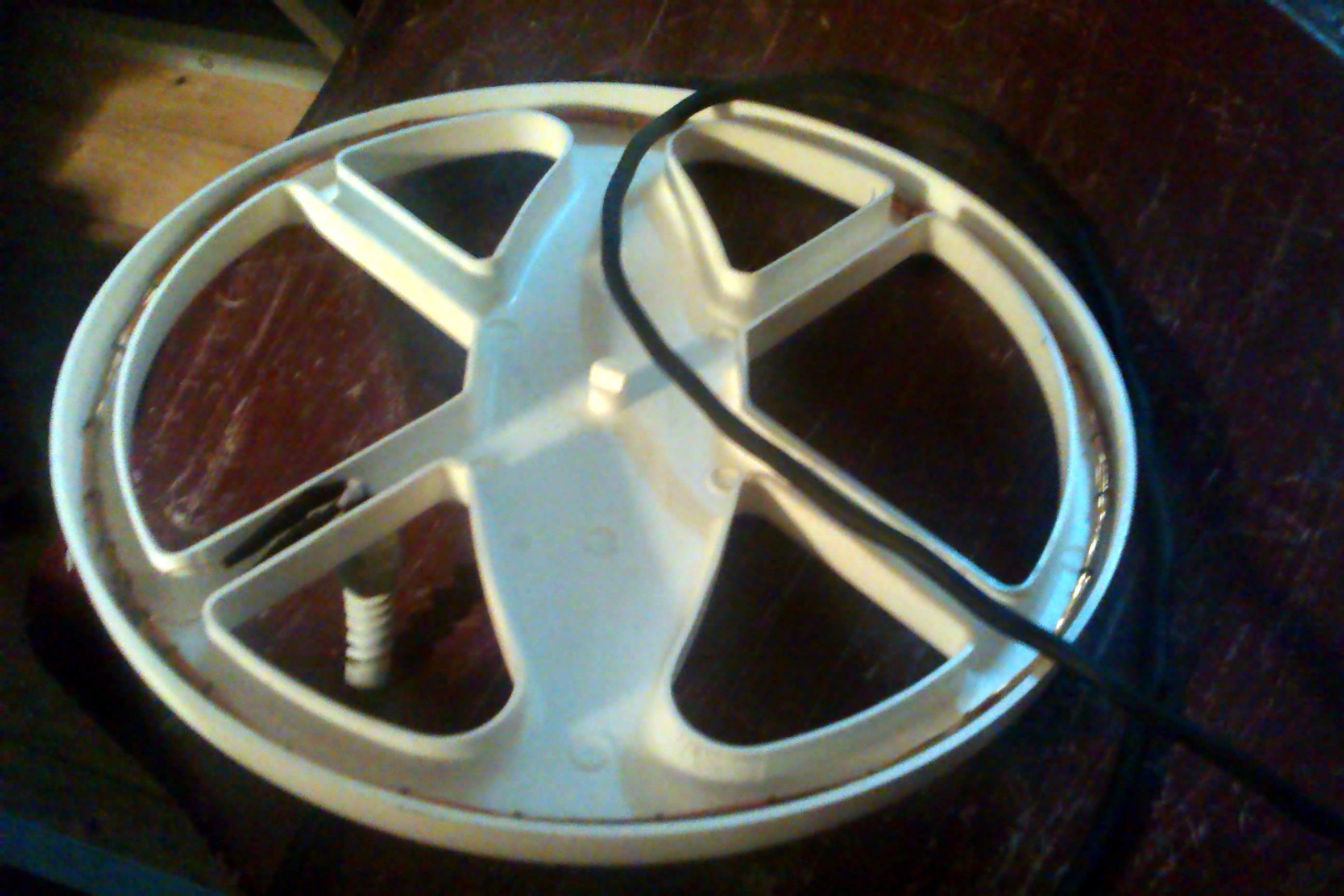

                              • Reading whole topic again; i see that coil must be made more precisely in this case.
                                Most probably i am getting bad results because of coil here.
                                Ok, this will be checked soon.
