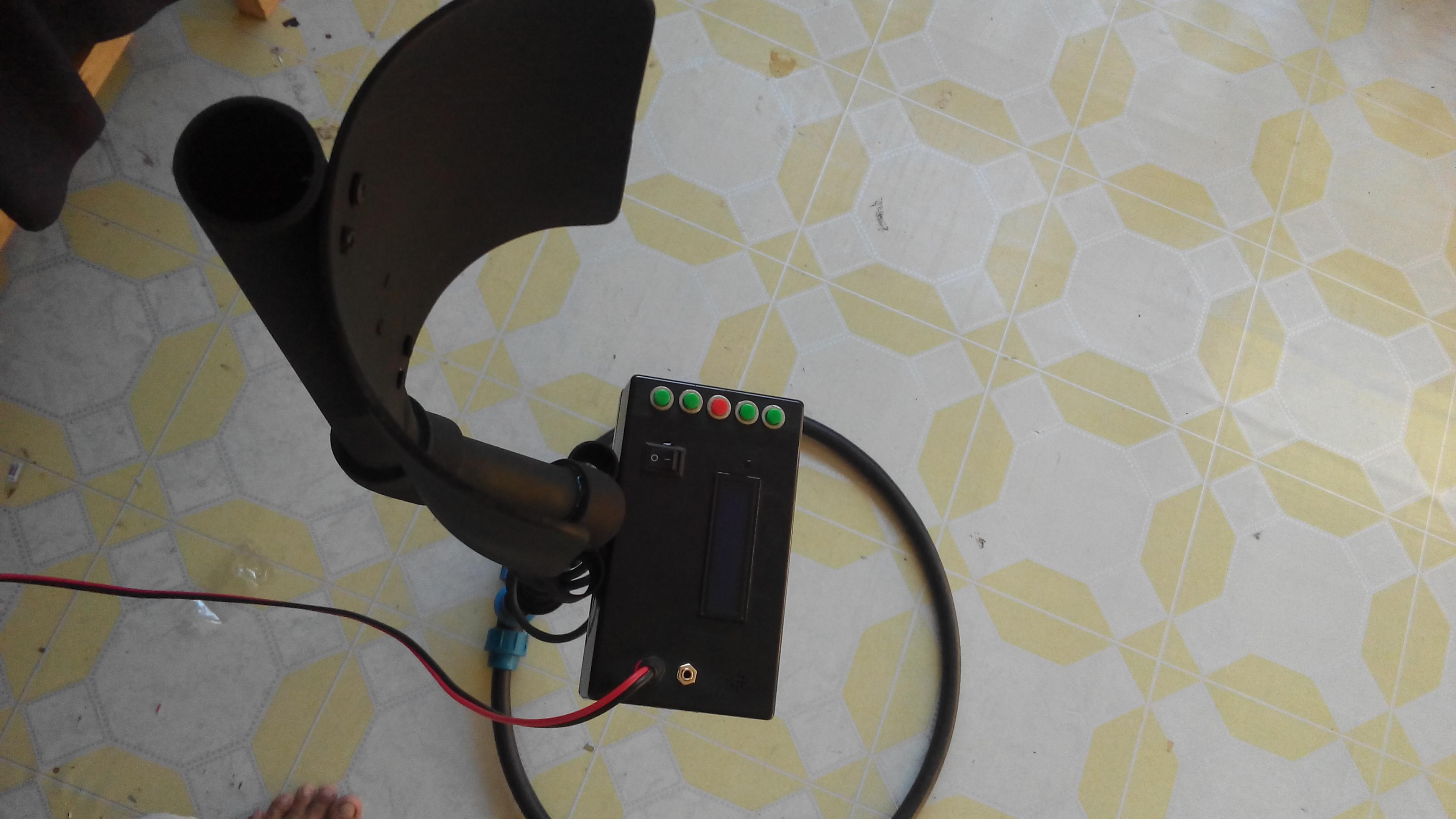

                              I been go hunting last few hours in a known high mineral soil area and found out that felezjoo pi is useless in such area..setbthe detector to the lowest sensitivity, integ., speed, and highest ground and iron rejection but still the detector screaming when lay down few inches to surface.
                              • Originally posted by jladre View Post
                                [ATTACH]34469[/ATTACH]
                                That‘s bad news......but thanks for your sharing.
                                Maybe it's just a toy, and wasn't quite that good as theory!!!
