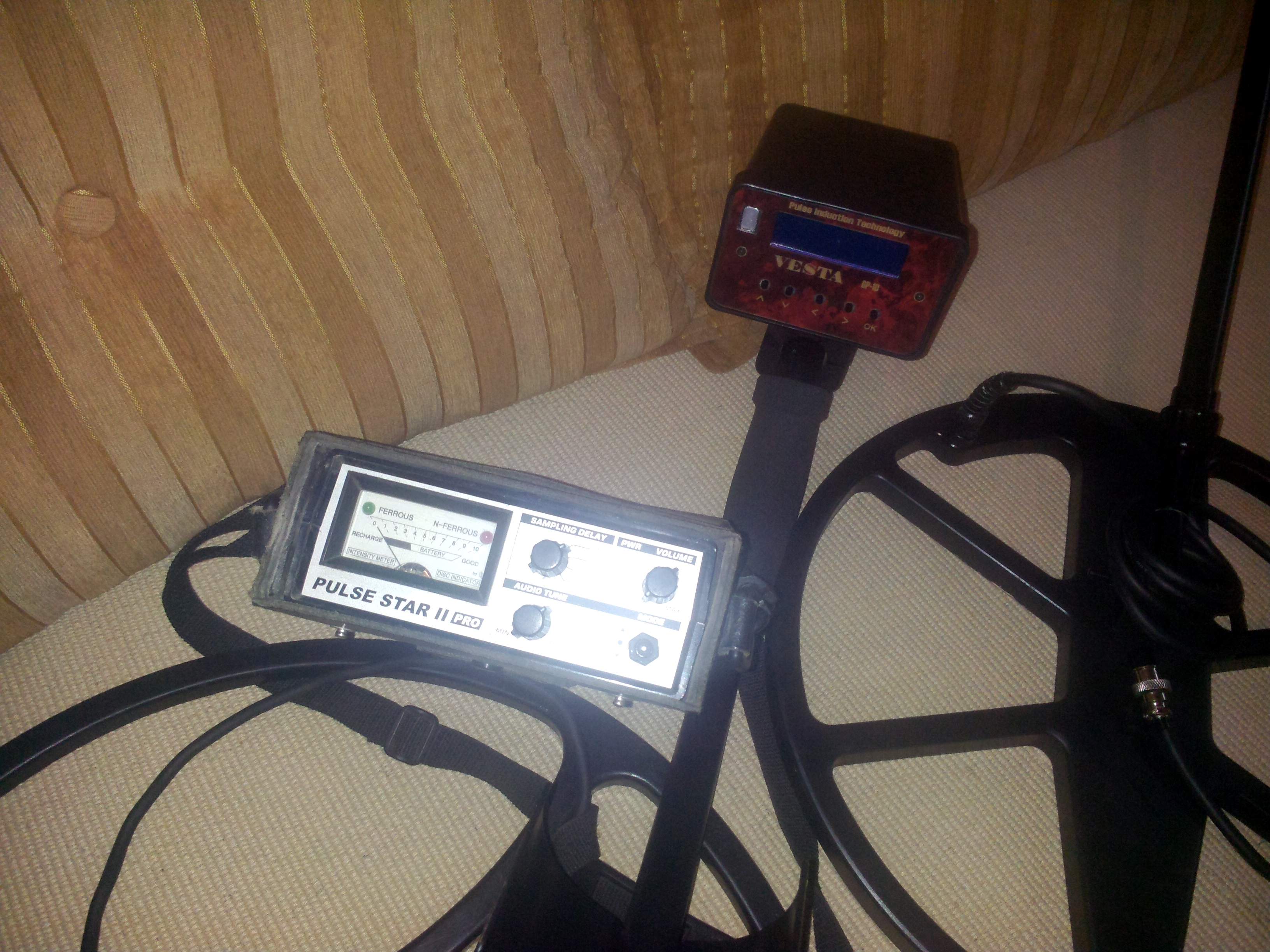

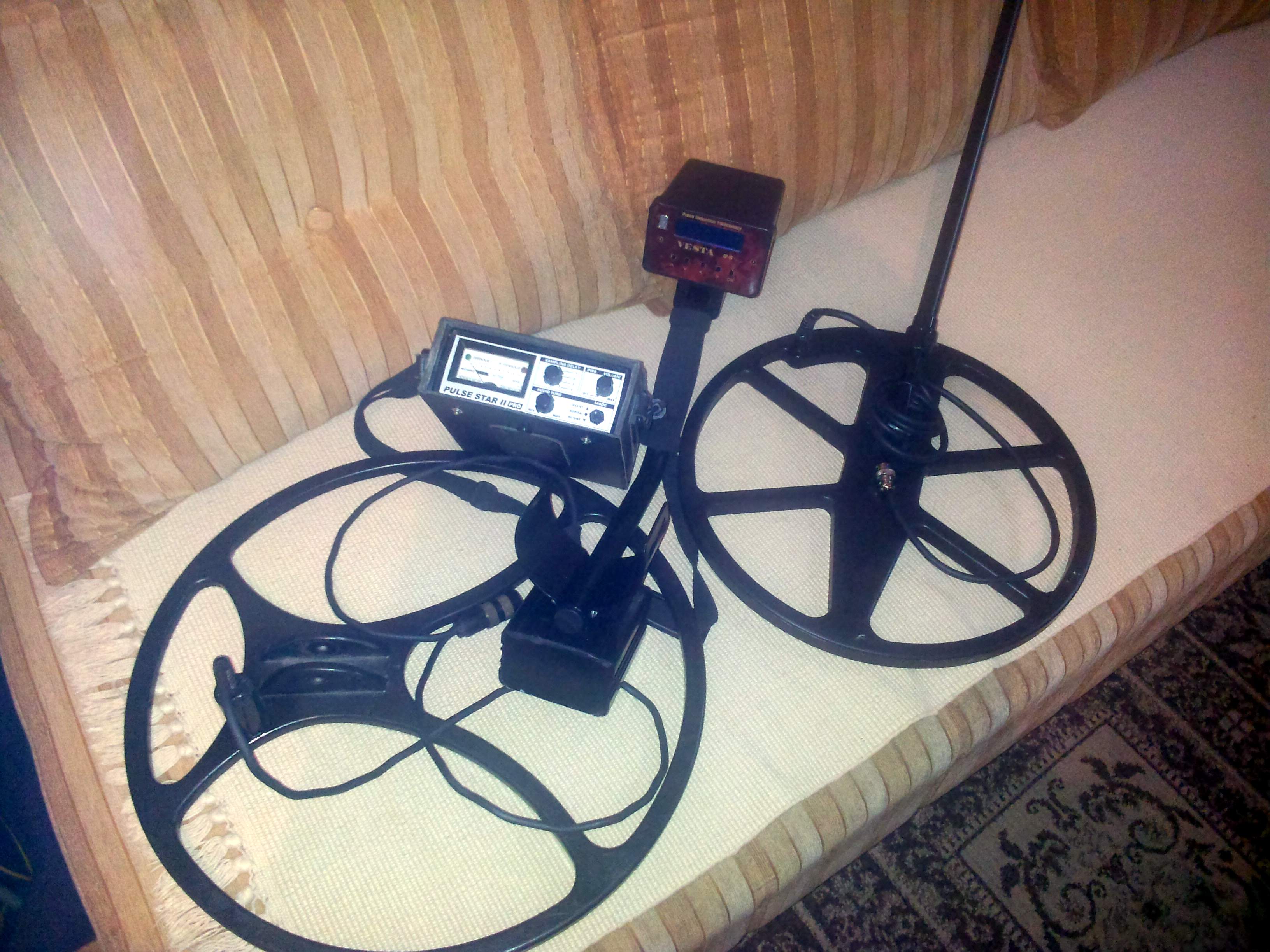

                            • As reference for testing various PI detectors usually i am using Pulse Star II Pro.
                              So, now, FelezJoo beats up PSIIPro on small and medium sized objects, easily.
                              Those two;
