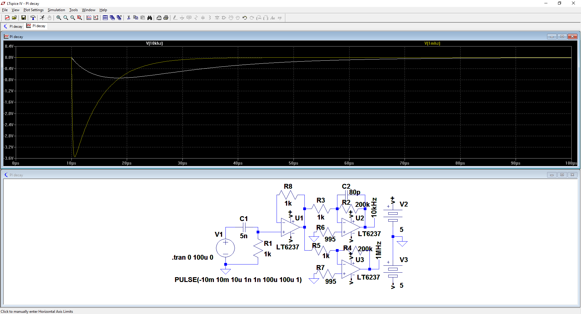

              A example of a target with a 5usec time constant. One circuit has a 1MHz response, the other 10kHz. If sample before 9usec the 1Mhz circuit has higher amplitude, sample later the 10kHz circuit is higher. Don't know if the PI circuit acts the same.
                        The 1MHz circuit will pass the signal almost unchanged, but the 10kHz circuit responds more slowly due to the 80pF capacitor in the feedback loop, thus turning the opamp into an integrator.
                        Interestingly, if you remember this post ->
                        http://www.geotech1.com/forums/showt...228#post162228
                        I attached an LTSpice simulation of John Alldred's full equation minus the dimensionless scale factor (which is close to unity).
                        A slightly modified version is attached here, where:
                        t1 (sample pulse delay) = 9us
                        t2 (sample pulse width) = 30us
                        is the value along the X-axis.
                        There are two .step commands you can uncomment:
                        The upper one sweeps the sample pulse delay from 1us to 10us.
                        The lower one sweeps the sample pulse width from 10us to 100us.
                        Green - you see a similar 'delayed' response in the results where a longer sample pulse delay is used, which is effectively the same as increasing the integration time.
