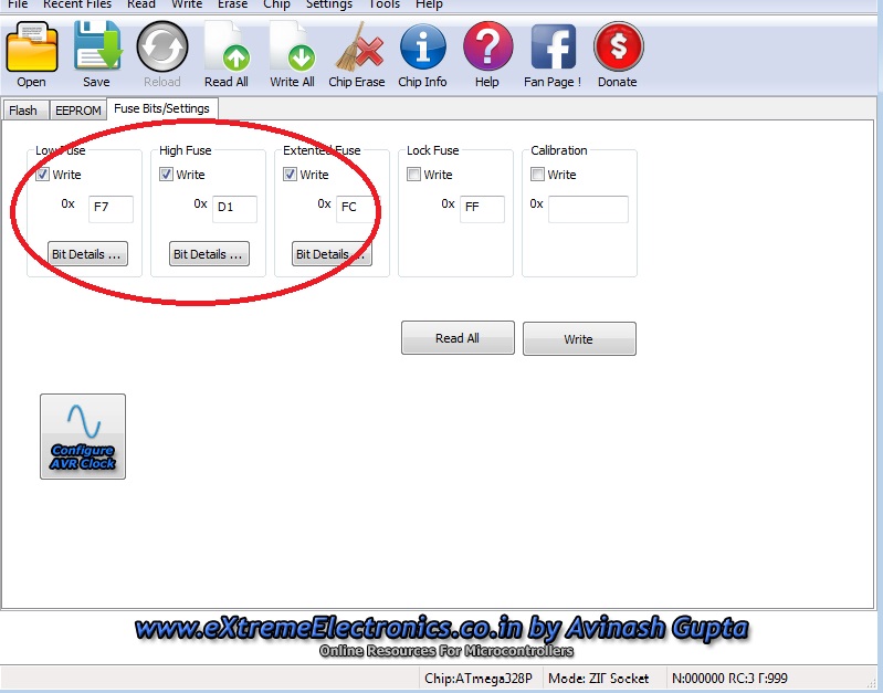

                • Hi,
                  I like this project, so I decided to build it!
                  Just a question: how fuse bits must be set?
                  • Originally posted by Altair View Post
                    Low Fuse: F7 High Fuse1 Extended Fuse:FC / /To maintain, settings stored inside the micro-:
                    Low Fuse: F7 High Fuse9 Extended Fuse:FC / / To reset, save the settings and reset limits on frequency of use:

                            • Fuse bits.
                              • Thank you RS_Phil and 6666 for fuses info!
