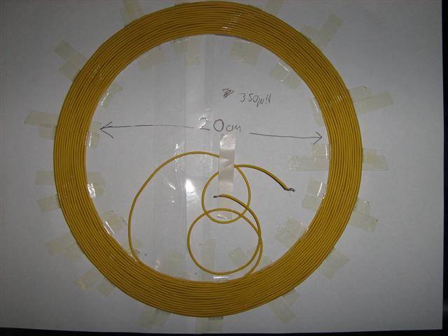

          • hi ivconic
            uh coil value 550-600
            • Originally posted by gurdal View Post
              hi ivconic
              Adjustments like these: "S11 D44 F642 P155"
              are more suitable for faster coil. (delay of 44 is inappropriate though)
              Try adjustments which i suggested earlier and see the differences.
              Though; your coil looks like standard coil with larger inter-capacitance.
              Better if you make basket coil or coil with stranded wire, with more space between windings.
              Keep inductance bellow 500uH by now. Something between 300-500uH.

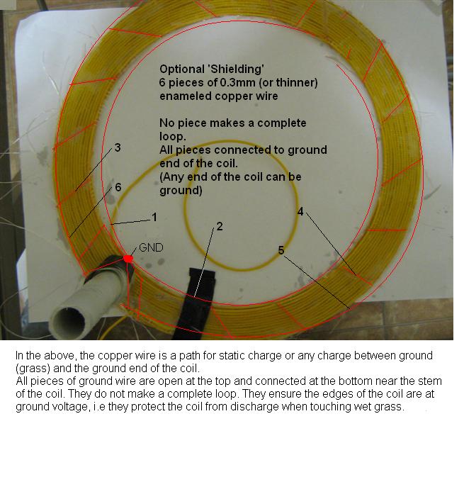

                            • Originally posted by jladre View Post
                              Just make like this depend on your area. I used it at white beach so i dont need shielding. [ATTACH]35853[/ATTACH]
                              Thank you!

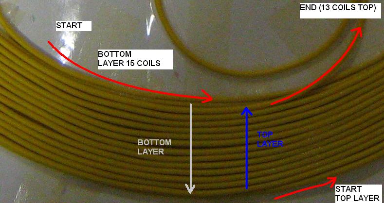

                              My idea is to build a fast multilayer spiral coil with shield, now I am studying how!
                              • My idea is to build a fast multilayer spiral coil with shield, now I am studying how!
                                This may give a clue.
