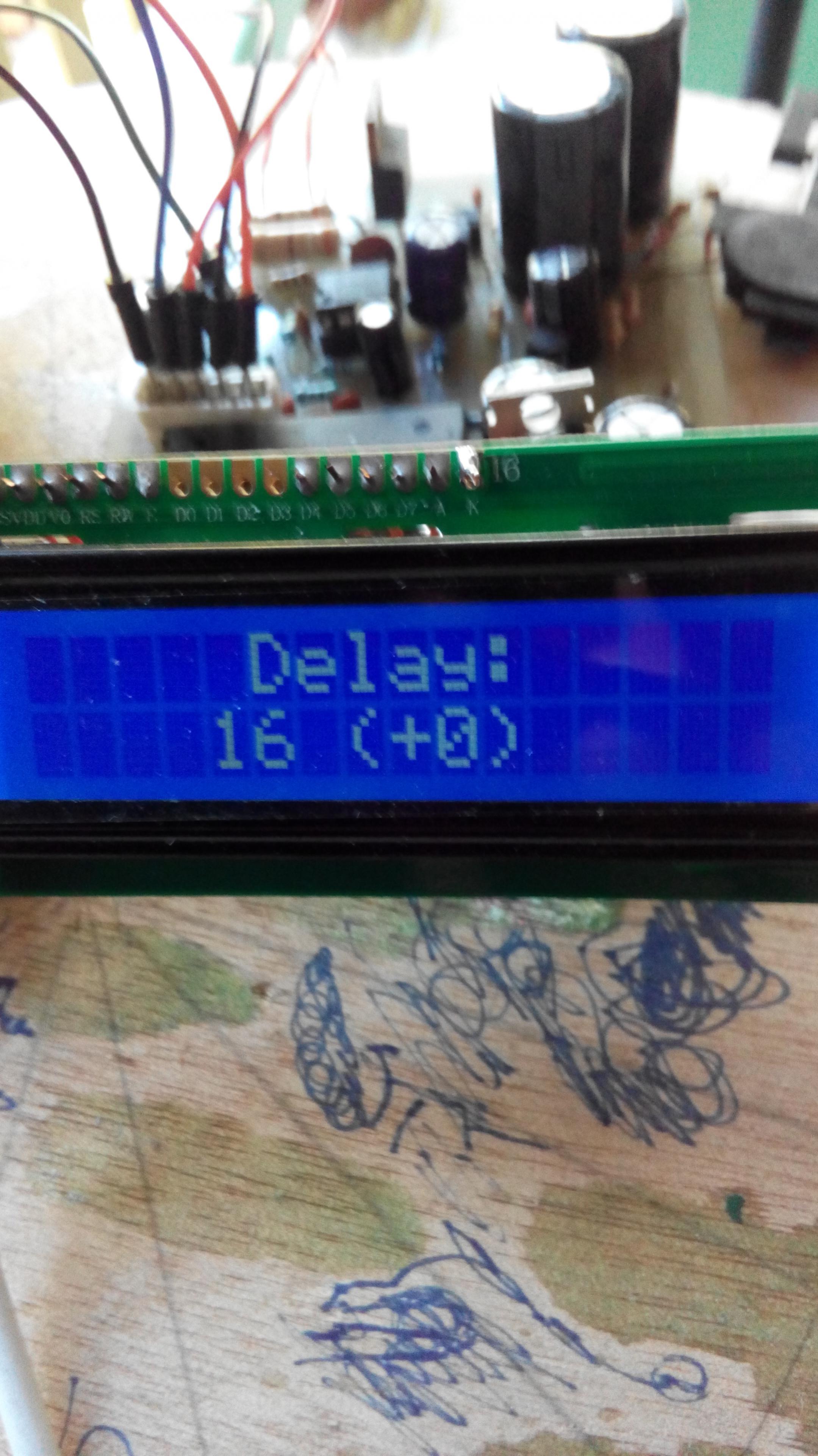

      • How do you set the delay to auto? Is this option available in V3.30, as I seem unable to find it?
      • What is your Iron Reject setting?
      P.S. I've just noticed ... if you press the Down button, it displays 19 (+0) when the delay is set to zero. So I presume this means the minimum delay setting is 19us, and the delay setting in the menu represents a positive offset to this value. Is this correct?
      the delay 0 is the auto mode. its not actually always 19 because it vary on your coil(coil&cable) my old coil got 18 (+0) sold coil 10(+0)and the new got 16(+0). iron reject setting also vary in the coil. one of my coil set on 13 the other is 16 and another of my coil set to 23.. screen shot below

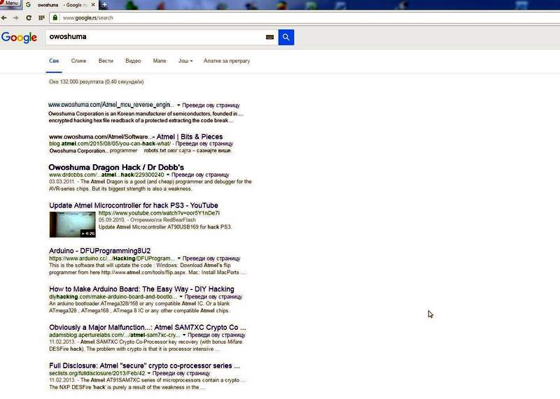

          I cannot find any result on google for Owoshuma soft ...

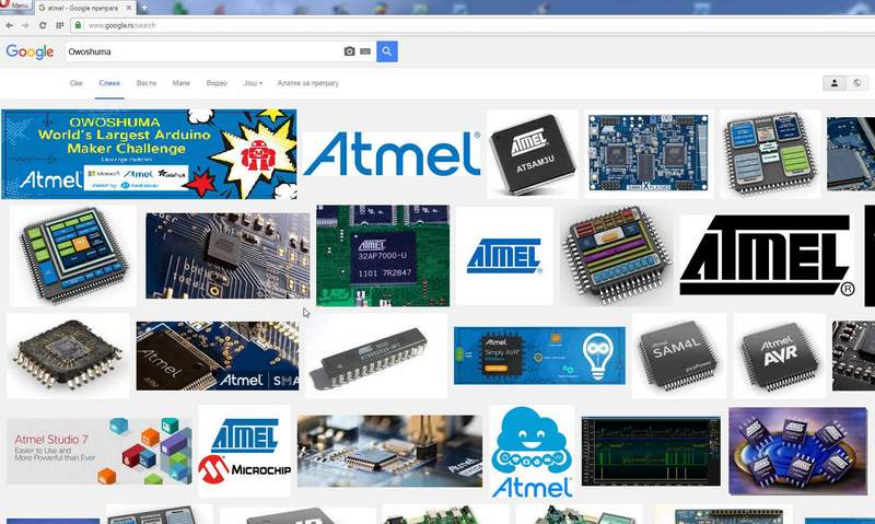

            • Originally posted by reptooyep View Post
              It looks pretty cool. I love HEX editing but HXD is too hard to work with.
              Strange?
              I guess it's up to the firewall of your provider.
              Some countries are having really strange policies upon net surfing, kinda "Orwellian" situation.
              Same thing also on torrent sites.
              Luckily some of us are still living in a free world:

              • just found out that 16 us delay displayed on my lcd is actualy 8us on oscop. not accurate.. anyway it's time for vacation.. hunting in the south..

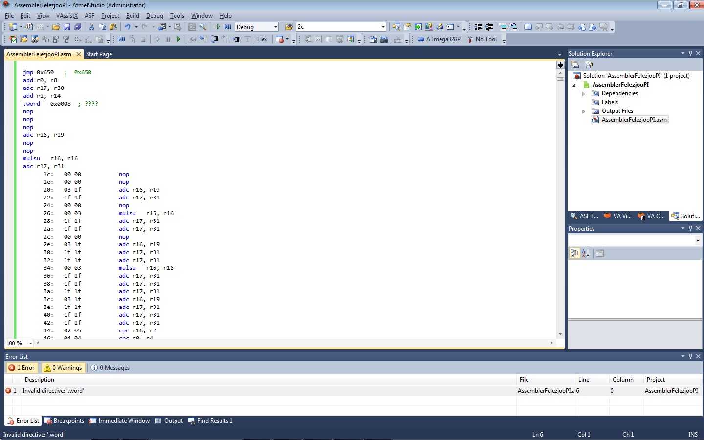

                  Hi Ivconic,
                  I'm realy puzzled with ATMEL studio 6 ..
                  What i did is dissassemble the file using CMD and the command "avr-objdump -j .sec1 -m avr5 FelezJoo_pi_v3_30.hex > Felez.txt"
                  Now i have a file containing all adresses and the asm code for each adress.
                  I copy/past in a atmel studio asm project, i keep just the asm code (which is very long to do). Some of the statements are not recognize by ATMEL (although they appears in blue) :
                  I did that to have the opportunity to use the debugging cause when i open the .hex file directly by "file-open" in ATMEL, i cannot do anything (the file i see in not disassemble). I don't have acces to the debugging functions (need the ASM file ??).
                  Is ther a simplest way to do that in ATMEL STUDIO 6 ?
                  I'm realy interrested into your owashima soft, could you share a domnload link please, i tryed everything but my reasearch does not give any result, even with THOR BROWSER !!

                    I can't share software, it's internal company property, sorry.
                    But nothing special with it. Any other will do the same.
                    If you want to see textual strings within hex file; you have to convert it to bin format.
                    But plain editing those textual strings will lead you to nowhere.
                    You have hex2bin, bin2hex, avr-objdump, disavr... and plenty more tools available.

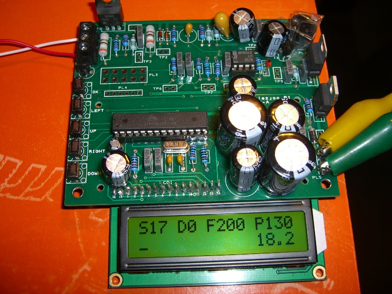

                          Here's a photo of my Felezjoo -> Click image for larger version
Name:	Felezjoo PI PCB.JPG

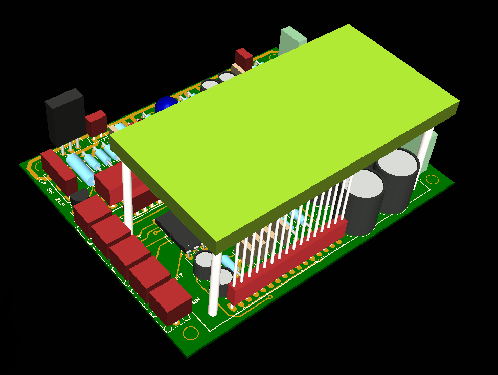

                          I designed a new layout that has the tactile switches on the PCB and/or off the board. Plus the LCD was meant to mount on top of the PCB, as shown in this 3D representation -> Click image for larger version
Name:	Felezjoo PI with LCD.gif
                          However, the available capacitors were taller then expected, and the LCD pinout was different. Hence it was mounted on the end. It was only an experimental PCB anyway, so no problems.
                          With my 300uH coil I managed to get some settings that will reject an iron bolt and accept several coins, but some silver coins were then a bit iffy. I also probed the TX oscillator signal with the scope. I was expecting to see sets of pulses, maybe varying in width (after seeing your scope shots) but the pulses are actually all the same width (as set up in the menu). It seems that your PC scope is having a problem sync'ing because there are gaps in the transmission, presumably because the processor is busy doing something else, such as updating the display. As far as I can see so far, there's nothing magic going on here. It's simply some sort of conductivity discrimination based on sampling around the decay curve. The Earth field rejection works very well though. Also need to try the ferrous discrimination with different sized targets.
                          The interesting thing that has come out of this is that the LF357 is quite a lot faster than the NE5534 (or NE5532). However, comparing a single-stage preamp with an LF357 against a NE5532 as a 2-stage preamp, there is little difference if any.
                          Originally posted by jladre View Post
                          just found out that 16 us delay displayed on my lcd is actually 8us on oscop. not accurate.. anyway it's time for vacation.. hunting in the south..
                          I'm not sure where you could possibly be measuring the actual sample delay for this detector, since it uses direct sampling, and hence the actual sample delay is hidden in the software. I suspect you are looking at the preamp output, and making a presumption from there. In which case the value displayed on the LCD is most likely the correct one. With a 16us sample delay, any target with a TC of less than 3.2us will have completely died away before sampling takes place. As far as I can ascertain, the detector continuously changes the sample delay, not just at switch-on, by checking when the preamp comes out of saturation. You can see this yourself by placing the coil near some metal, and then displaying the delay setting by pressing the Down button.
