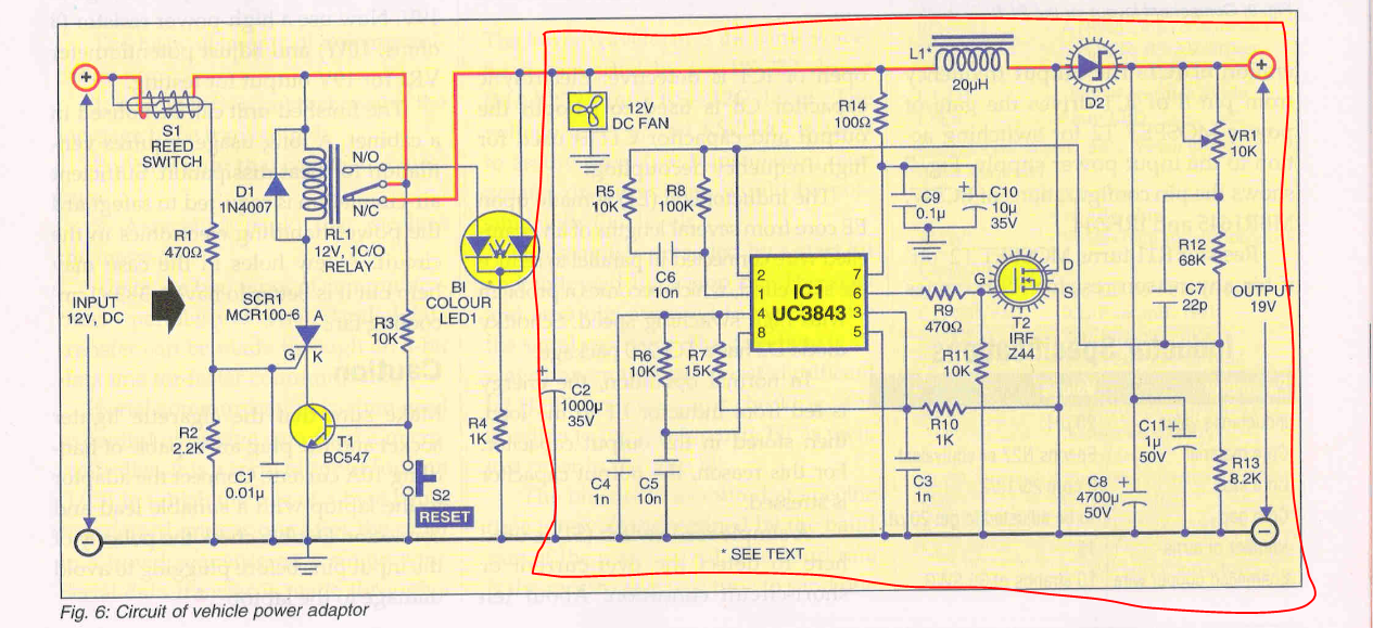

            • Did anyone try used dc-dc converter to out 18-19 volts with thier 12 volt batt? or better solution is to remove 7812?

              • Originally posted by RS_Phil View Post

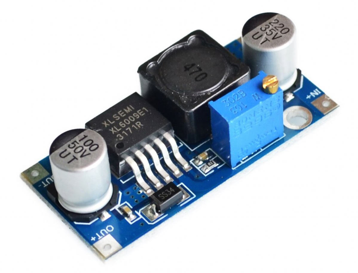

                I am using gel cell accu 12V/1.2Ah with addition of this one:
                At first i used two 18650 with same dc/dc but those last not more than 20 minutes !
                Than i replaced them with gel cell accu and it is BINGO!
                    [ATTACH]36064[/ATTACH]
                    Thanks Ivconic for the info..

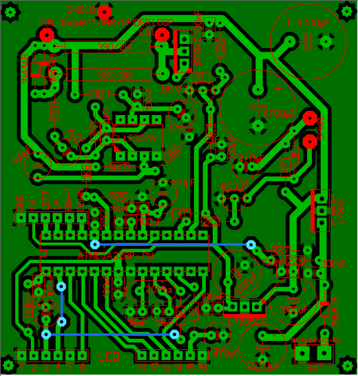

                      Maybe there is physical error on your pcb? Which one have you made?
                      And finally maybe you are using corrupted hex file?
                      Here are all the working and tested versions that i have, try each one of those and see:
                      Thanks for your link, i tryed several download sources and also several softwares to unzip the hex file but still the same.
                      I also tryed with ATMEL ICE programmer which is not as convenient as usbasp for those chips.
                      Finaly, i'm tired of tha problem, i'll try later to make a new board.
                      The version i made is this one :PCB1.pdfPCB2.pdf
                      I think i'll download the latest version of the PCB and, in parallel, i'll make a new SMD one and share it.

                        The version i made is this one :[ATTACH]36065[/ATTACH][ATTACH]36066[/ATTACH]
                        I used same board but I see no problem..

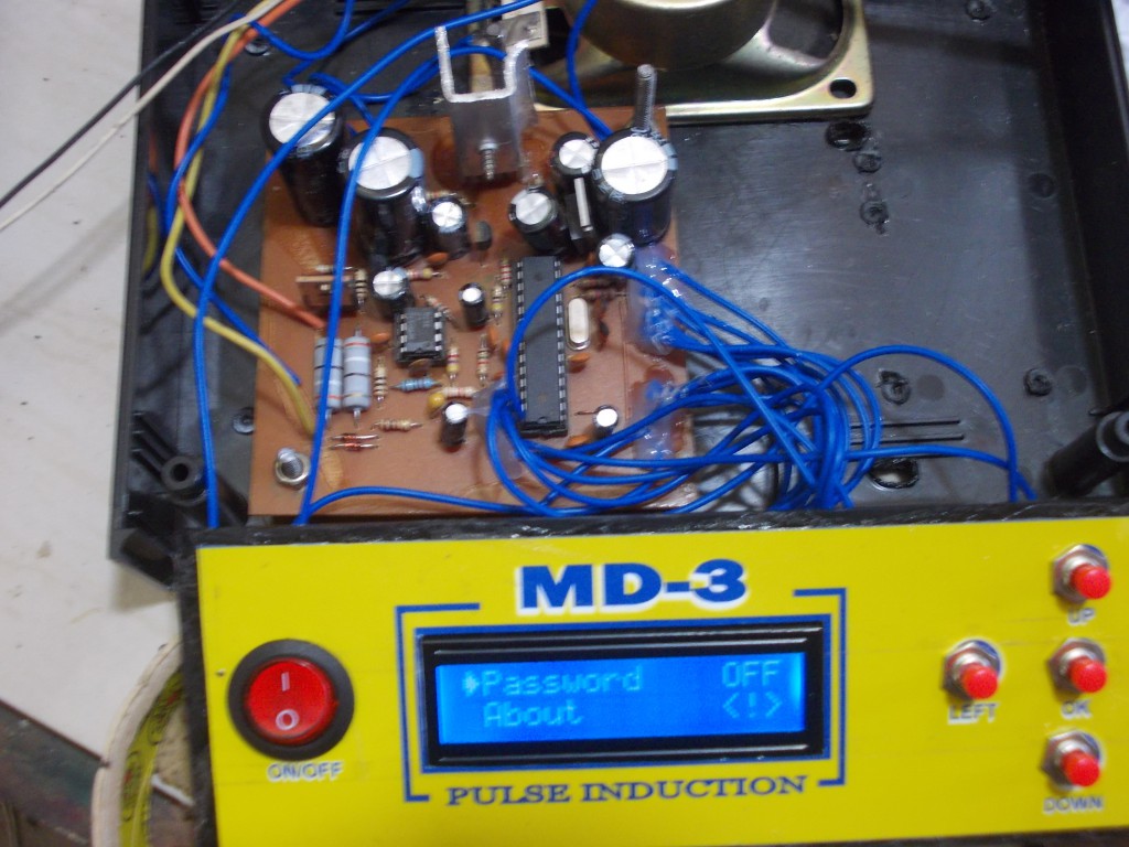

                          your speaker looks like from old dvd player?
