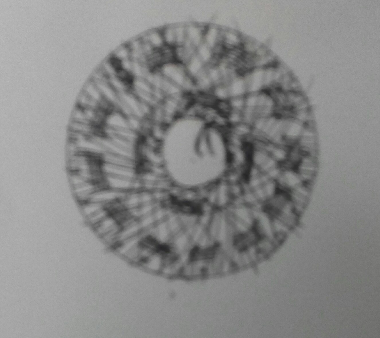

ID:	346002 a little clue
      • Originally posted by jladre View Post
        [ATTACH]36496[/ATTACH] a little clue
        Thanks but its a bit out of focus could you please take the picture in focus thanks
        • maybe i can make it better next time

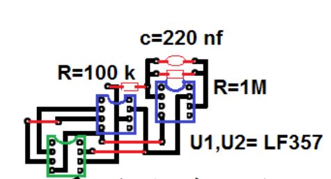

          • people in persia are arguing to this so called 2 stage amp designed.Click image for larger version
ID:	346023Click image for larger version

                  • The "2 stage amp" shown in #980... I don't get it.
                    What is it? Voodoo? An idea to get rid of your precious LF357s?
                    This circuit - the way it is pictured - will do exactly nothing to your signal, however it will most likely heat up (and potentially destroy) the second LF357...

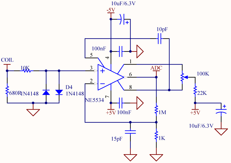

                    • Originally posted by selim View Post
                      10K is going to be a hell of a noise source.
