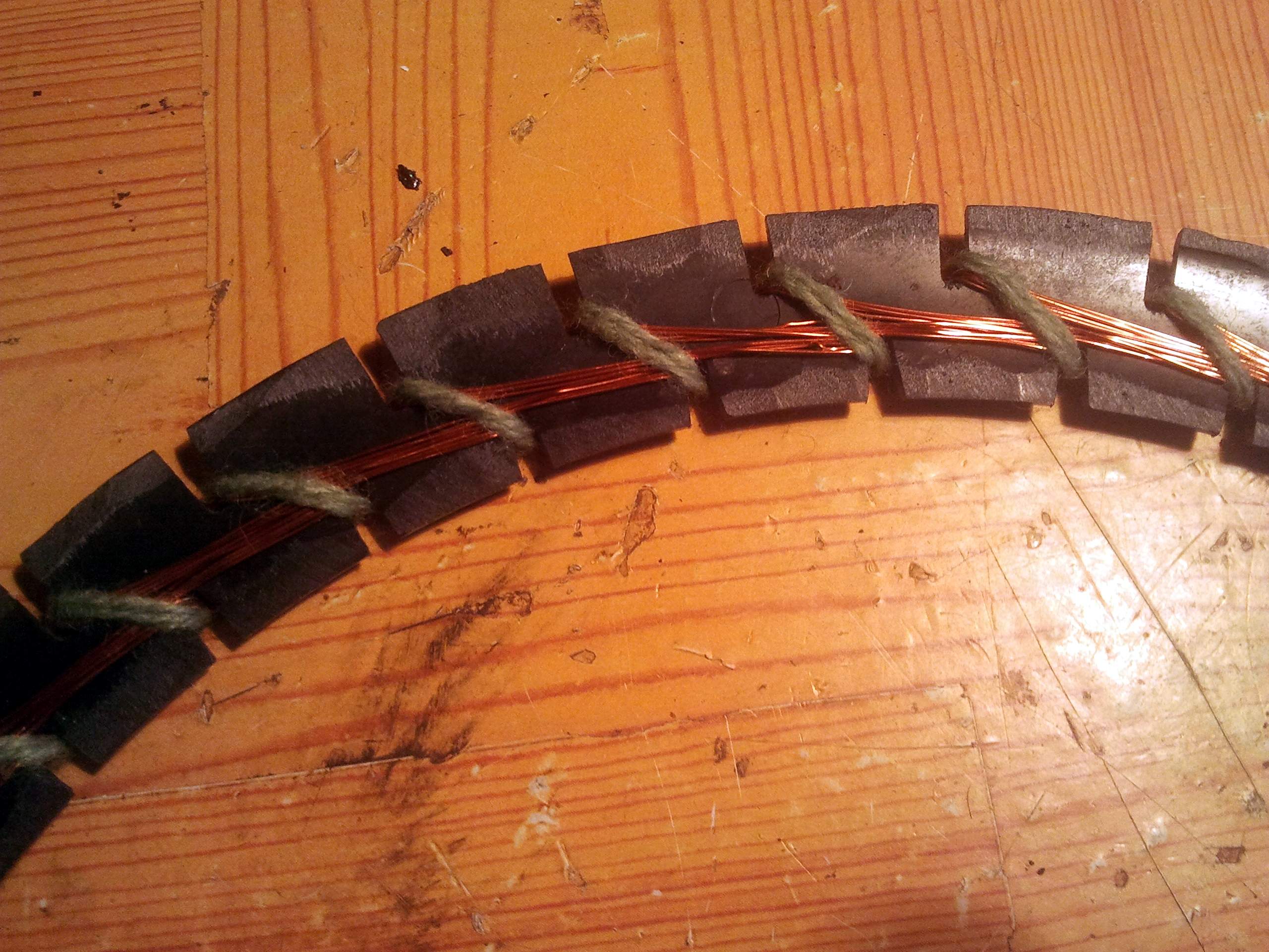

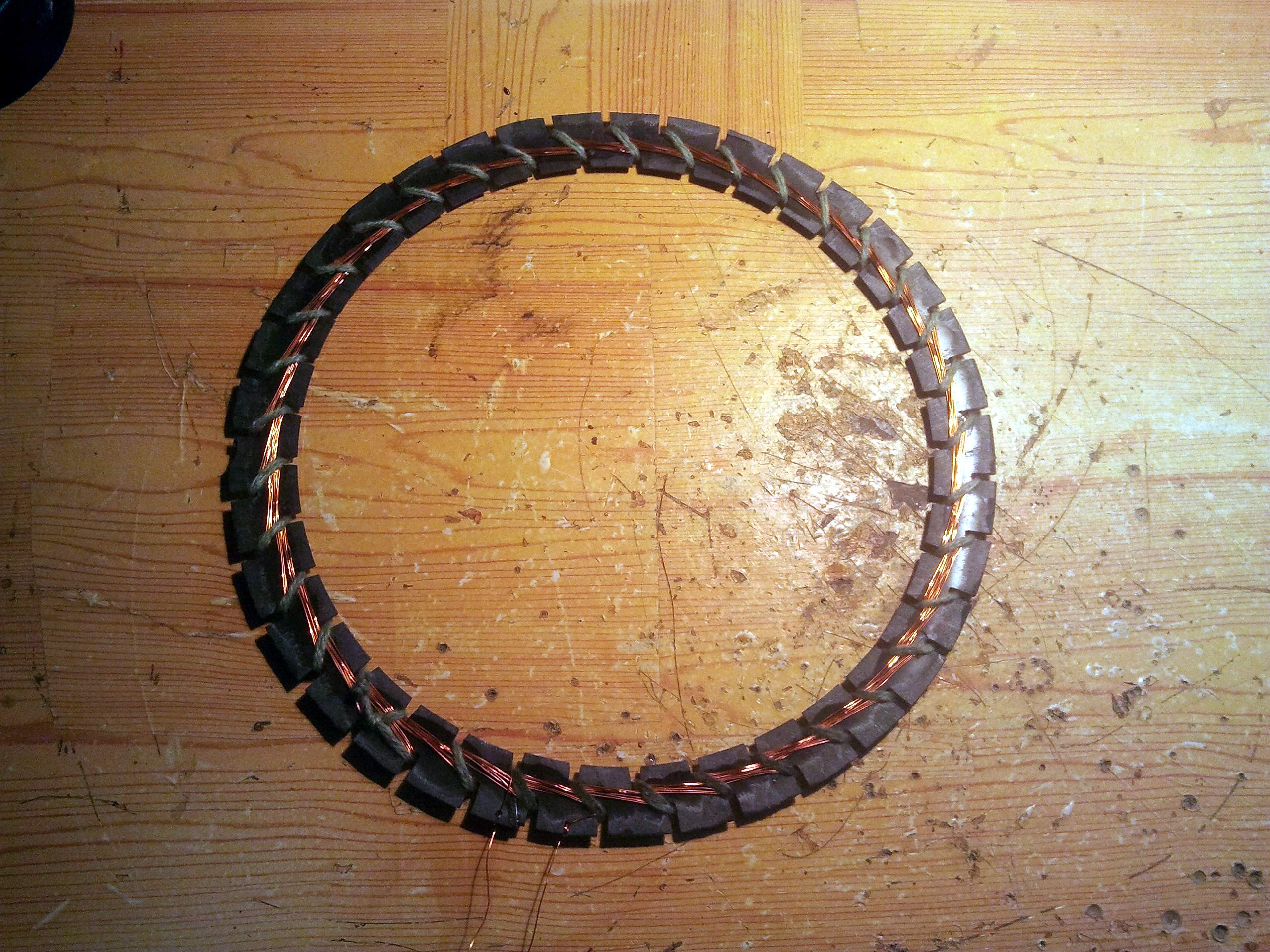

      • That's a half basket or four legged spider coil.
        You have the zig but no zag...
          "...hello if I connect a coil 380 uH coil 38 cm radius with 1 mm wire..."
          1mm wire is too thick for coil with only 38cm diameter, by my humble opinion.
          For 38cm diameter coil i would suggest wire gauge between 0.55 to 0.7mm.
          But for this particular detector; i would not suggest use of single Cu lac wire.
          Inter capacitance is high and FelezJoo PI don't like it.
          Instead use litz wire with common gauge not exceeding 0.55 to 0.7mm, preferably pvc coated (a bit more inter space - much less inter capacitance).
          Or in case if you insist on single Cu lac wire; than don't make conventional single layer coil but do make spider or basket coil instead with it.

          • Originally posted by FatBob View Post
            Yes that's the one of the experimental coils that i made.
            "Full" basket or spider coil is having awkward em filed "geometry" which significantly affects sensitivity/depth.
            Good for small targets ... but on shallow depths.
            So i tried several different setups to see the differences.
