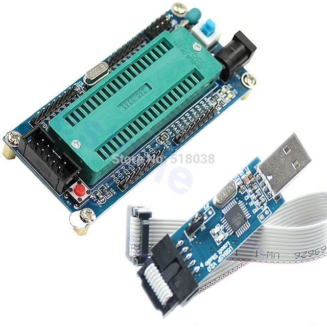

      Of course, that only for personal use. I am a student of EE and electronics is my hobby .
      Only now I noticed that my PonyProg LPT programmer is not compatible with the ATmega328
      http://ponyprog.sourceforge.net/phorum/read.php?2,2261
      • Question
        I could help me is I want to load the hex file.
        my computer to use is a USBasp I'll show you a picture
        but I want to know if I have to change the crystal by one bigger or do with that biene that is 8 or 16 I put one of you who think.Click image for larger version
Name:	A25-mĂ¡s-nuevo-2014-1-Unidades-ATMEL-para-ATMEGA16-ATmega32-AVR-sistema-mĂ­nimo-pensiĂ³n-USB-ISP.jp.jpg

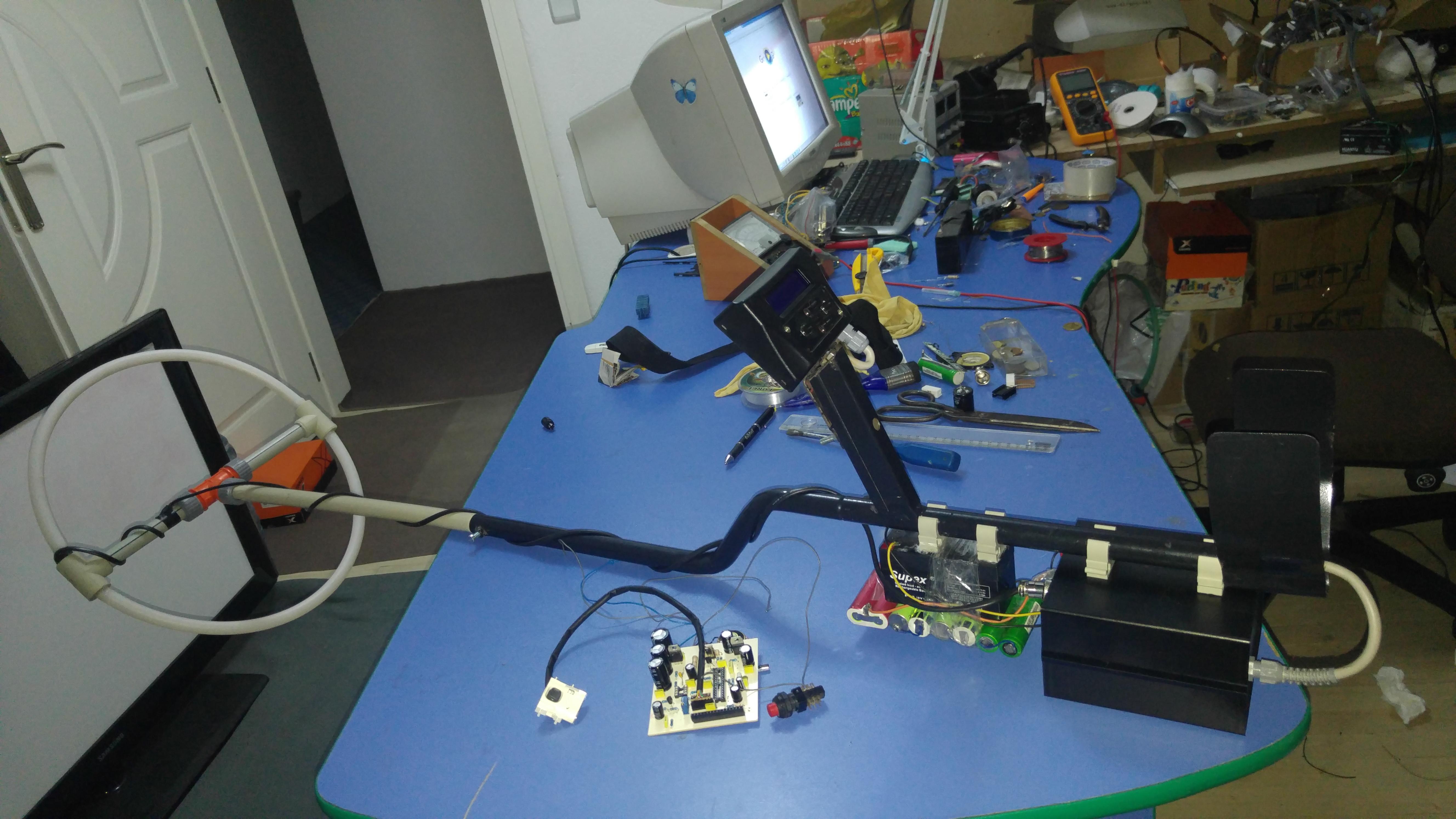

        • is felezajoo can work with 1 m * 1m coil and if so can discrimination used with 1m square coil
ID:	346317Click image for larger version

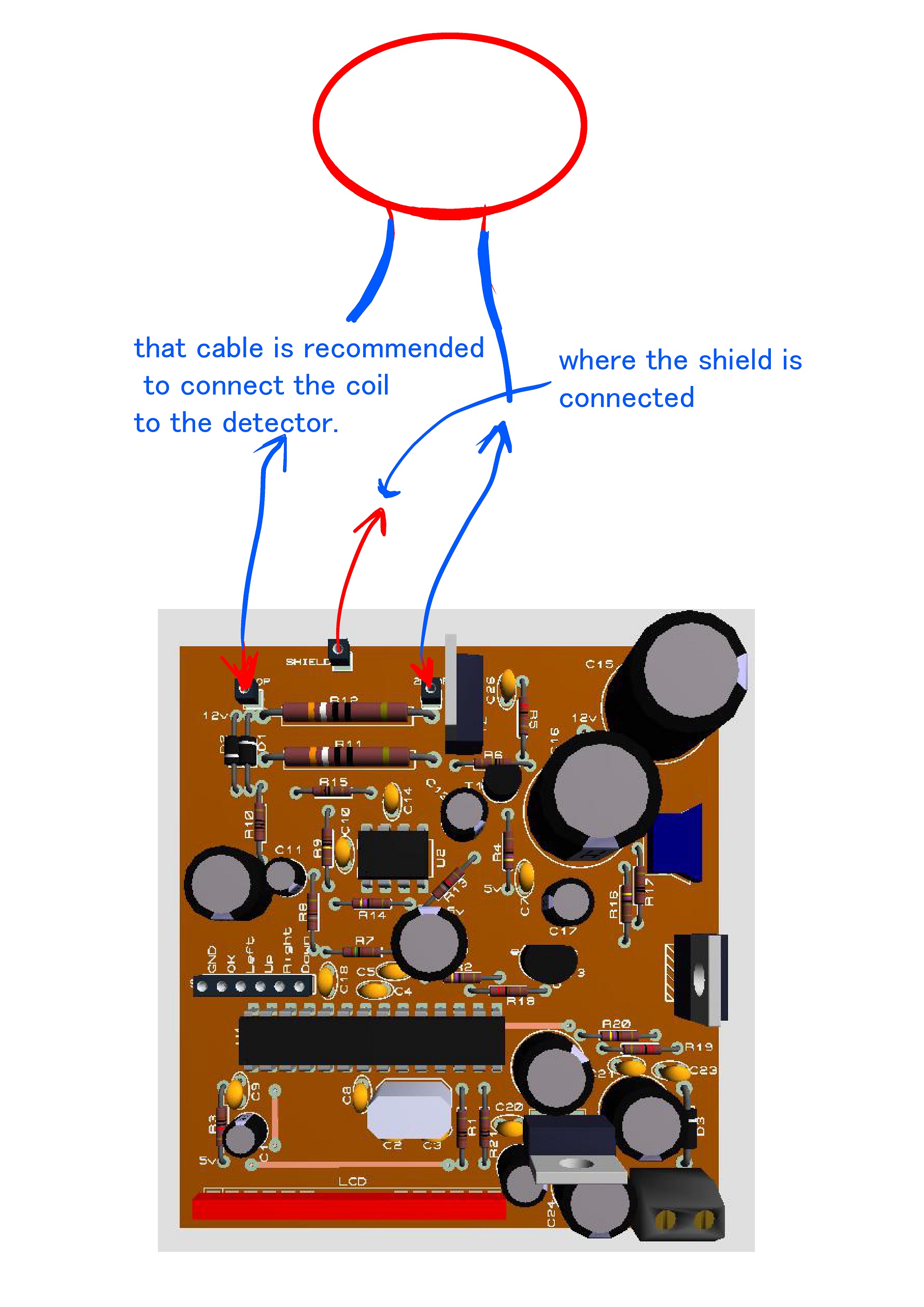

            • coil
              Sorry about my ignorance but could help me,
              It is that I have some doubts regarding this detector.
              1. where the shield is connected.
              2. that cable is recommended to connect the coil to the detector.
              I'll upload a picture.
              the coil nothing I can do really wired network.
              if so what would be the measures of the coils.
              sorry for that bad English.
              • I recommend two wires mic cable with shield like this https://www.google.lt/search?q=TAS-C...WGjoRUvNtUM%3A.

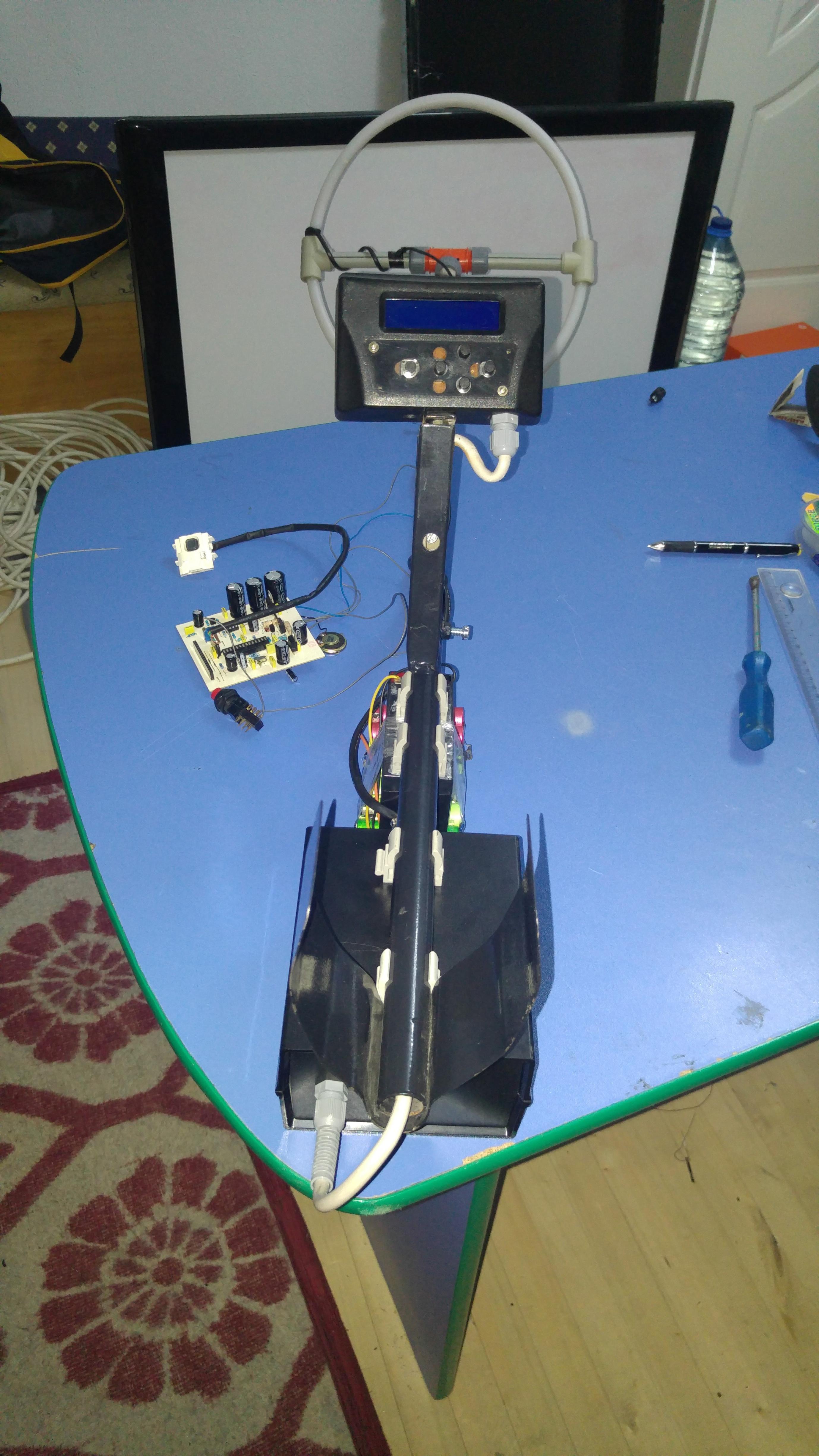

                  • Hi ... I need help my first atmega got burned out ... I flah second one my felezjoo start very slow and keep slow it takes a lot to get to the menu and when i plug the coil the lcd dont start .... I am using combination of 35v 16v and 25v capacitors ... Was working normal before the atmega burn exept lcd dont turn on when i plug the coil .....Hope someone help me
                    • Hi ivconic i need some help and no one is replaying .... I made this felezjoo worked fine exept that when i plug my coil the lcd turn off and sometimes keeps on without detecting the coil after some days the atmega burned out ... Then i flashed new atmega now the felezjoo start slowly it takes a long time to get to the menu and keeps slow entering in options iam using 2 9 volts batteries here it is a picture with capacitor volts i used Please tell me what i am doing wrong
                      • Burn a new one AtMega. I have similar problem. With a uc that programmed by a friend, detector works fine.
                        With 2 ucs who programmed by me the detector is very very very slow. So i need to change the programmer.
                        • SLOW? It sounds like a fuse problem. Could you check your fuse value with extrem burner ? You can also check the quartz and its capacitors.
                          I have the opposit trouble with my unit. It's too fast ... i have to check the keyboard wiring.
                          I'm waiting for your fusse config..
                          • No free time to make checks....
                            Maybe after one week, but i made firmware upgrade to usbasp and i am afraid that i destroy it!!! (as usually)
                            Any way maybe next week to give a try.
                            • I am on vacation now ... I will be at home after 5 days and i will show u the config..... I noticed extreme burner change fuses after flashing ..... But why when i plug the coil the lcd dont start
                              • Originally posted by reptooyep View Post
                                Thanx for help friend now i know the felezjoo is slow because of fuses... My problem now is hardware i think the capacitors voltage are the problem.... That´s why the first atmega got destroyed
