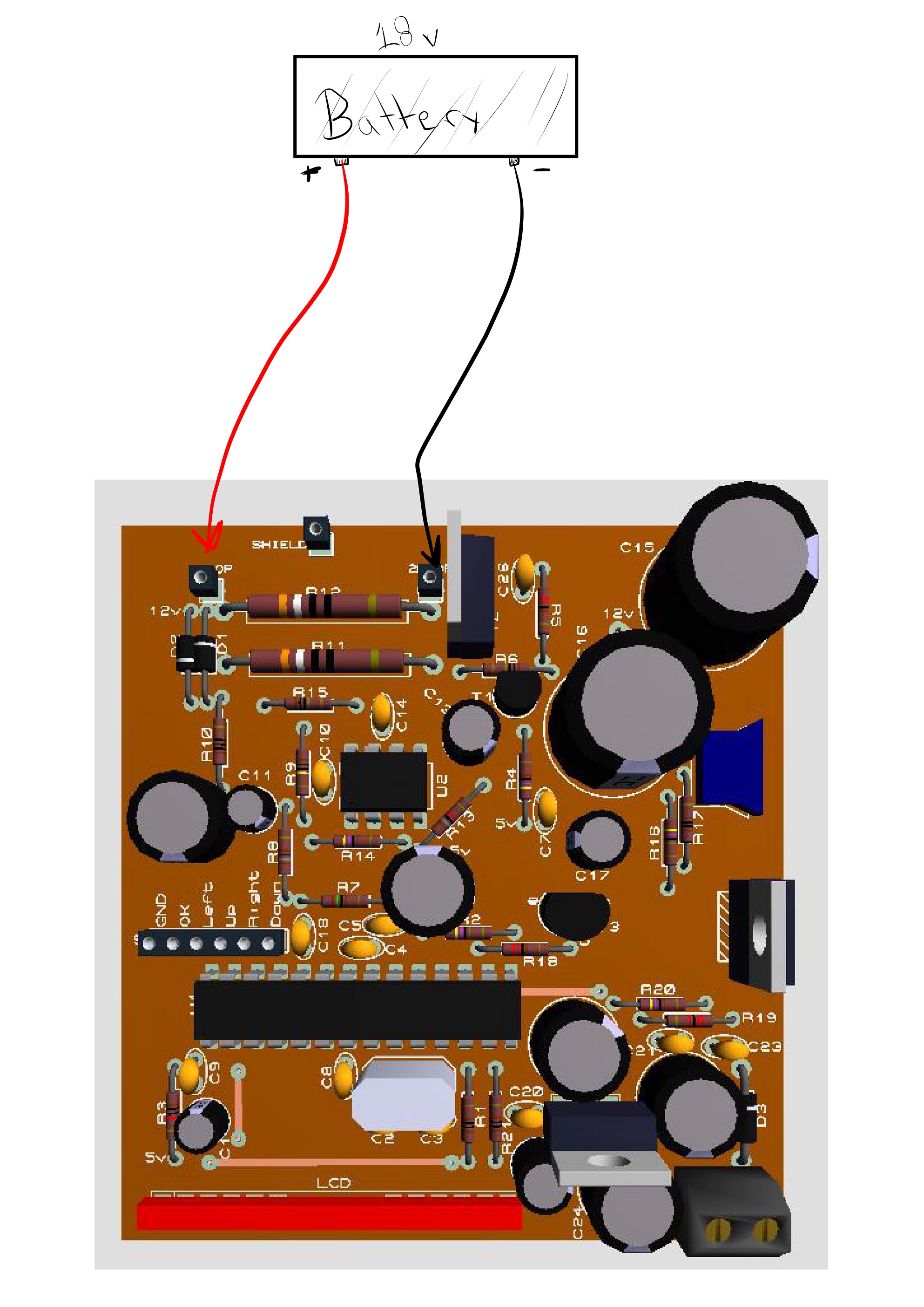

            • error
              I have a question.
              sorry for looking like a fool but an error connect power where the coil is connected.
              my question is if you have already made solution or lose if so to return to start.
              else that you think are burned with the ATmega328 chip, lf357n, IRF840 or voltage regulators mean L7812 and L7805 to me, I might advise.
              I'll upload a picture.
              Thanks in advance.Click image for larger version

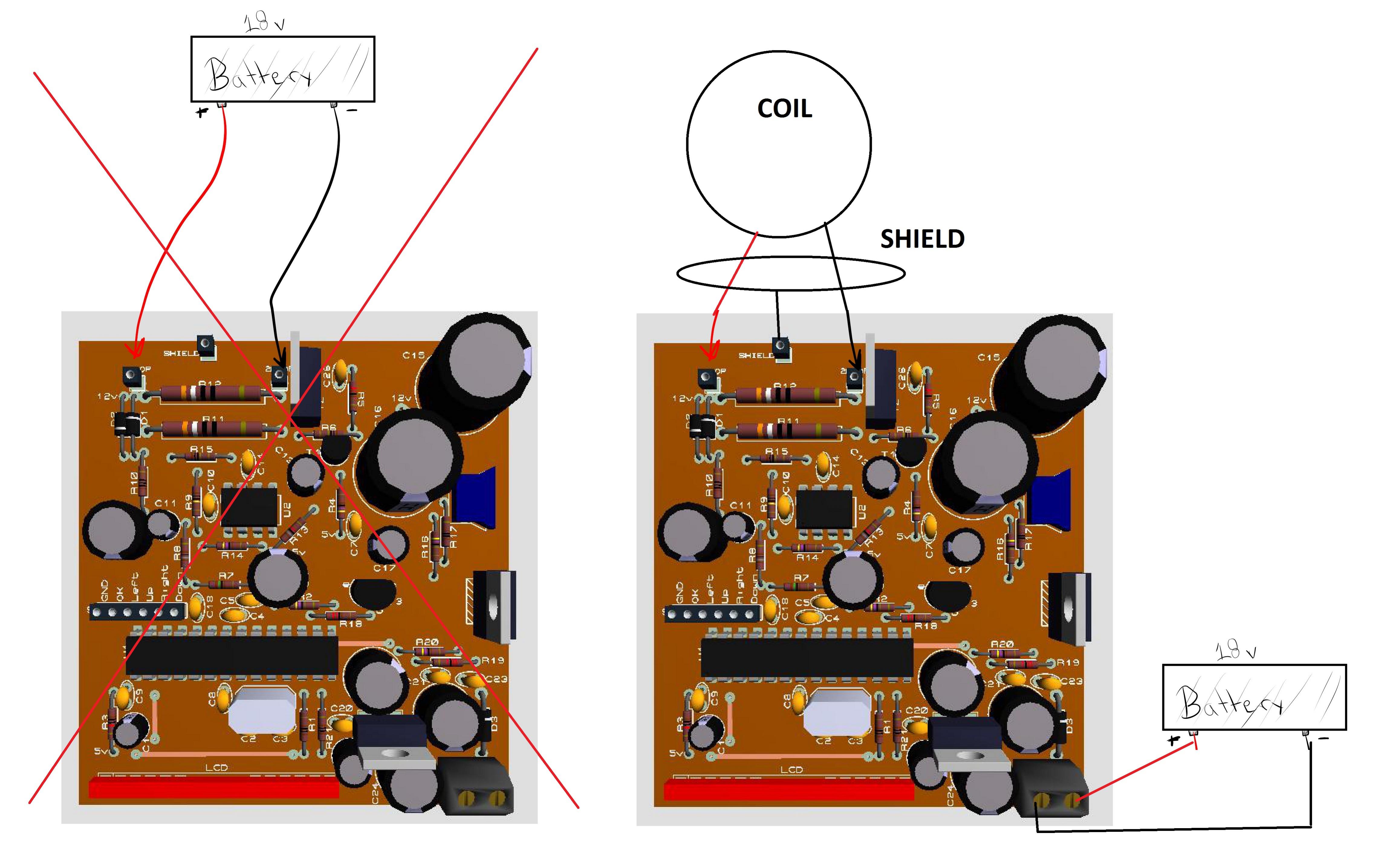

              • Good wiring :
                • therefore I said that was a mistake.
                  and check the L78012 and some diodes and a capacitor and it seems the IRF840 is burned, but the question is whether already been made to lose all the work, since I have no special instrument to make measurements.
                  and not ATMEGA328 state and LF357n ..
                  I repeat it was my mistake and I admit something silly.
