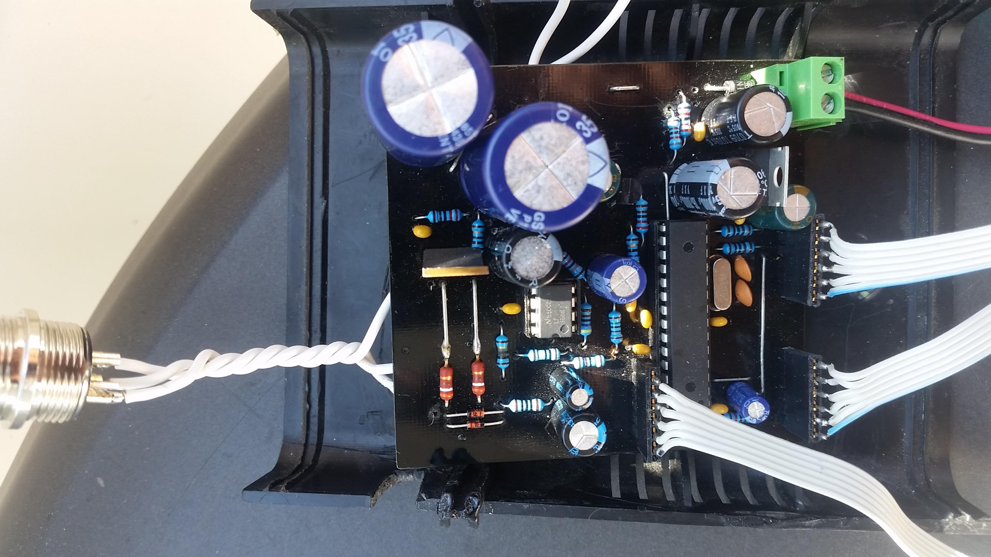

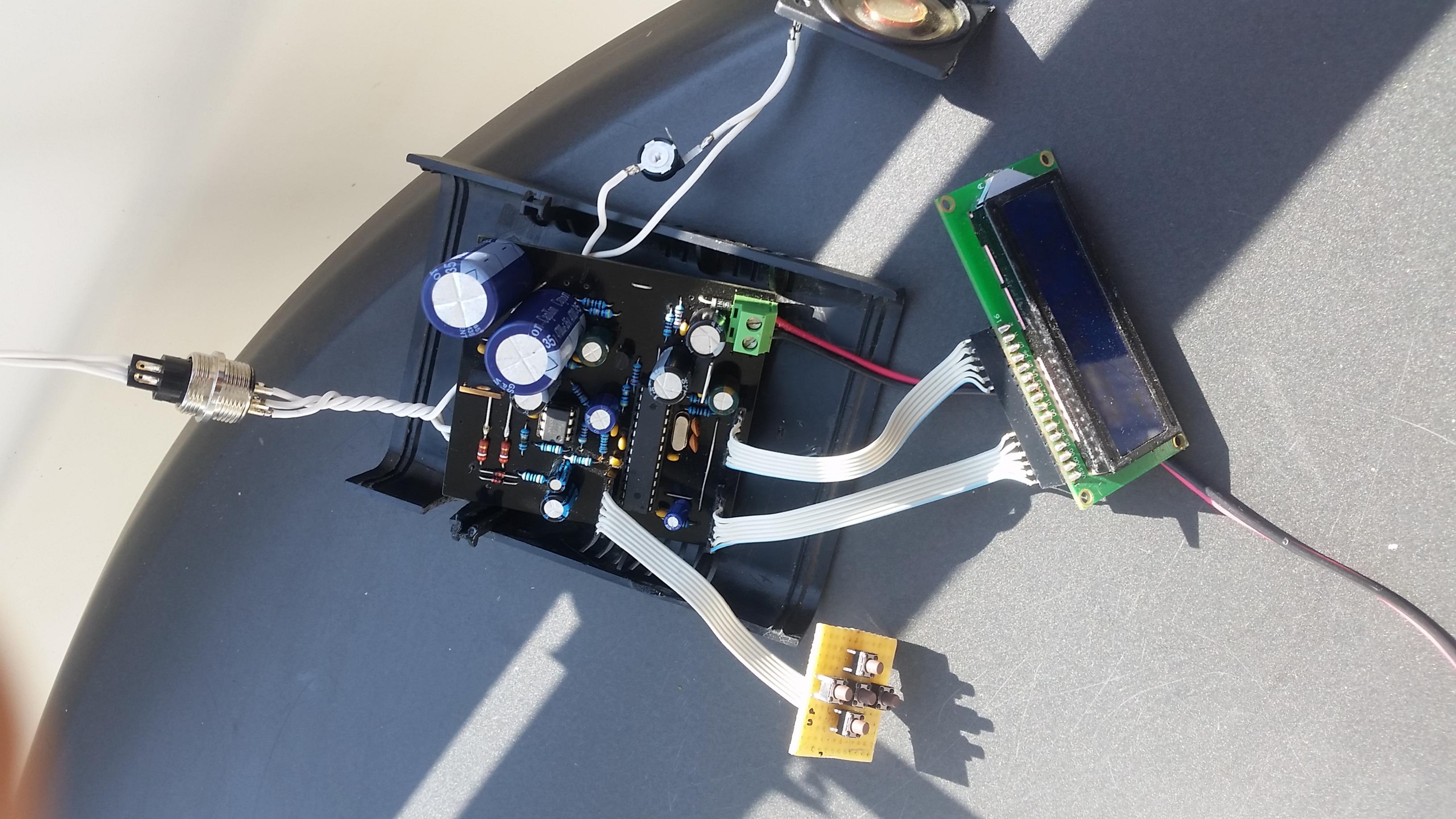

        • #94
          I had the chance to test FelezJoo PI today, It's not polished don't mind the ugly cables there it was quick and dirty soldering as I was impatient to see if the board will become a BBQ but at least nothing's fried. No keybaord, no speaker and no coil at this time ( the device knows there's not coil connected) and shows warning.
          I will test it with a 38cm coil around 380-400mH / 1 Ohm in a few days when I get the time.
          I've connected 12V battery directly (bridged the 7812 IN/OUT) for now, it would be nice if the device has an option to set lowest battery voltage mark.
          I've ordered very low dropout regulator in order to work with 4x3.7V but If I don't get the option to set low voltage warning it will suck.

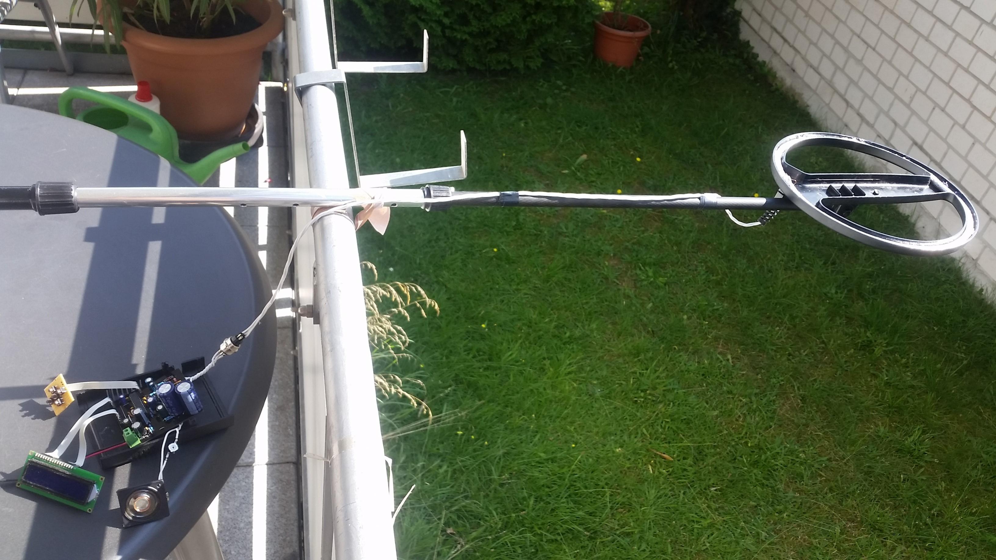

            • #96
              Hello eclipse, nice to have another forum member finished this detector. I use an acid lead battery and increased R20. Now the detector shows a higher voltage. This is not elegant but works, hehe.

                  • #99
                    Here are some pics:Click image for larger version
