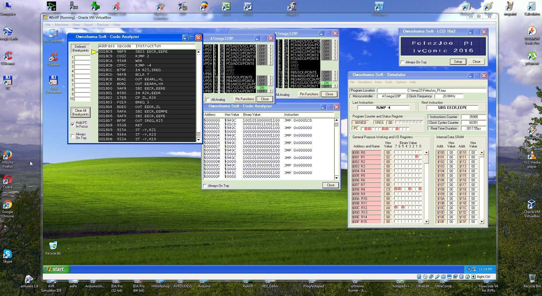

                    I am play some with AVR Simulator (same as Owosuma) trying to simulate and study felezjoo coding. I have seen the hint you posted some time ago (attached jpeg) and I wonder how you have set the virtual LCD to work.
                    I tried some LCD setting and confirm it but when start simulation nothing happen on virtual LCD!
                    An help shall be appreciated!
                    • Forget that simulator and learn Proteus.

                        • As ivconic suggested Proteus is the best tool for changing the code.
                          It is very easy to find the command than increase the counter variable
                          stored in microprocessor's eeprom and change the hex using a hex editor
                          with nop command.
