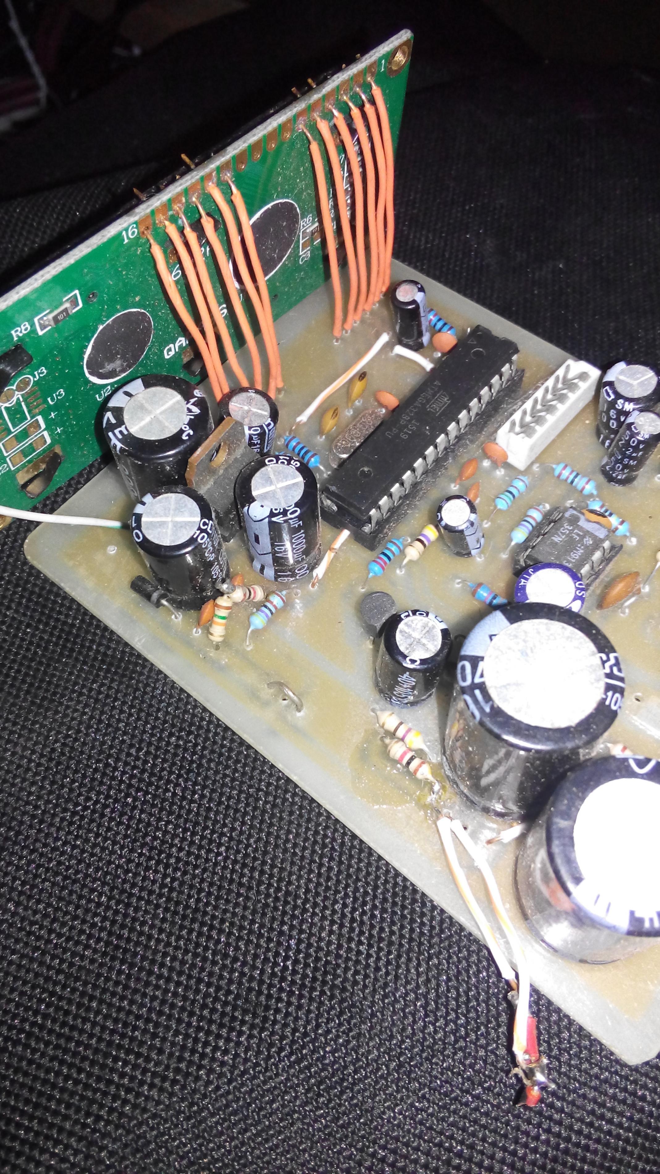

                  • Anyone know why my Mc7812CT+heatsink is hot? Cant touch it more than 2 sec.
                    Using 3xLi-ion+step up to 18v
                    • Hi,
                      Your 7812 drains too much current.
                      It's made for 1A.
                      If the resistance between +12 and GND is less than 12ohms, the 7812 will not work for long.
                      Check for shortcut on the +12v line.
                      • Originally posted by ripsdevala View Post
                        Its better to remove your ste up converter and used only the 3x3.7 lit-ion battery then remove the 7812 regulator.. mine works perfect without it.
                        • Beware also those fairchild regulator and mosfet they will become very hot compare to expensive one.
                          • Originally posted by reptooyep View Post
                            It's made for 1A.
                            No short at all, or my bc337 cause it, i reverse the orientation following the the legs CBE, mine have EBC.
                            Remove and make new connection to 12v track right?
                            Done... Work okay, but noisy, maybe im bellow florecent lamp

                              • You need to change the value of R20 to conpensate to the battery monitor.Click image for larger version
