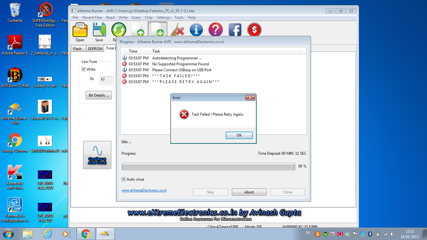

      I have usb isp adapter .i can't burn atmega328 with it
      what should I do
      please help me
      thank youClick image for larger version

        • Originally posted by pigeon View Post
          hi all friend
          what should I do
          please help me
          thank you[ATTACH]38545[/ATTACH]
Name:	Sans titre.png
              [ATTACH]38546[/ATTACH]
              Your usbasp is not recognized, are you already install the driver?
              • thank you
                i have USBisp not usbasp/Is what they are the same
                i haven't driver Where can I find
                • Firmware files and drivers for older AVR/Atmel Studio and/or Arduino/AVRDUDE
                  https://www.olimex.com/Products/AVR/...owsDrivers.zip
                  Recommended drivers for Windows 10
                  https://www.olimex.com/Products/AVR/...AS-6-7-W10.zip
                  Source
                  • https://youtu.be/ZeJ7qDxvIKA
                    • Try this driver, if this fail you need chinese driver to work like my usbasp
                      http://www.fischl.de/usbasp/usbasp.2011-05-28.tar.gz

                        hi thank you allfriend for help.
                        the usbisp not work
